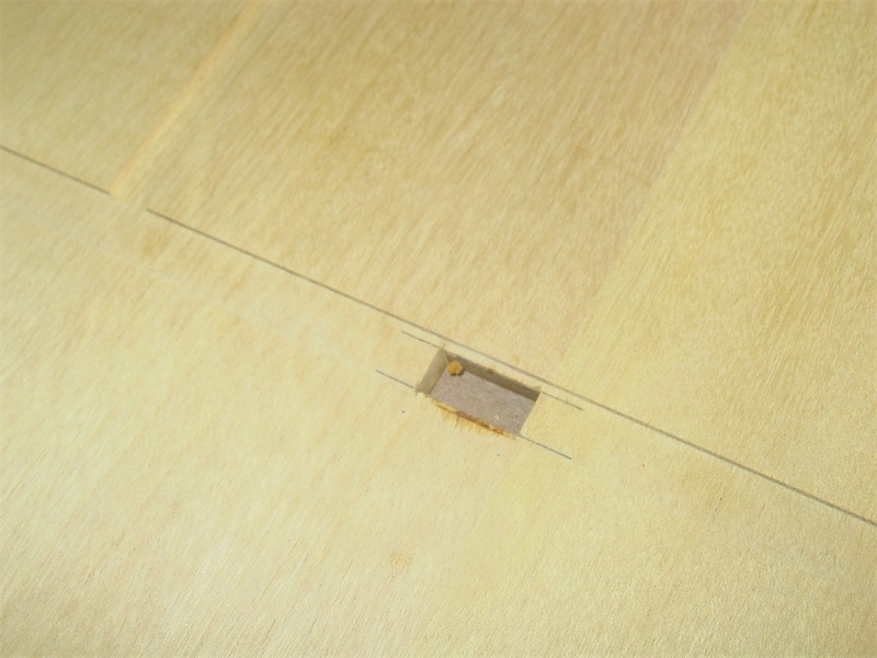

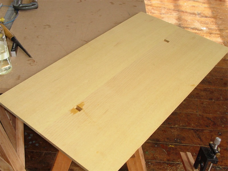

With the changes made to the floor pan of the tool box in order to accommodate some new trays, I need to add some shallow dadoes to the floor panel. These are 0.0625" deep and 0.375" wide. You'll have to look closely at the photo to see them, but they're there!:
I also prepared the stock which will be fitted into these new dadoes, and I chose Pau Amarella for that. See the 'What goes in the Box' thread for illustration of the center trays and support pieces.

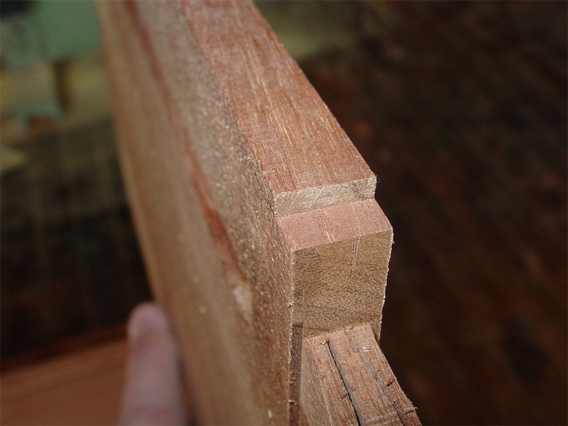

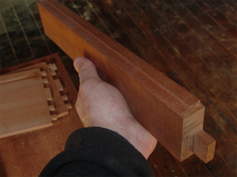

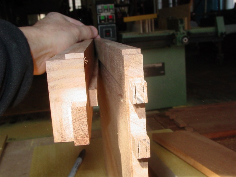

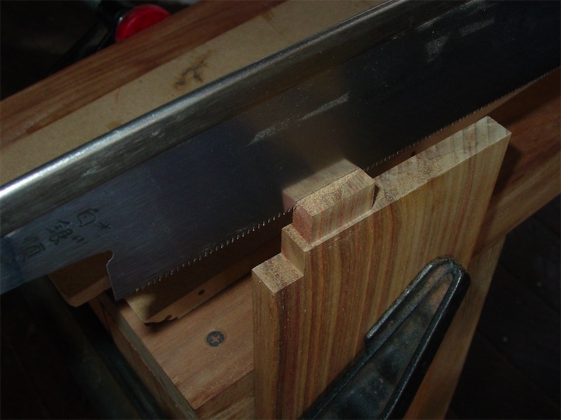

I finished off the work on the handles to define their tongues, both on the back side and top edge:
The fit between the handles rear tongue and the end board's dado is a light interference fit - for the time being I'll hold off on putting them together, but this photo gives a good idea of how the parts will associate:
This picture above shows clearly how the tongue on the top edge of the handle attaches alongside the top edge of the end board, and purpose of removing the nib from the end board top edge ends should now be clear. The handle's top edge tongue and the top edge of the end board when put together form a large tongue which will fit into a recess on the cap piece.

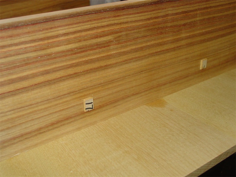

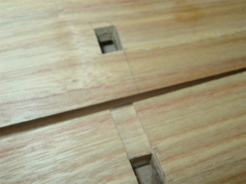

The main partitions will attach to the floor panel using some wedged floating keys, and I took care of the two mortises for this:

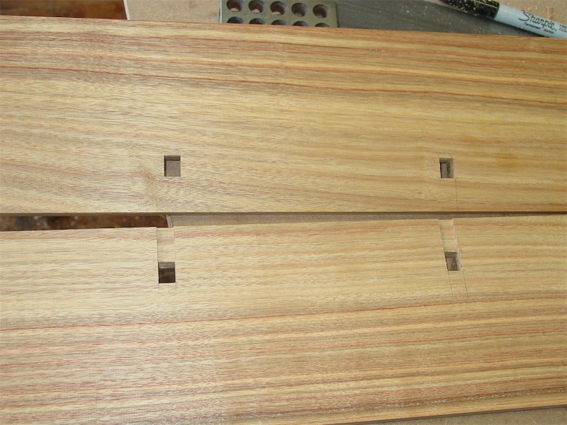

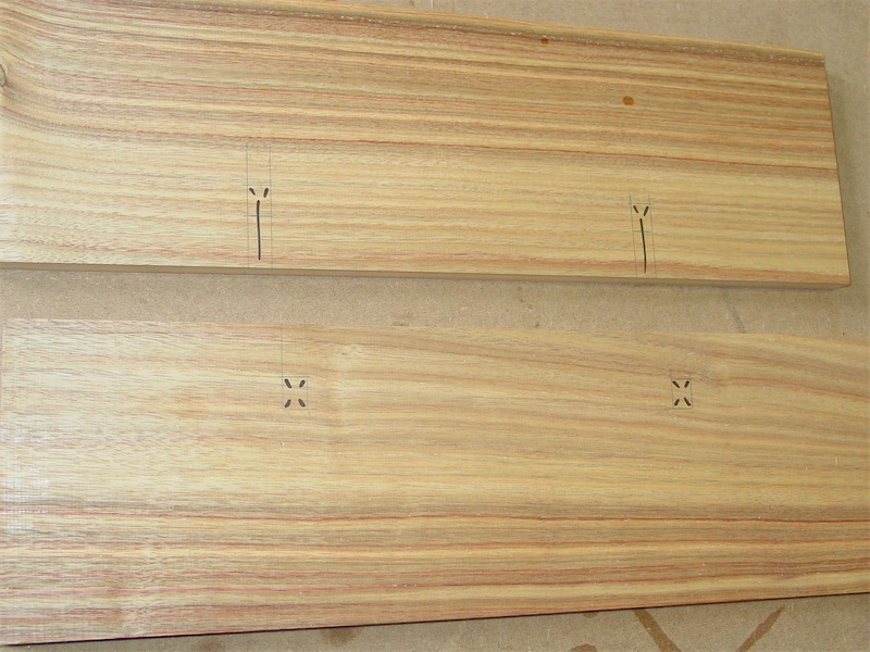

I decided to ditch the light mahogany partitions and go with some material a little lighter in color and denser. I would have preferred Pau Amarello, however I had no adequately wide pieces left. I found some quartersawn pieces of Canary Wood on the shelf however and decided they would do just fine. So, time to make the interior partitions, round two. With the added trays in the middle of the box, I changed the cut-out sequence slightly, this time beginning with the housed mortises for the bottom tray support pieces.

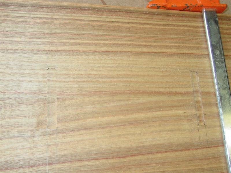

Laid out and both boards clamped together in preparation for routing:
A bit of routing later:

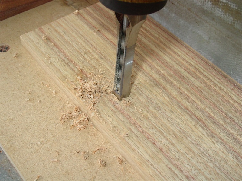

Then I went over to the hollow chisel mortiser to deal with the holes:
Done - one board is facing out, one facing in:
A closer look:

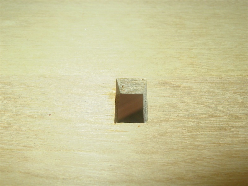

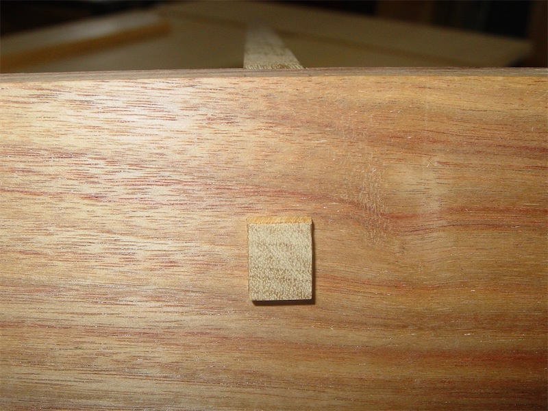

These mortises are not flared and the tenons going into them will not be wedged - there's no need for that form of joint as the partitions are constrained from moving by the floor panel dadoes and by the tenoned connections holding the partitions to the long side walls of the box.

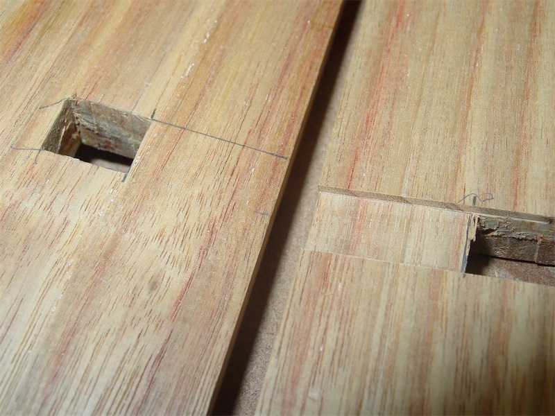

The mortises could use a little paring yet, but I'll save that for the fitting stage:

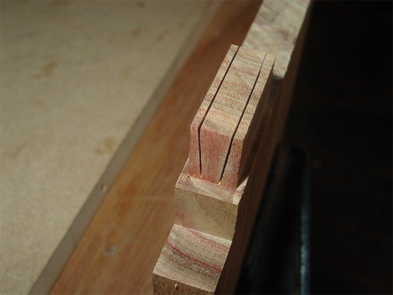

Then I processed the tenons on each end, and with that complete, I could saw kerfs into the tenons:
One done, three to go:

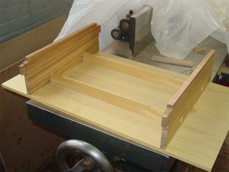

So, the floor pan is done, and the partitions are done. I have the lengthwise tray support stock pieces prepared, but haven't begun cutting them out yet. Here's how the parts relate to one another in case you're feeling a little lost:
I'll start a separate thread for the tray builds, as that aspect is somewhat outside the project scope. Maybe you'll build trays like me, and maybe you will decide on something different altogether.

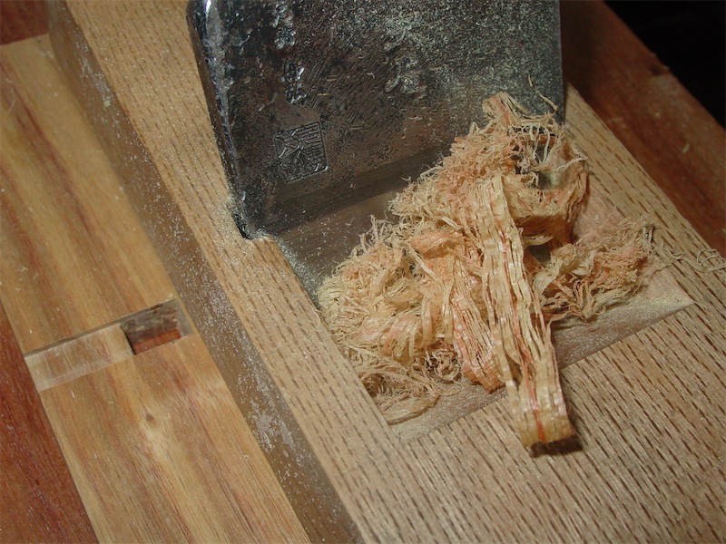

The new Canary wood partitions needed a finish planing:
Lots of pretty shavings off of this wood!:

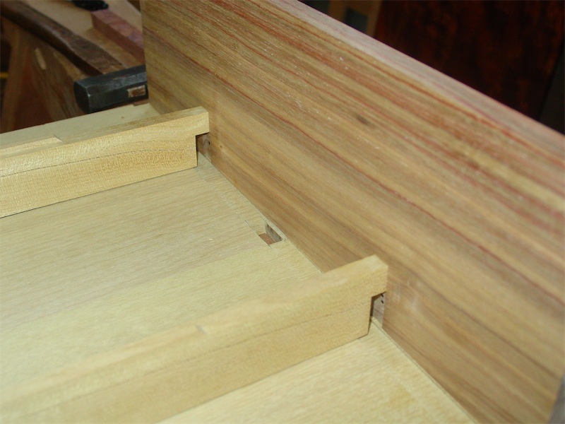

The tray support pieces were also planed, and I then cleaned out the partition mortises and decided to do a fitting:
Seemed to come out okay:

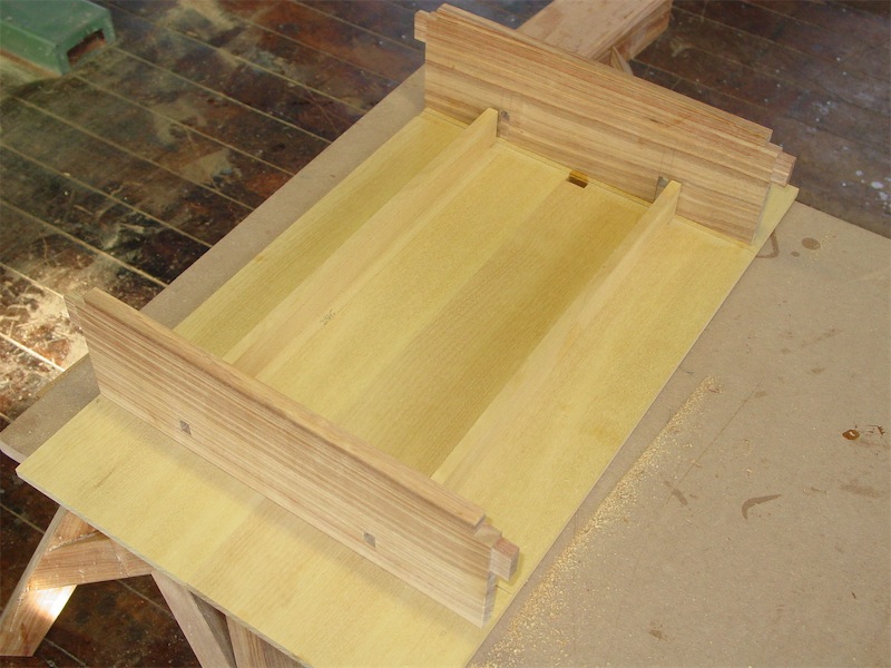

With the partition and support piece assembly together, I could check how it fit onto the floor panel:
That all went fine:
The two tray support pieces in Pau Amarello are a slightly loose fit in the respective floor panel grooves to allow for a slight amount of seasonal movement. We are just coming out of the dry time of year so I am anticipating some swelling in the floor panel as we move into summer, though it should be fairly modest given the VG grain orientation in the panel.
I only need to check the fit of the partitions into the toolbox long sides and the guts of the toolbox are basically complete. There are still two mortises to do in the partitions. I'll show that work in the next posting.
I've been wondering about this step, especially for us hand tool Luddites. I can see that this would be easy on a routing table; how would you go about it using only hand tools? Mostly sawing to establish the sides of the tongues and the new tops of the handle?
Wed Mar 14, 2012 8:59 am
Tim,
actually, there are some tricks to doing it on the router table to obtain an accurate result and it would be easy otherwise to make a mess of it in a hurry. The obvious ways to do it are not always the best way. I think that's why a lot of people shy away from routers - they have had something go wrong in a hurry while using one.
By hand, you would be rip sawing to define the tongue (or chopping and paring with a chisel), then using a corner plane, filister rebating plane, or shoulder plane to dress the surrounding surfaces to the line. Possibly a router plane could be employed if a pair of supports were made up around the handle.

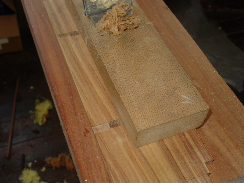

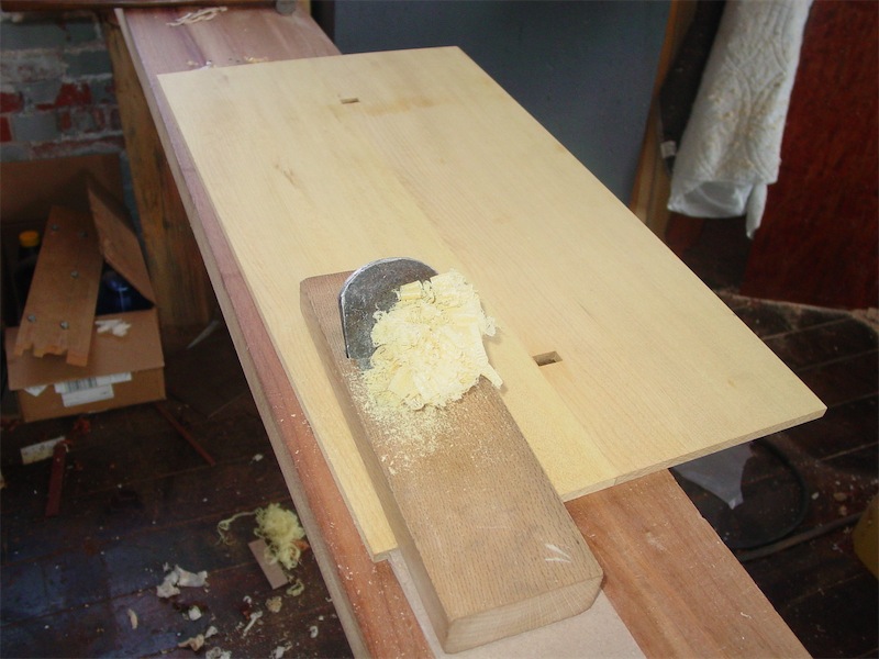

Wed Mar 14, 2012 5:53 pm

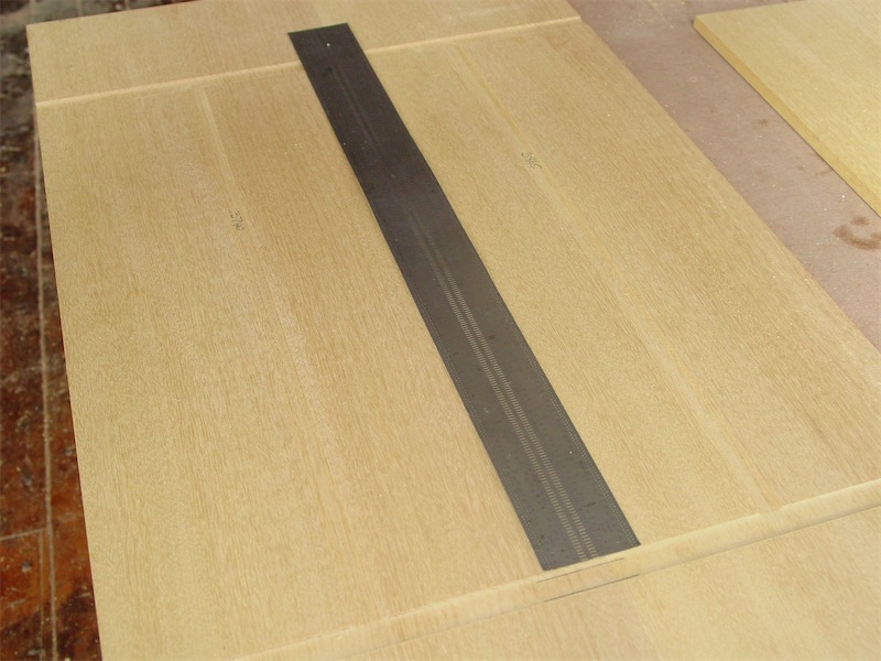

Managed to get my floor panel planed today:

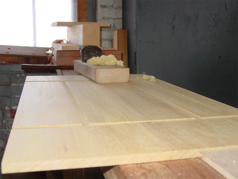

I used to have problems with tear out on Pau Amarello sometimes, but not with this plane:
i find it planes up nice and shiny. Too bad most of it will be covered with tools and stuff!
