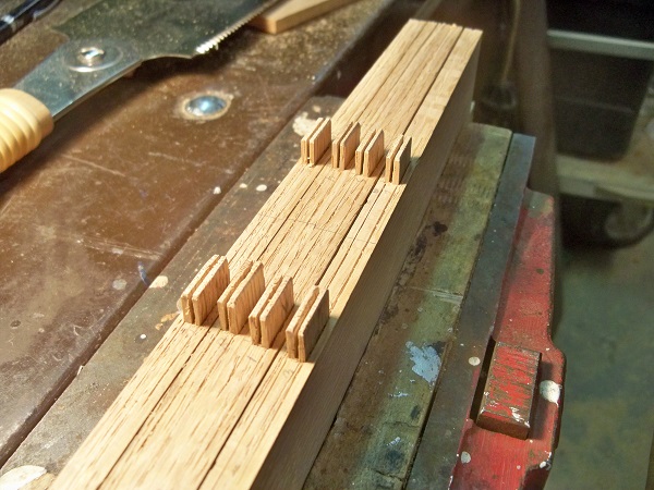

In between projects, the toolbox is progressing.

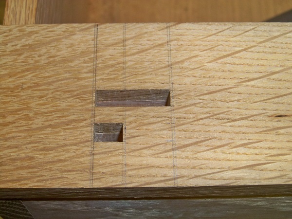

- Cap mortises chopped but not yet tapered for wedges.

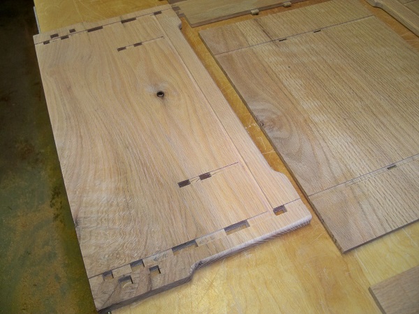

- Marking for captured tenons on caps.

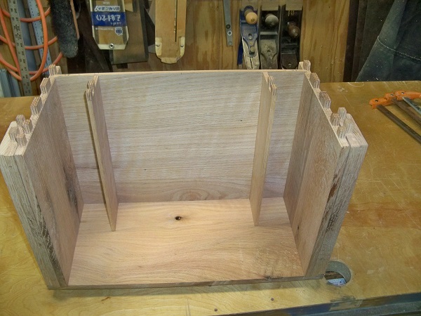

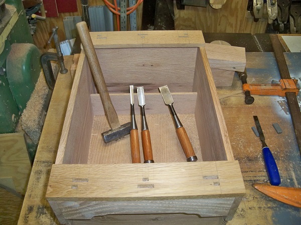

- Test assembly in progress.
- new test 5.jpg (192.25 KiB) Viewed 21147 times

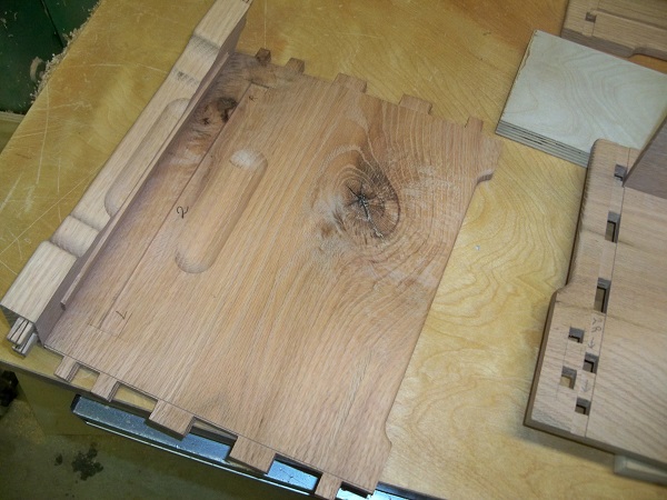

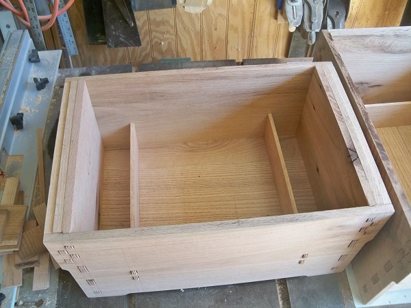

- The dividers/tray supports for both boxes.
- new test 3.jpg (237.16 KiB) Viewed 21147 times
Re: Preliminaries - Milling
Looking good - things feeling more under control now with the wayward white oak?
I like the handle detail.
Some of the boards did cup and I cheated a little by splitting them and regluing along the rejointed cut. Otherwise many would have been unusable for this project. I was able to get a thickness on the sides and ends of just under 1/2". I saw the handle detail on a Japanese site. I love the Japanese sites but I just can't read them. The bing "translation" can be amusing sometimes and it was the first time I heard the term "hell joint" and thought it was a mistranslation. I am having a great time with this project and when finished I will put them along side of the other Japanese style toolboxes I've used for years that are simply nailed together.

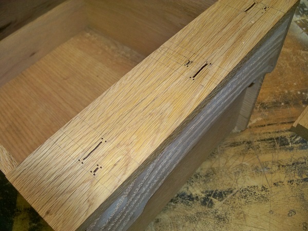

- One of the sides viewed from the inside with the grooves and mortises.

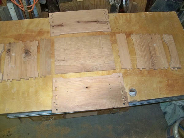

- Parts for one box ready to assemble - minus the wedges.

- Both boxes test fitted and ready for wedges. I thought building two boxes at the same time was almost as easy as building one.
- new test 11.jpg (195.22 KiB) Viewed 21147 times
