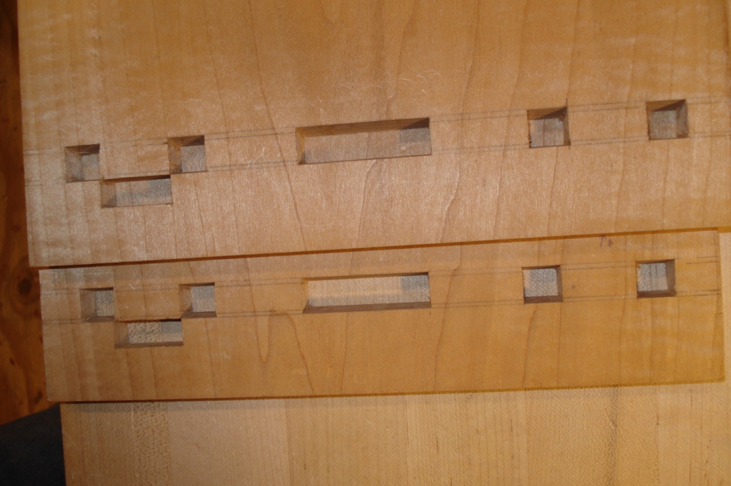

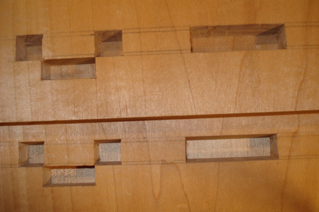

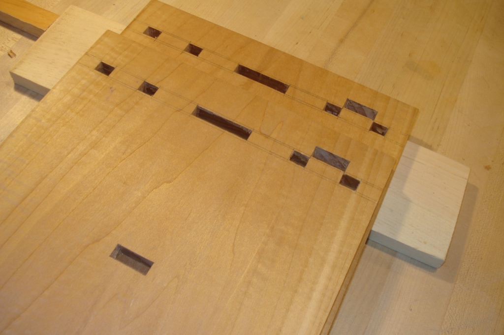

I have gotten a little more progress on my toolbox in the way of mortises.

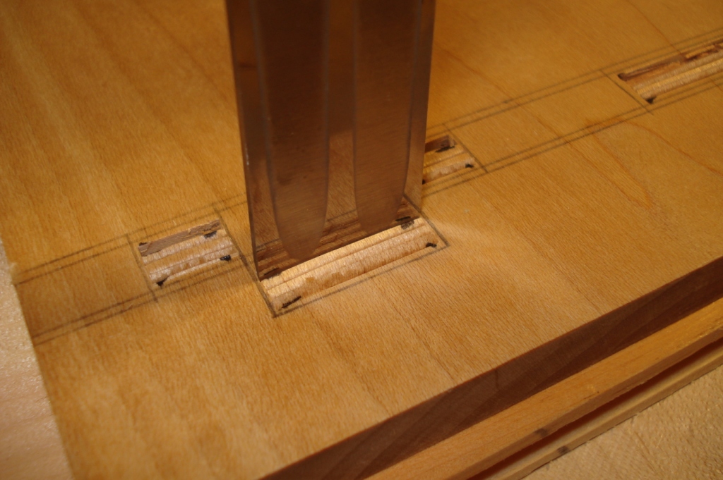

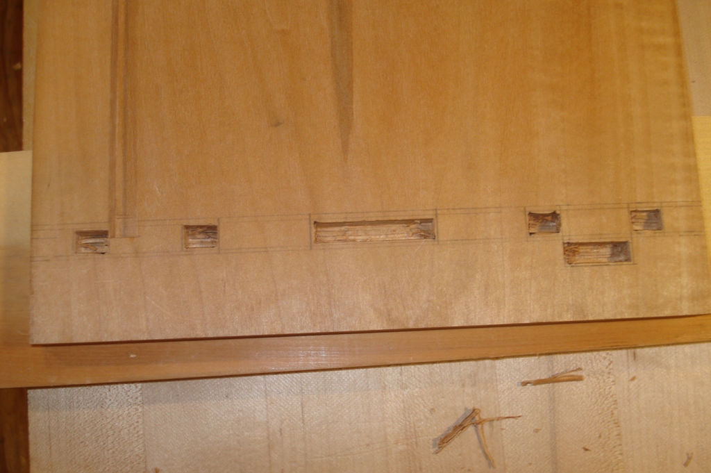

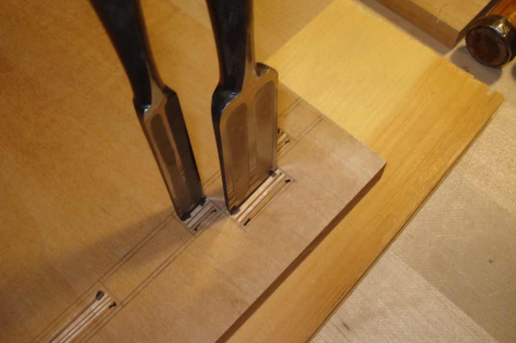

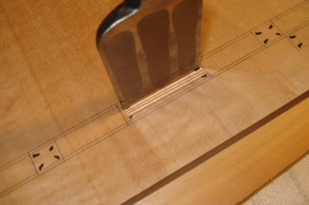

Between the above four photos and the one below, there was quiet a bit that went on of getting the mortises roughed in. What was shown above was chopping straight down on one long side only. The way I proceeded with the remainder of the roughing was to angle in to the middle from both sides until I broke through then pare roughly to size. The next photo shows the mortises pared to size without the taper.
I am proceeding with the divider mortises differently than Chris in that I will fit the long side dadoes from the mortises/tenons, then use the long side dadoes to transfer to the floor.

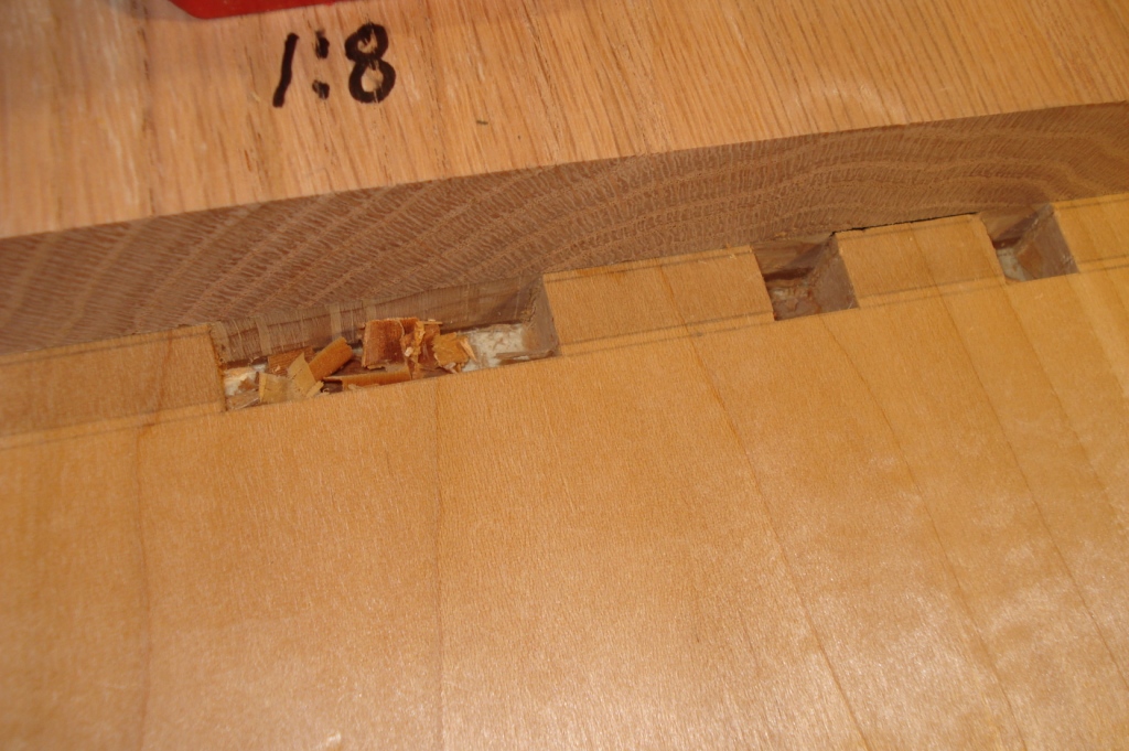

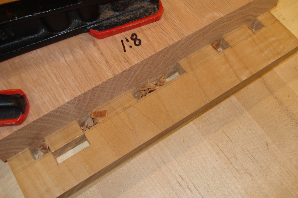

More progress on the long side mortises that will be flared.
