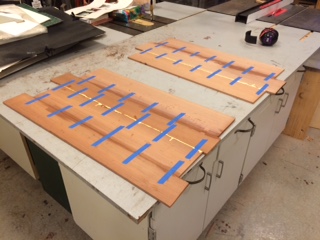

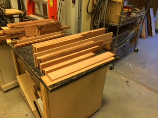

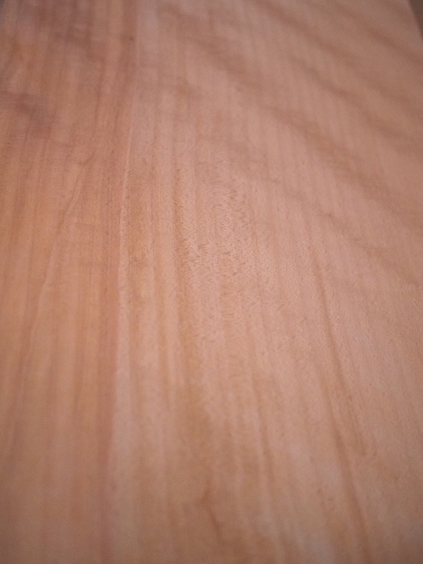

Here are the long boards (with an extra) and the lid and bottom boards.
Group shot:
Lid boards before final planing and glue-up (assuming they stop cupping).
another shot of the lid boards
Long boards
So, the top is a curly maple and the bottom is regular maple and I see why you suggested the growth rings that run parallel/ 45 degrees to the boards length. These started out around 13/16 and I planed them down to .52ish and they have already cupped. Very disappointing but I should've followed directions. I'll take an additional 1/16-1/32 every other day until I see some stability or they may have to just sit this one out.

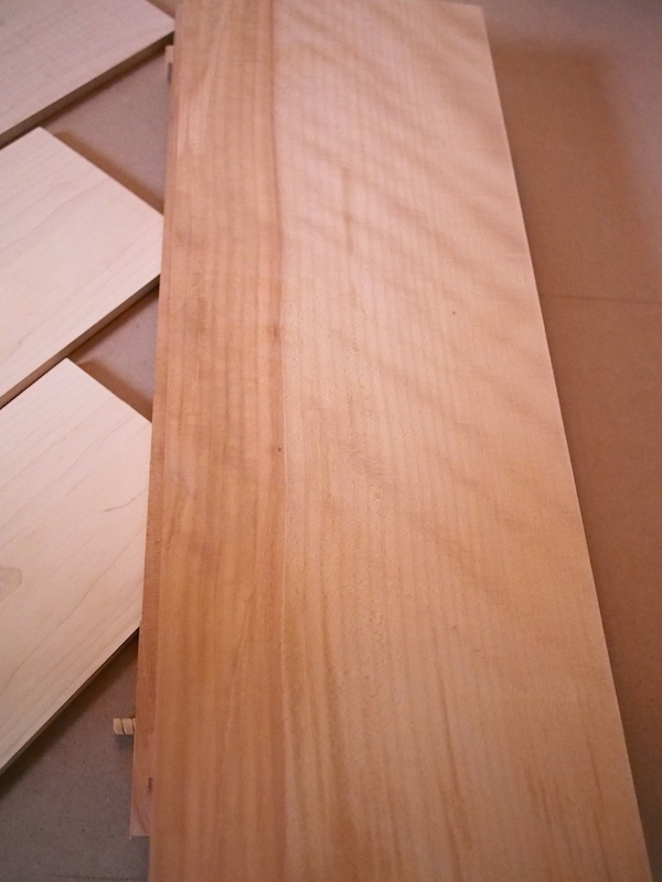

Any one have a guess on the long boards? I purchased these boards nearly 3-4 years ago when I originally thought I'd get into woodworking then I let them sit in a barn. They are remarkably stable and beautiful figure despite having what looks like some sapwood on a 1/3-1/4. At first I thought it was QS sycamore but it has a bit of a red tint to it. I don't recall what it is but it's been stable after cutting to size, although still a bit fat at this point ( ~ .600)

I think I found out what the long boards are: QS sycamore.
http://www.woodworkerssource.com/quarte ... amore.html
Very similar "grain pattern" so I finally know what it is and I really want to buy some more. It's a very nice looking wood, although I don't know how well it will machine/cut. The jointing and planing hasn't been too bad.

I find sycamore a difficult wood to plane cleanly. Sort of wooly grained...

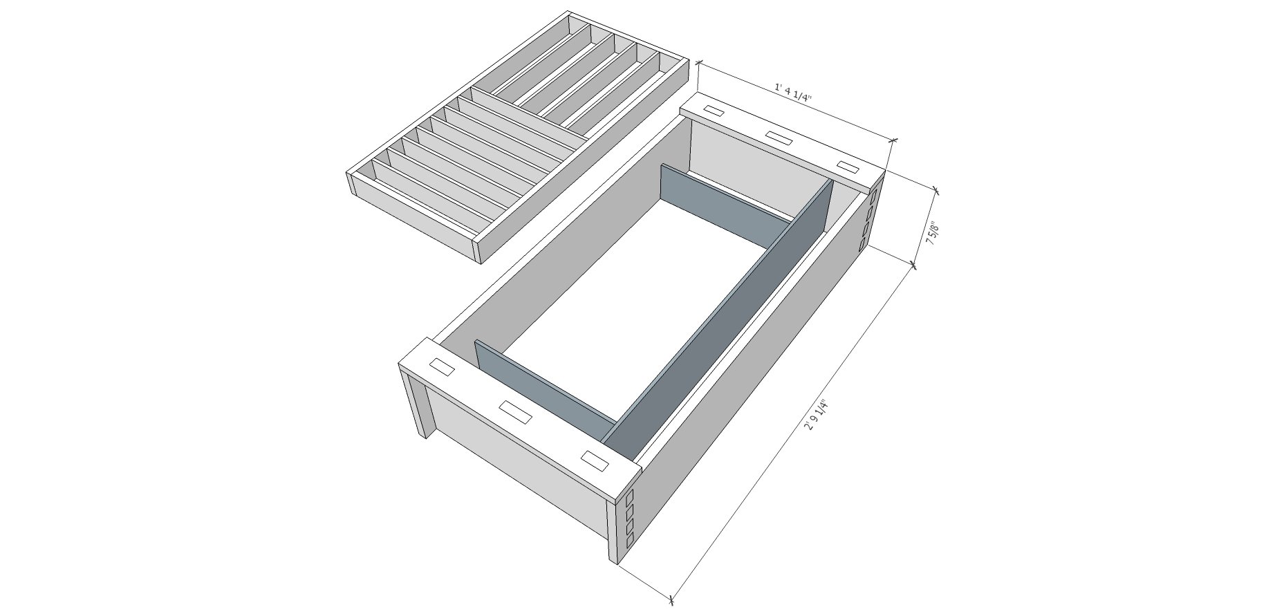

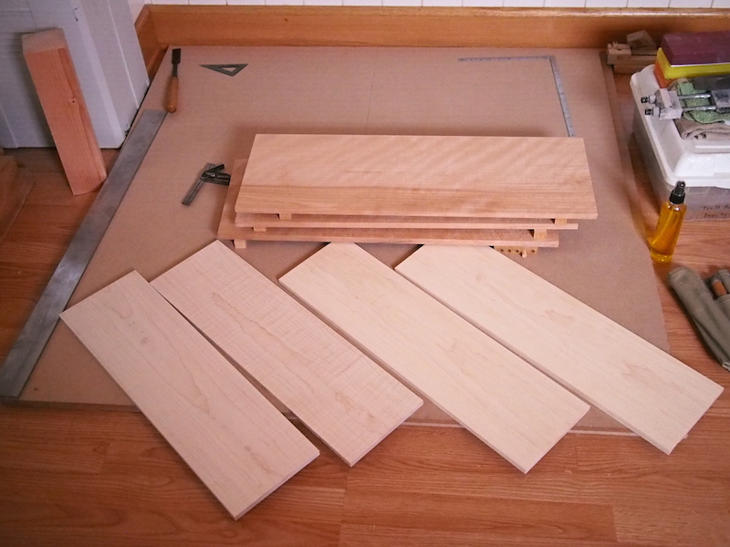

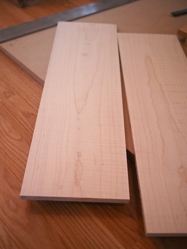

Here is my second post on the box project. I managed to mill most of my lumber to the dimensions I made on google sketch up, accept the height of the side boards will be 6 1/4" tall. Here is a shot of the plan I came up with.
The top and bottom boards were a little over 3/8" thick but had to be glued together. I hope this will be strong enough to carry my tools.
The last picture is the assortment of lumber ready to get the mortise and tenons laid out. More pics to come soon.
