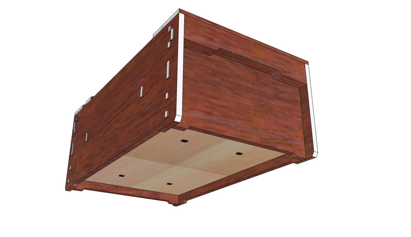

Underside:

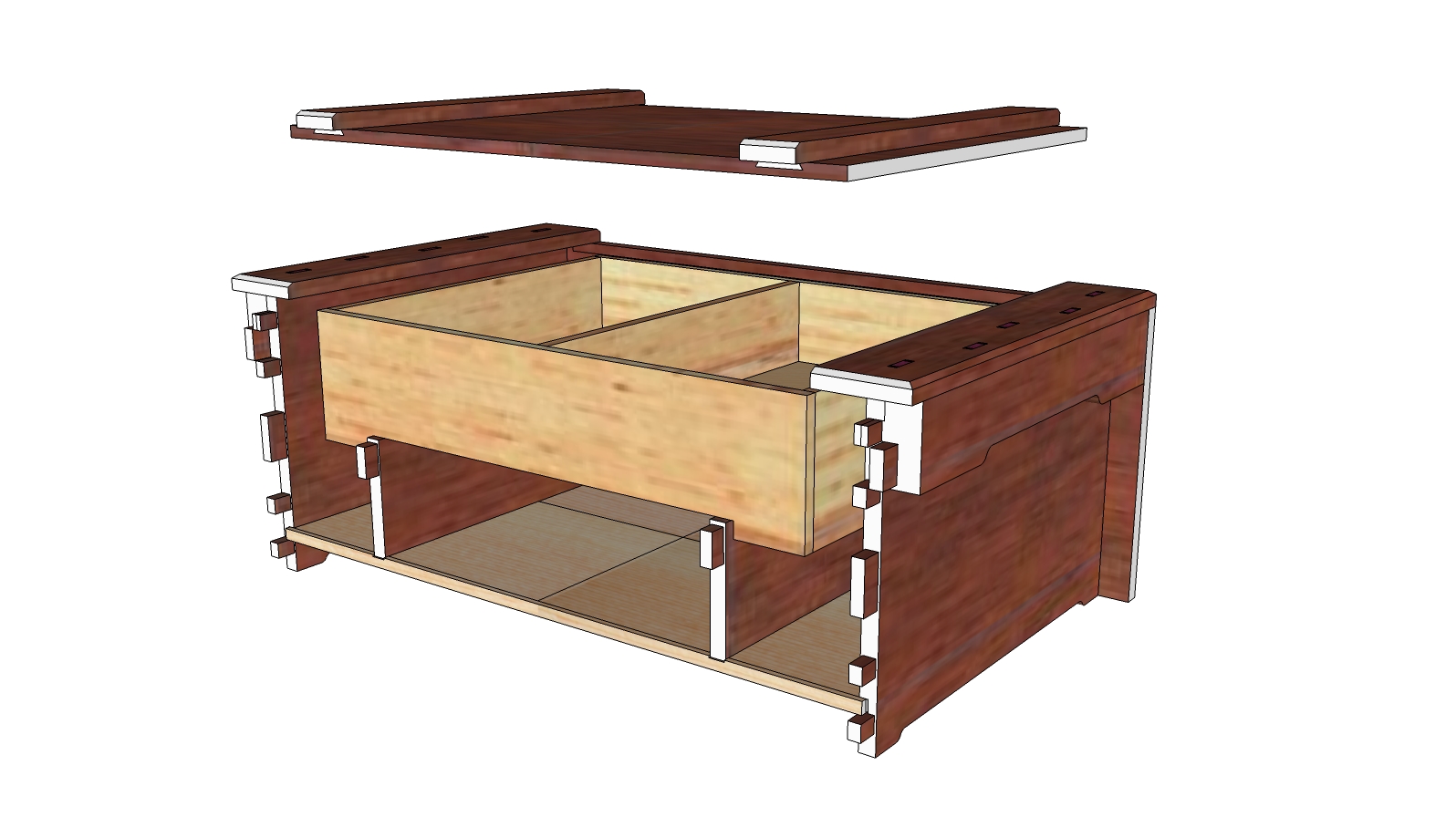

Lid off and interior drawer out:

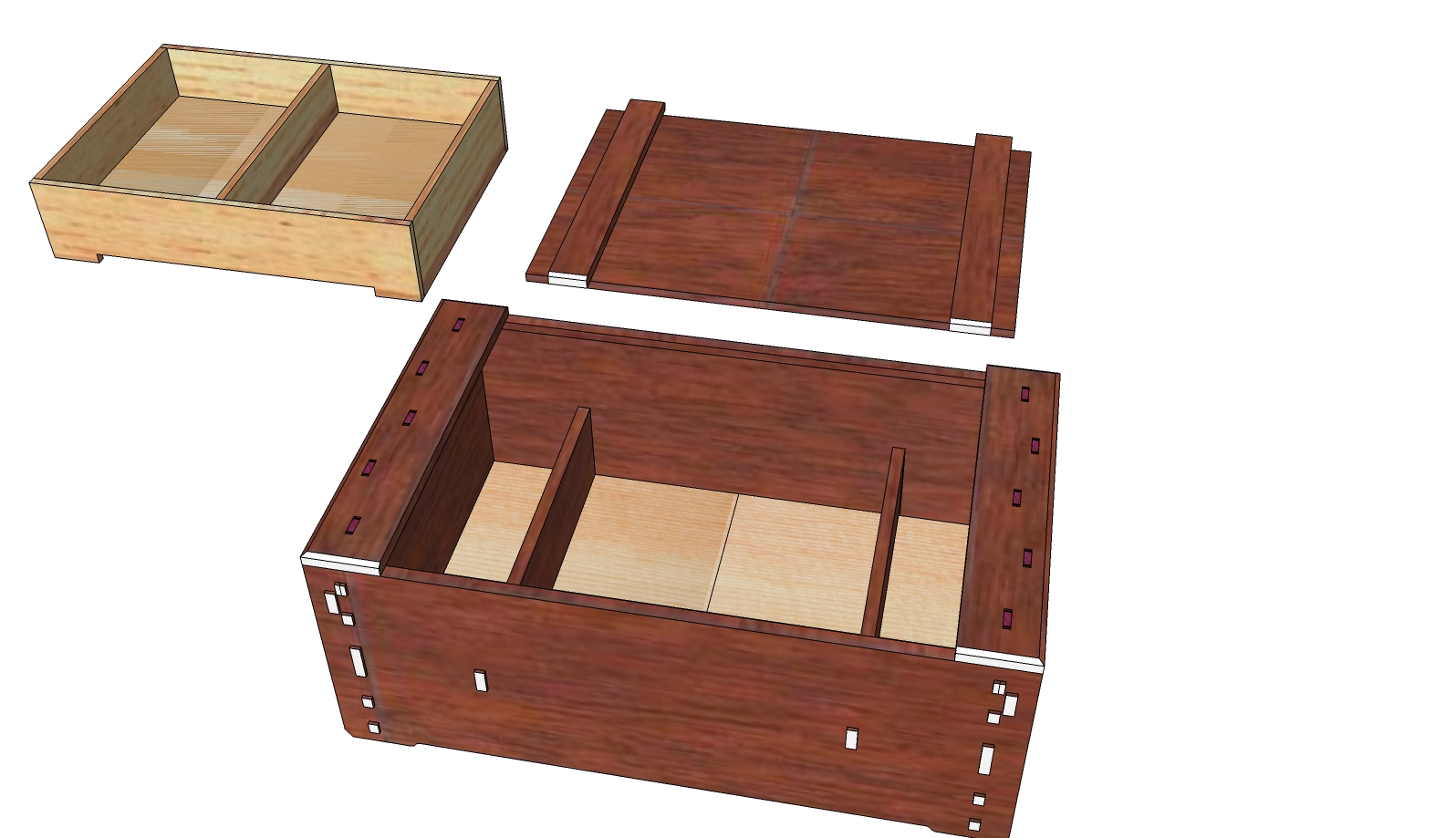

Cutaway view - the configuration of the internals, along with overall dimensions, will be up the individual maker:

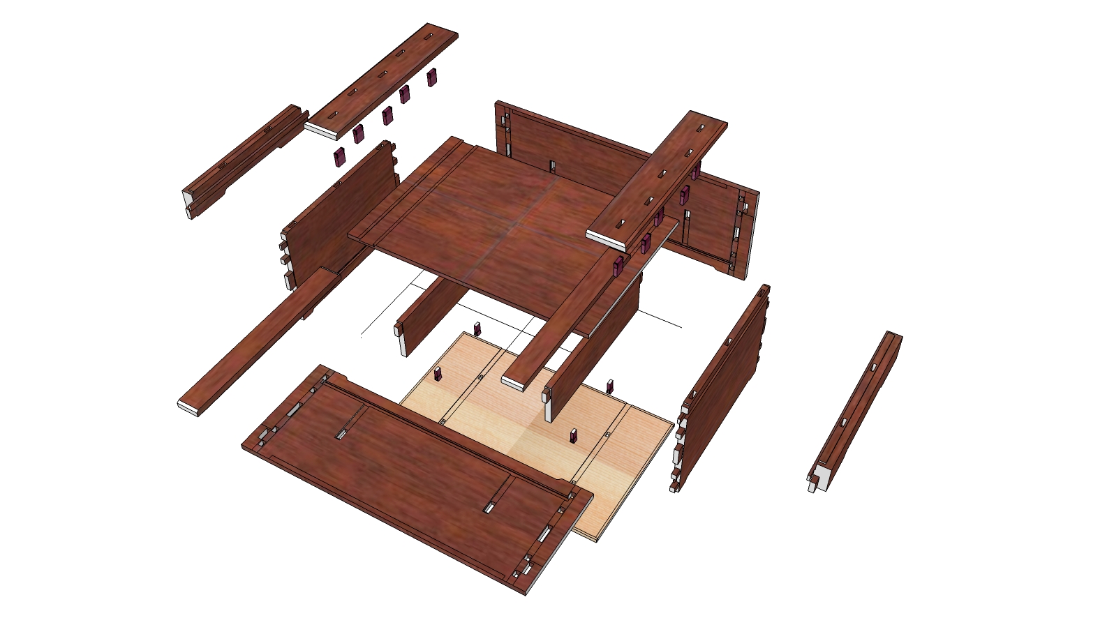

And a couple of exploded views, one from above:

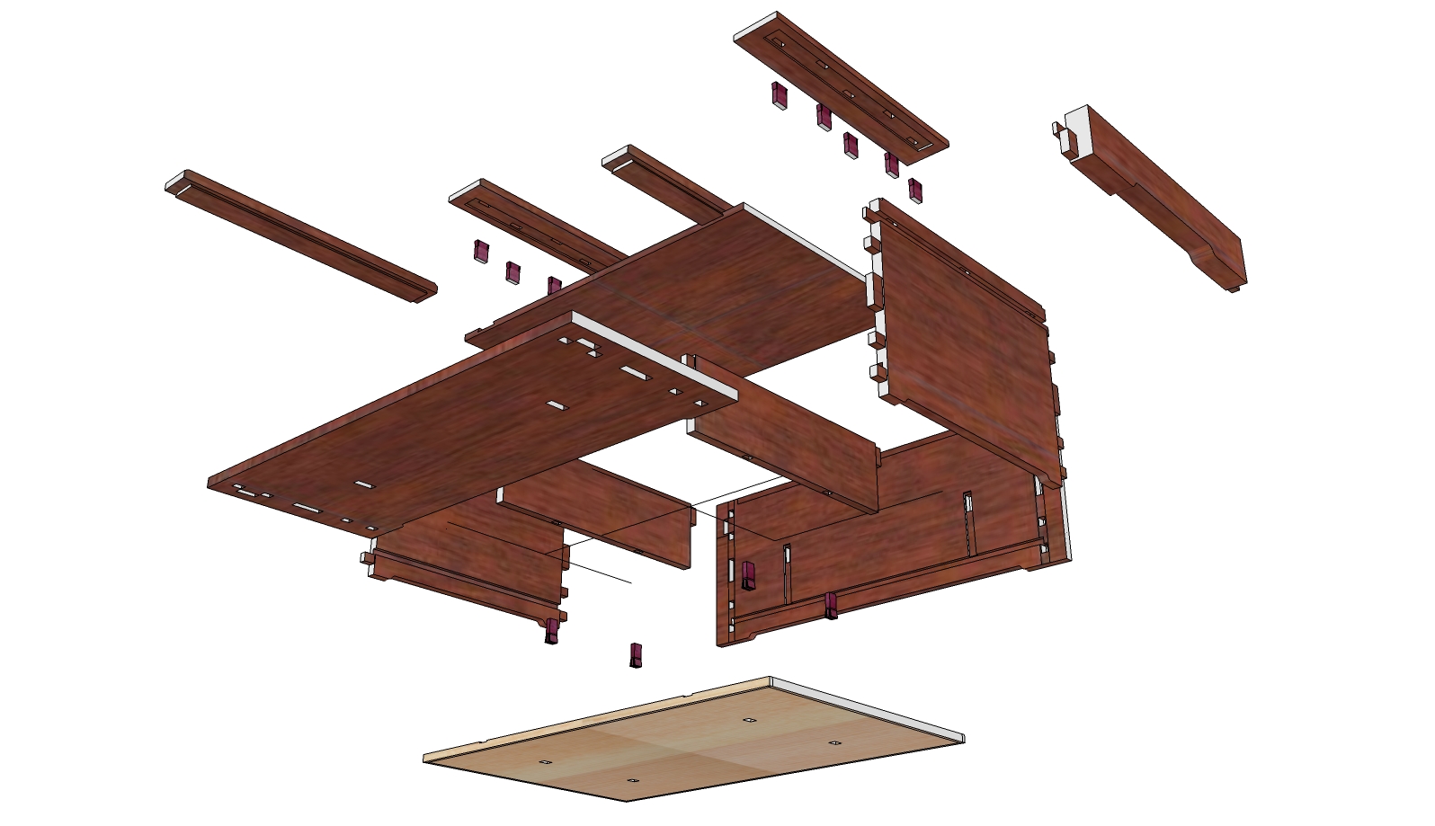

And one from below:

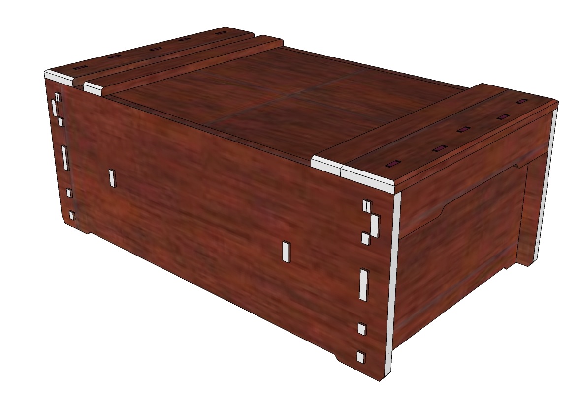

I guess it isn't the most 'basic' starter project, but it is the solution I came up with which allows for exploration of some interesting joinery and a finished box which relies upon that joinery to hold together, rather than glue or metal fasteners.
