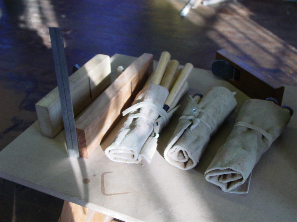

The tool box I am making for myself here will store primarily three chisel rolls, 4~6 hand planes, and some assorted other hand tools like marking gauges, bevel gauges, etc. I am planning this box to be a site used tool box, not a shop-use tool box.
So, the first step for me was to lay some of these tools out and take some measurements of their dimensions so I could plan the tool box proportions accordingly:
Once you have some volumes to work with, you can think about how to nestle them together in the box. You may wish to consider such factors as placing, say, more commonly used tools in the top area of the storage, and infrequently used tools in the bottom. Or not. You may wish to keep planes with planes, and chisels separate, also all together, or fit them in amongst one another, as their dimensions require In my box I have roll of paring chisels, which is quite long, and a jointing plane, also quite long, so I will place those items next to one another. I also envision that my normal way of using this box will be to pull the interior tray out from it and place it to the side so I can get at everything at once.
