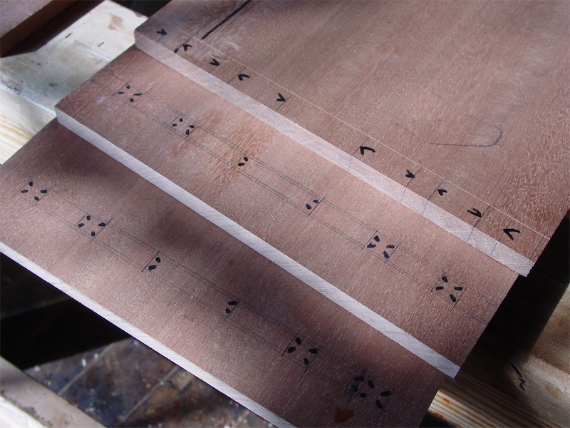

I lay out using a 0.5mm mechanical pencil. I prefer the type with a retractable tip instead of the little fixed metal tube tips. I establish a central axis on the board and lay out to either side from there. I use a try square to extend lines across the faces of the board, always referencing the square off of one edge. To lay out the mortise and tenon side wall lines, i use a combination square and layout out on all four boards, one side line at a time. When done, i use a sharpie marking pen to clearly indicate which side of a line is to be cut and which is not. Then I lay out the dadoes for the floor panel and the handle.
When all of that is done, I have a stack of boards which look like this:

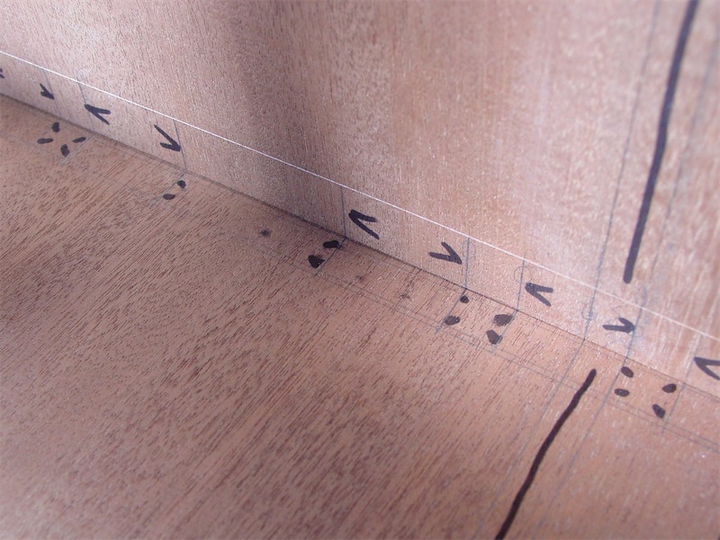

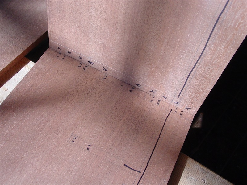

Before proceeding, it is important to lay a pair of connecting boards off against one another to double check that the mortises, tenons, and dadoes are all in logical arrangement:
A little closer look:

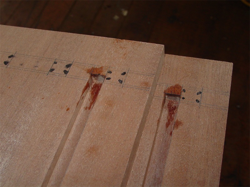

There are various ways to swing the cat here, but i decided to cut the dadoes first, using a small router with edge guide. The first dadoes were 0.375" wide. You might be tempted to chuck up a 0.375" router bit and plow out the groove in one go, but I prefer to use an undersize bit (8mm in this case) and remove most of the groove first, then fine tune the router edge guide until I have the groove cut to the correct width, depth, and position. It takes longer but the result tends to be more certain and cleanly cut.
Here's the first rough cut:

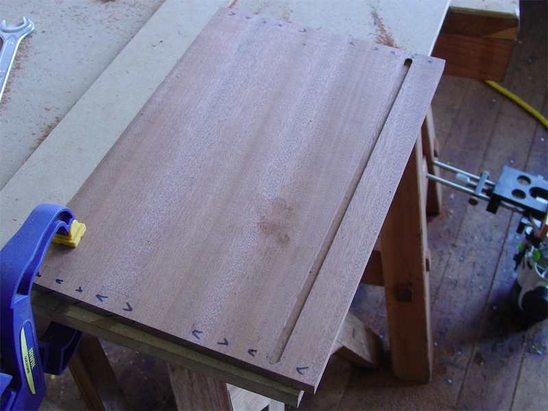

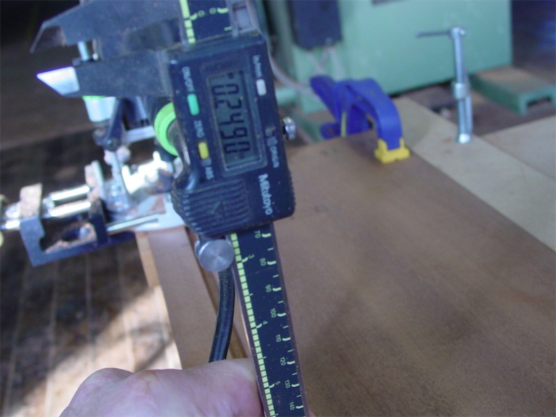

The dado on these end boards can be run right through, but I prefer to just go past the line and keep as much of the router on the wood as I can.

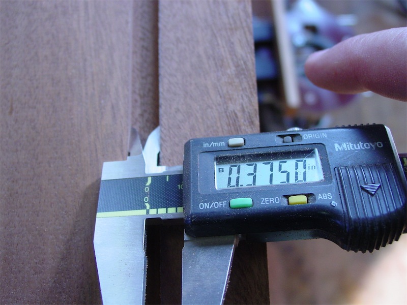

Some adjustments and further cuts later, I am at my target width for the dado:

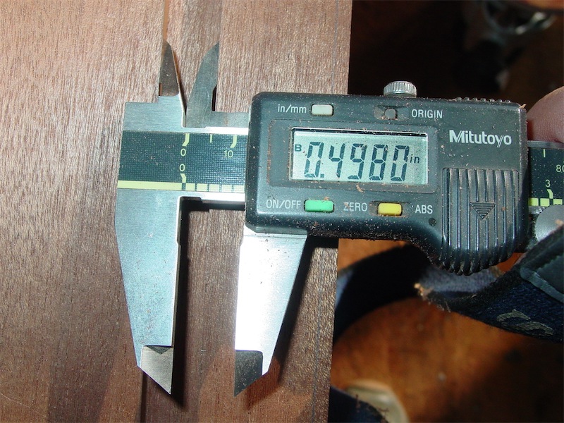

Here's the target depth for this dado - half the thickness of the 0.5" board:

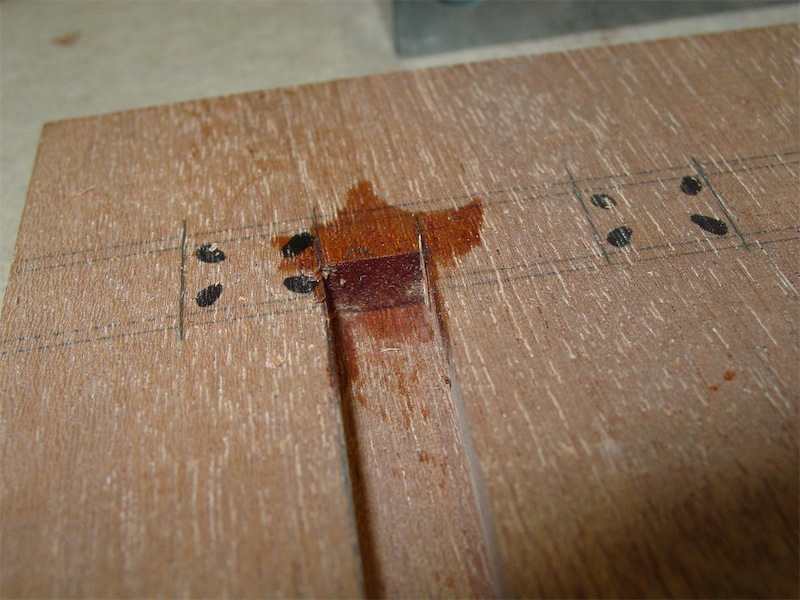

One minor detail - the end boards receive the floor panel end grain ends - there is very little seasonal movement to be expected along that grain direction, so the floor panel can be fitted a little shallower and with leas clearance space. While the side boards have a 0.25" dado depth, and the boards will insert to a depth of 0.1875", leaving 1/16" room on each side for the board to swell, the end boards have a dado of 0.21875" (7/32") for the same 0.1875" (3/16") depth of floor panel insertion, leaving 1/32" space on each end of the board to accommodate movement.

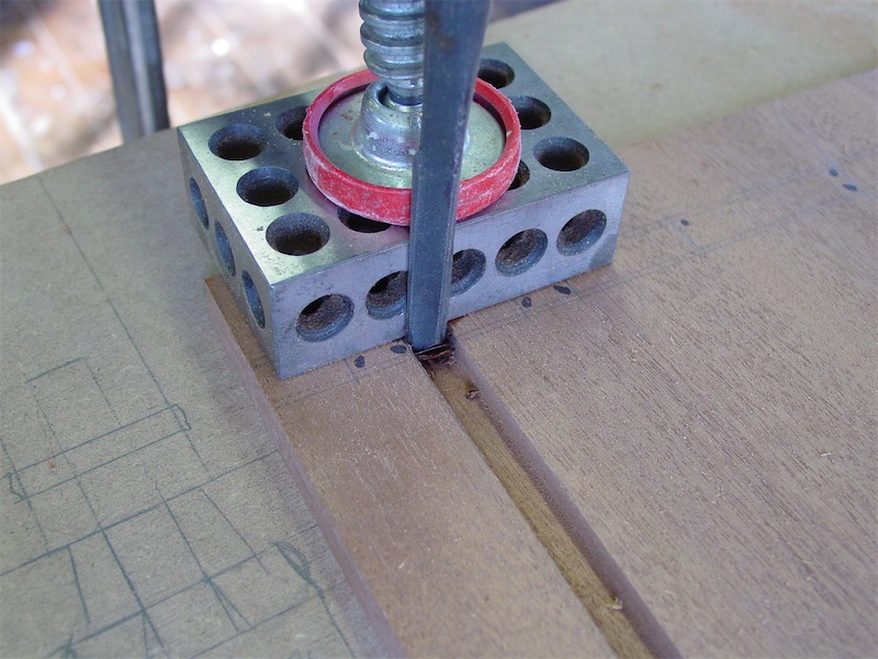

Once the routing was done, I used a paring block and a chisel to clean up the ends of the grooves:
Completed:

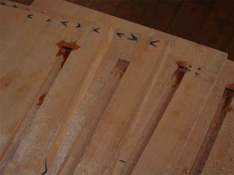

So, the floor panel dadoes complete, I then processed the dadoes for the end handles. These dadoes, which are stopped, are 0.25" deep and 0.5" wide.
And then all four boards were complete for the dadoing work:

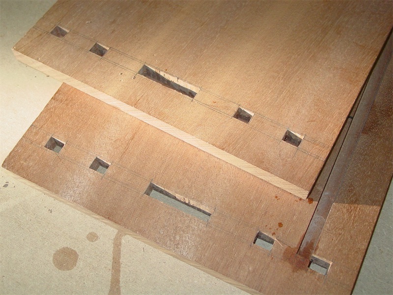

I decided to keep going and used the hollow chisel mortiser and a 3/8" bit to rough cut the mortises in the side panels:
The tenons are 0.375" wide and 0.5" tall - when wedged 1/16" on each side, the finished appearance will be a square 0.5" x 0.5" tenon.

Also, is your "paring block" a machinist's 3-4-5 block, or something sold specifically as a paring block?
Is the mortise cut to .5" wide or .375"? Your dimensioned drawing in the Views thread makes it look like .375", but now I'm not sure.Chris Hall wrote:

The mortise is cut to 0.375" wide, and then will have the opening flared toward the outside. i'll show that step soon enough, but for now, rough cut to 0.375" wide and 0.5" tall, except for the central mortise which is quite a bit taller."Is the mortise cut to .5" wide or .375"?
It is a machinist's 1-2-3 block - in inches.Also, is your "paring block" a machinist's 3-4-5 block
