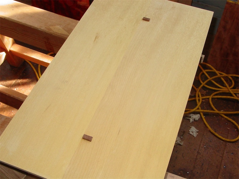

The partitions attach to the floor panel using some floating hardwood keys, which are wedge on both ends. The end of the key with protrudes through the floor is wedges externally, however the end of the key which attaches to the partition is internally wedged. This form of joint is called fox-wedged, or foxtailed in English. The Japanese call it the hell tenon since once it goes together there is no coming apart.
You can just see the protruding ends of the wedged keys on the underside of the floor in this drawing:

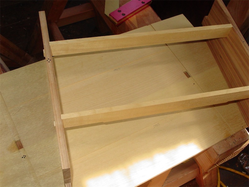

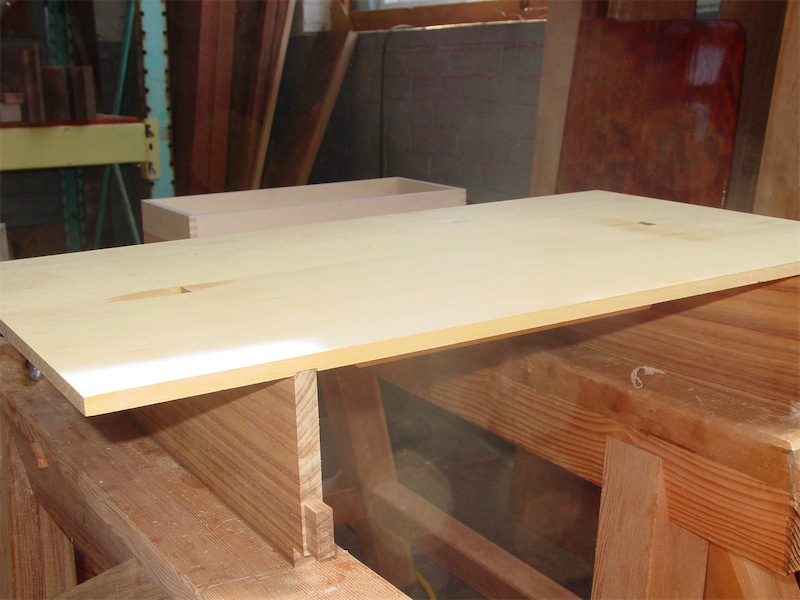

Once you have the partitions done, they are assembled to the floor and the whole works is flipped upside-down:

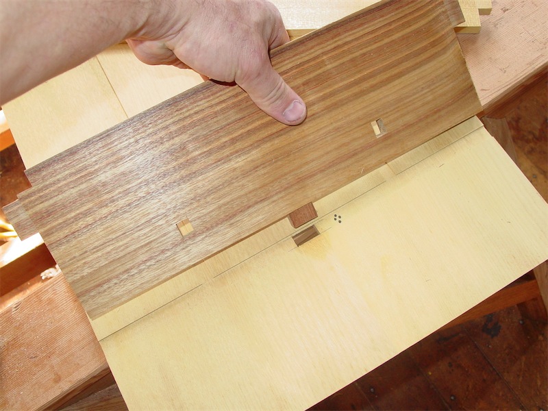

Since the mortising for the keys in the floor has already been completed, you can use the existing mortises to transfer marks to the partition edges:
Marking complete, separate the parts:

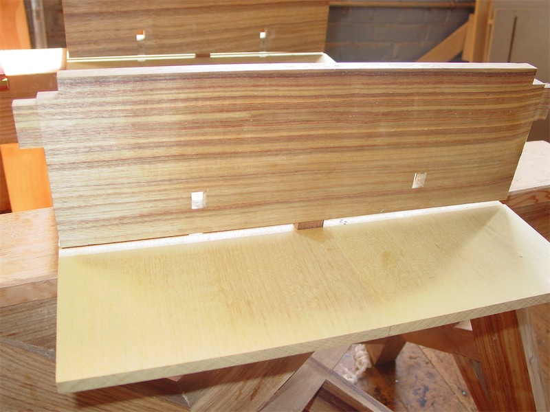

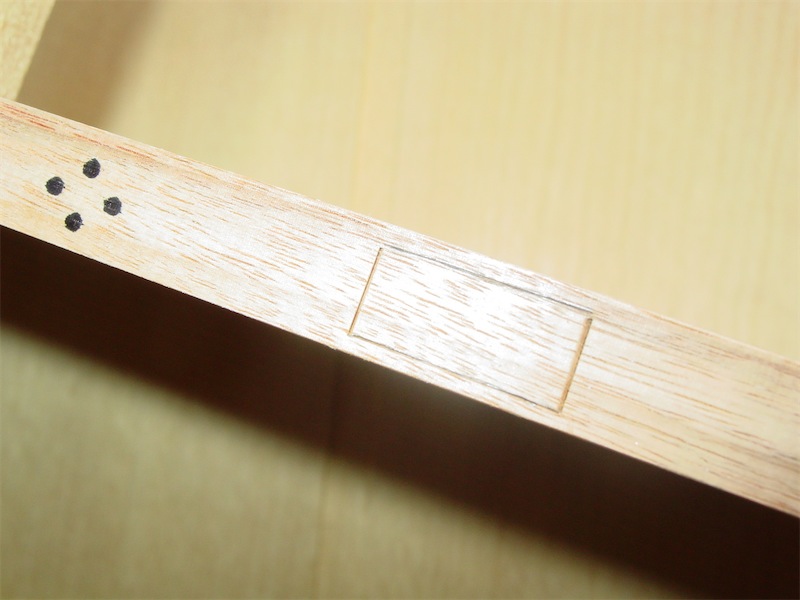

Here's the marked partition edge:

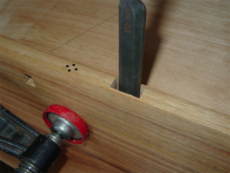

The mortise is 1" deep, though this dimension is not critical. The width of the mortise is 3/8" on a 1/2" board, however the mortise could be slightly skinnier if it had to be (or the partition a bit thicker).

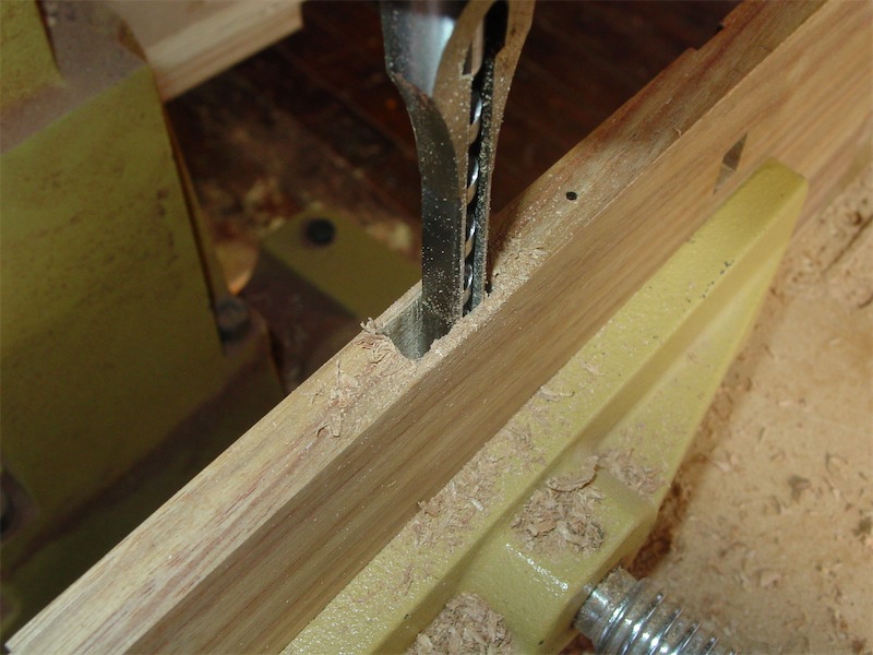

I used a hollow chisel mortiser to rough out the opening, using a underside chisel:

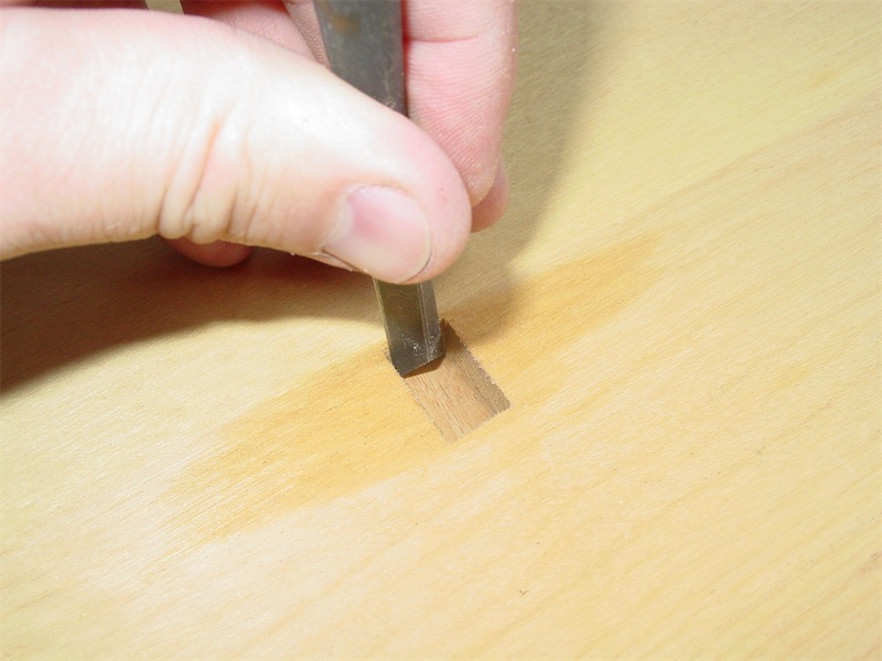

Then I used my router table to enlarge the opening to size, and finished with some chisel work:

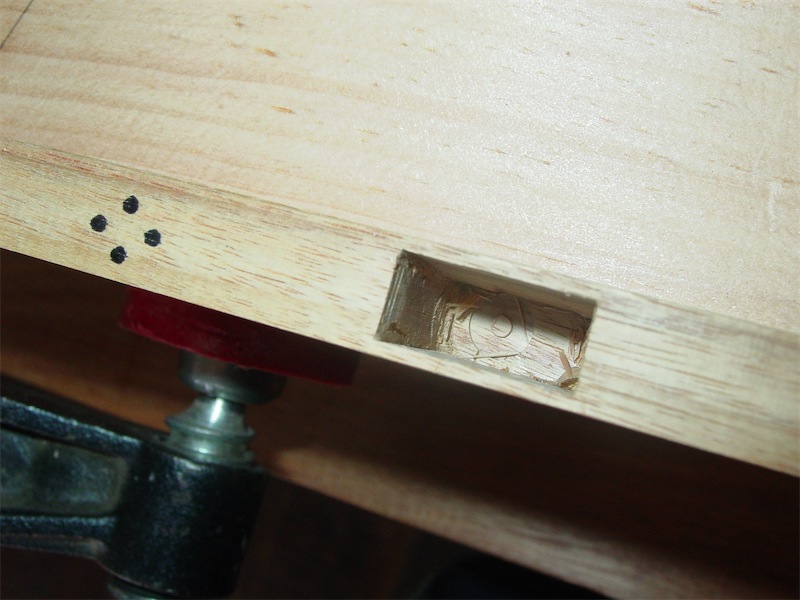

A mostly-completed mortise:

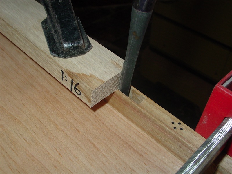

All that remains is to internally taper the mortise. I chose to flare it out 1/16" over the 1" depth, a 1:16 ratio, about 4.5˚. I made up a paring block, and clamped it into place on the edge of the board:
It is critical to get a smoothly pared and clean mortise.

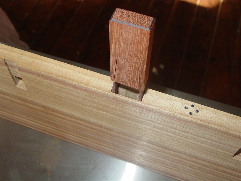

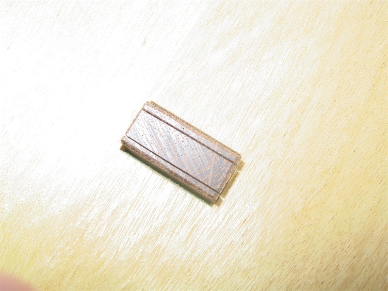

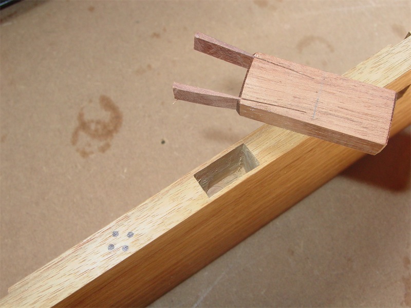

The keys and wedges are then prepared:
At this point, the key is about 1/2" (12.7mm) longer than required. Notice that I've marked a line on the key showing the maximum insertion depth (1" in this case).
It is important to work accurately and gauge the sizes of your parts carefully! One cannot overemphasize this point. If you make the wedges too skinny, then the key will be driven down and will not fully expand the tenon at the bottom, making the joint loose. If the wedges are too fat, the joint will bind before it is all the way down. In either case, the only recourse will be to drill it out and excavate the remains of the key and wedges. Do not try to pull it back out or you will have a mess on your hands.
If you've never done one of these before, it would be wise to execute a few practice ones first.

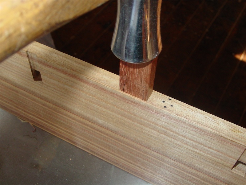

The wedge ends are chamfered as is the end of the key, to ease in fitting down the mortise. The assembly is then offered up to the mortise:
Cross your fingers and down it goes:
All the way down:

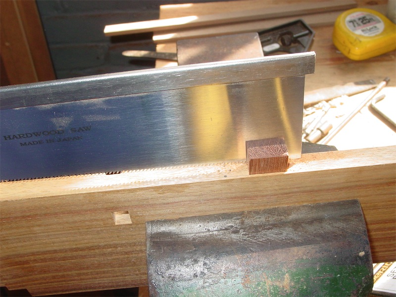

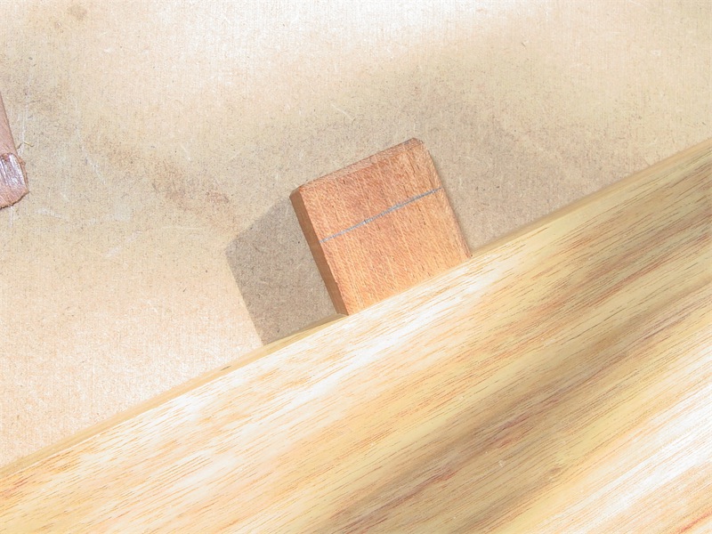

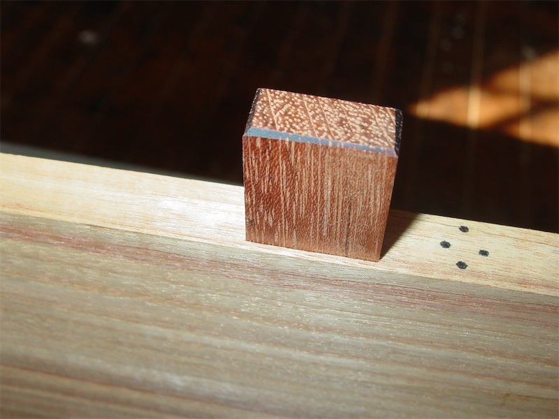

As noted above, the key was left long. Now I mark a cut line 1/2" away from the partition edge:

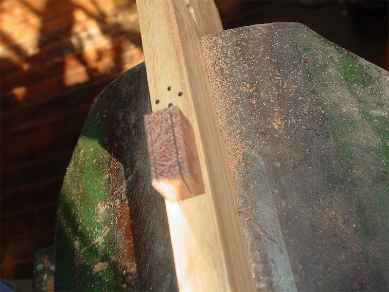

The excess is sawn off and the trimmed end of the key chamfered. Next step is to kerf the end of the key for the other set of wedges, which run 90˚ opposite to the internal hell-tenoned ones:
Done:

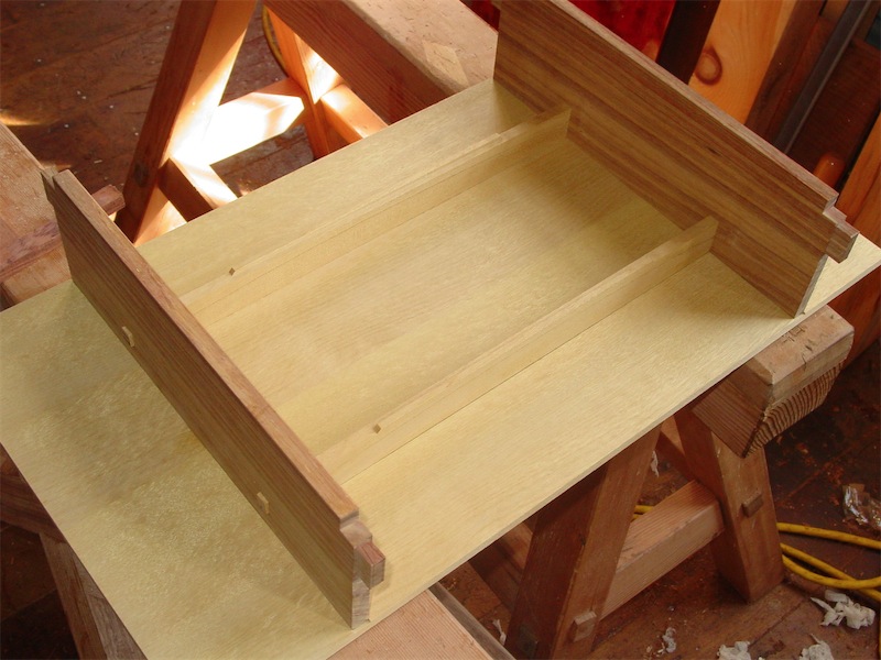

Then, just to confirm alignments, I re-assemble:
And flipping the floor upside down again, we can see the two kerfed keys poking through:
A closer look:
Later, two wedges will be driven in and that will lock the partition assembly to the floor panel. Pictures to follow when that stage is reached.
