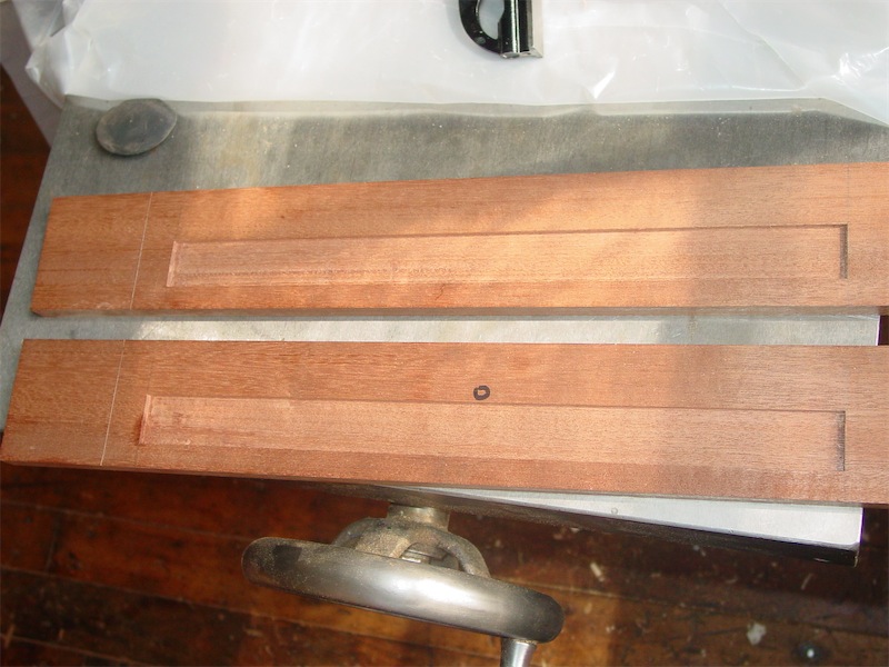

The underside of the caps have shallow housings to index directly onto the tongue which was formed on the top edges of both end boards and handle:

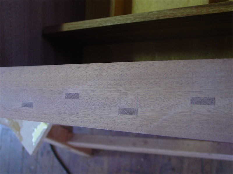

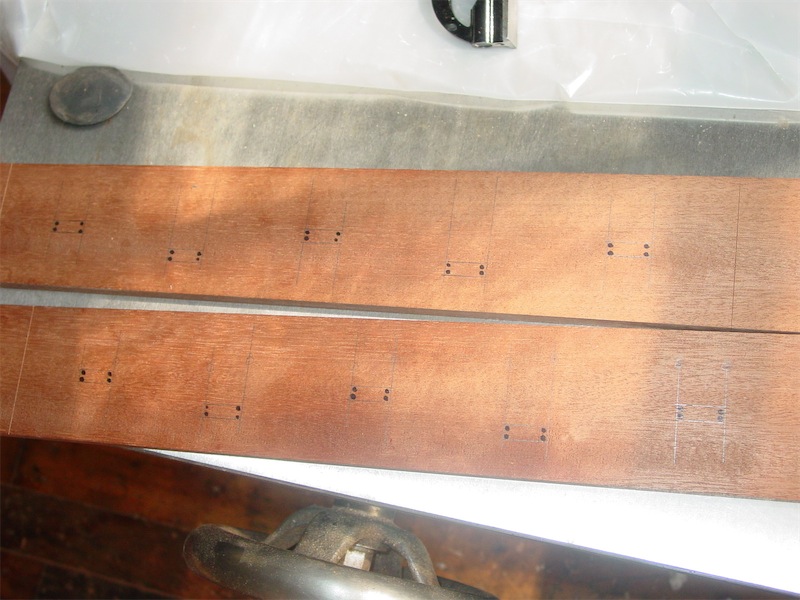

The caps were flipped face up and the layout of the mortises for the keys, connecting the end board assembly to the cap using 5 double-wedged floating keys. This was the strongest connection I could come up with:
The key's are 0.75" wide by 0.25" thick, and enter into the end board assembly 0.625".

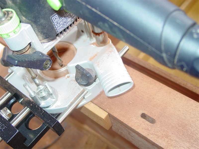

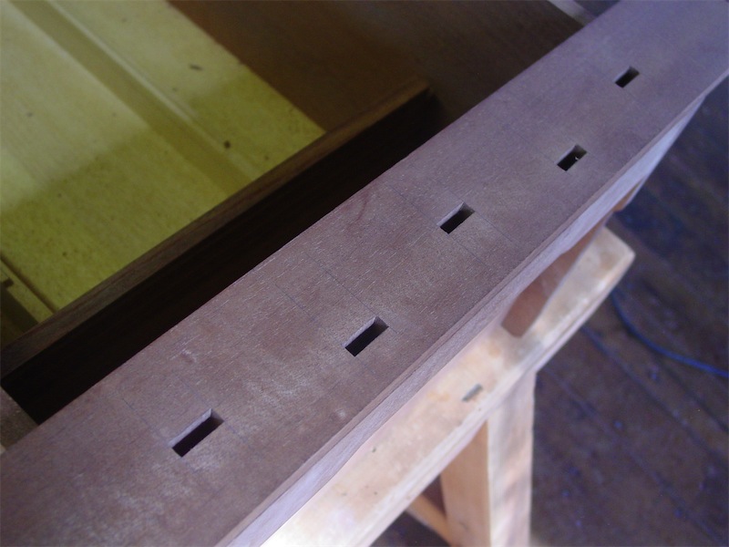

I processed the cuts with the caps mounted in position on the box, using my router and a longish 1/4" solid carbide bit:

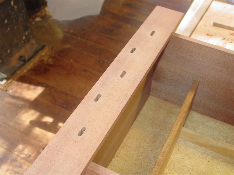

One side done:

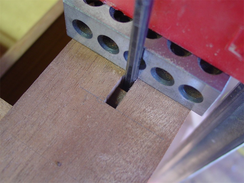

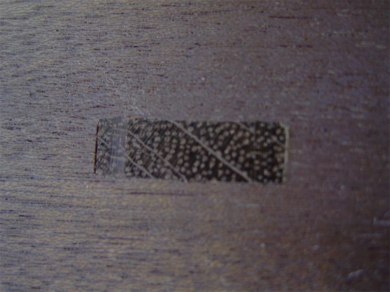

The process was repeated on the other cap. Then it was time to square up the mortises with a paring chisel and guide:
Repeat 10 times per cap:

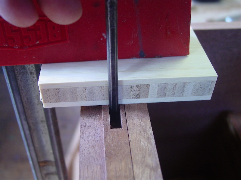

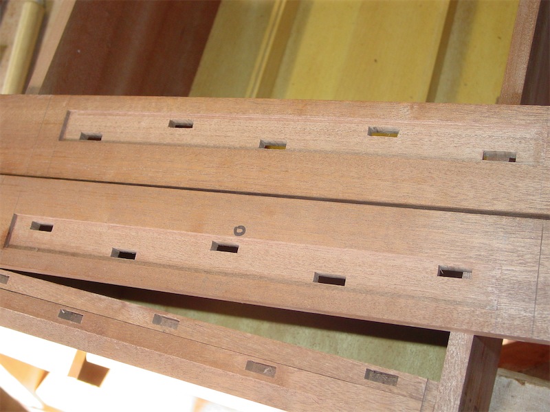

Next step was to create an interior flare in the mortises, which in this instance I worked out to be a 1:9 slope. I prepared a paring block using a piece of laminated bamboo ply, and went to work:
Then end mortises were a little tricky, needing some shimming to support the paring block properly:

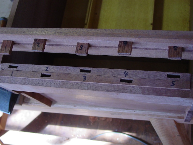

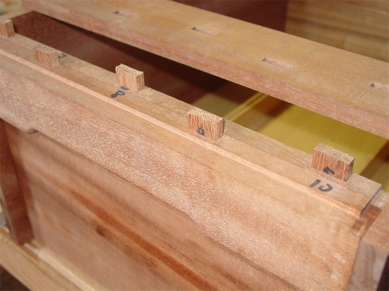

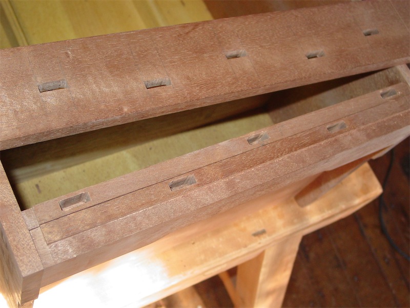

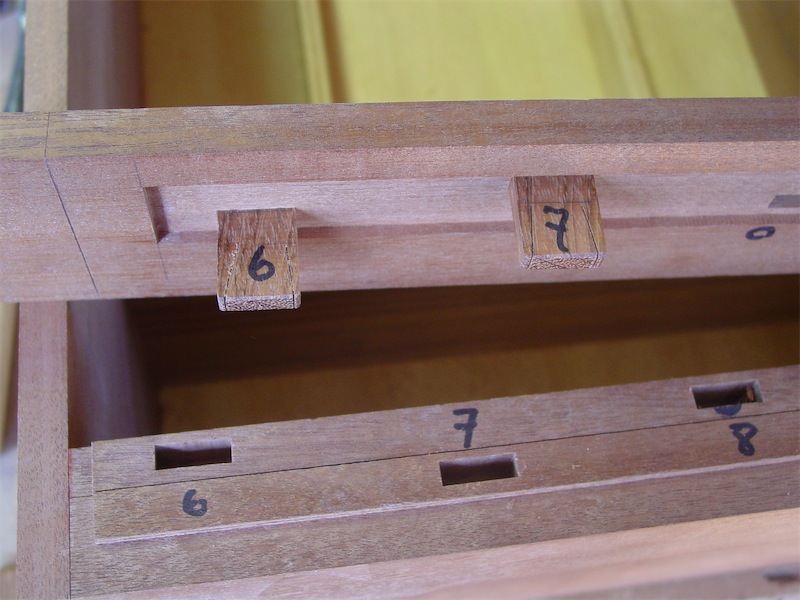

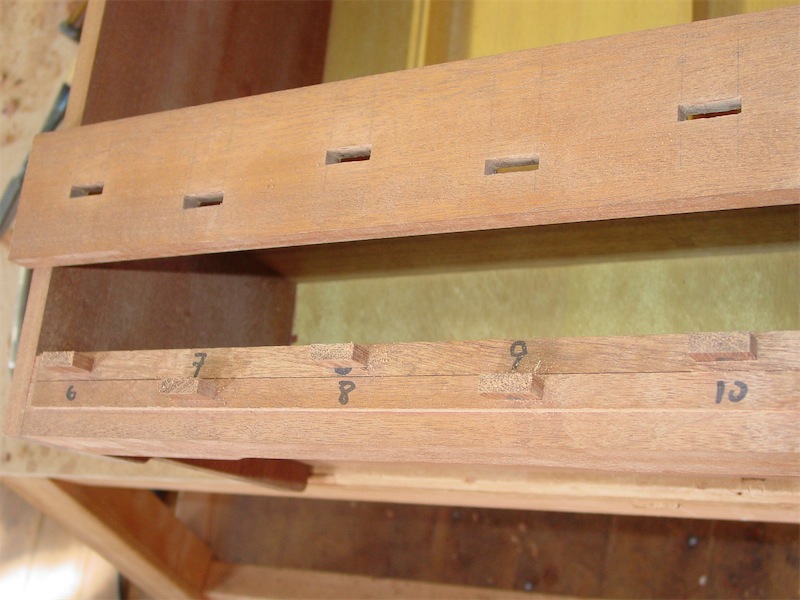

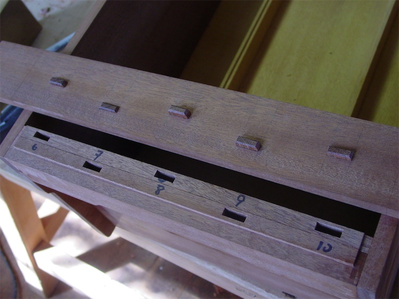

With all the mortises flared out, I prepared 10 keys, using Jatoba, and lined them up like so many ducks:
There was a slight amount of variation between mortises and keys, so they were individually fitted and numbered:
The keys were then kerfed and I began fitting them also to the cap mortises, to make sure they were snug for thickness most particularly:
One end done, fitting keys to cap:
The other end also complete:

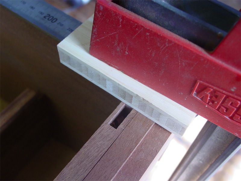

Then the mortises in the cap were flared out, using a 1:8 paring guide, spacing 3/64" off the end line of the mortise:

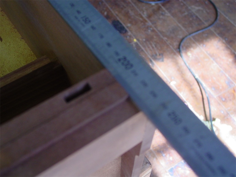

With the cap mortising complete, I trimmed the excess length off the caps so they were close to the dimensions of the box. I'll save a final trimming of the cap ends for some planing work later on.

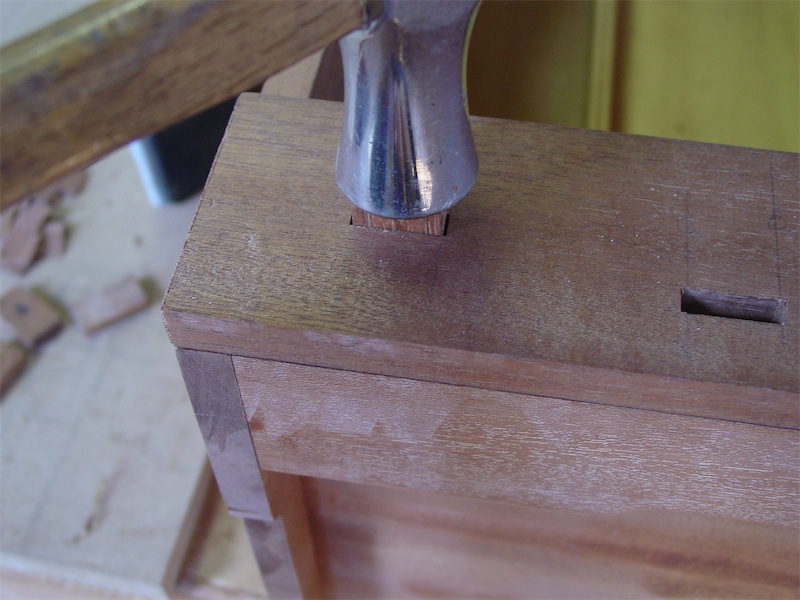

This key is going to hell:
A few taps and it is seated:

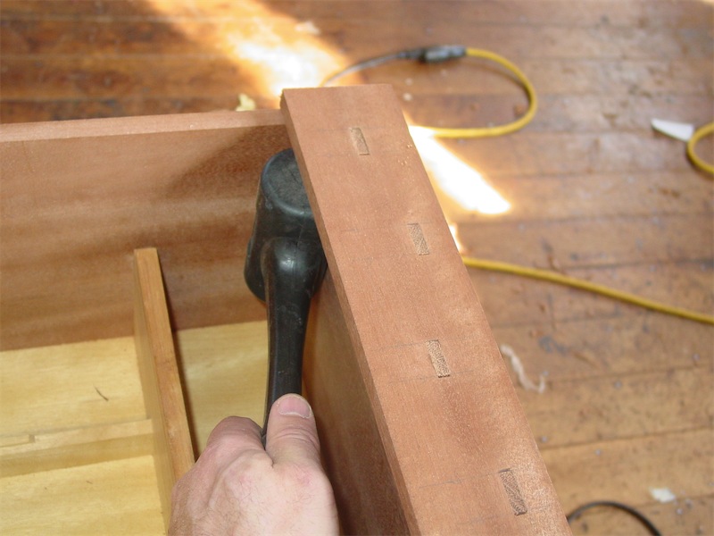

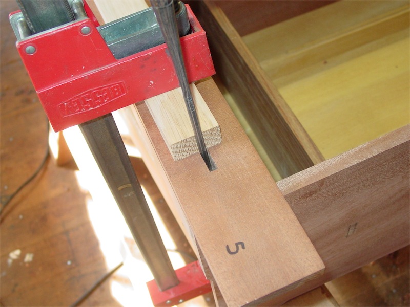

Time to pull the caps back off, using a rubber mallet in a judicious manner:
Separation anxiety only lasts a few moments and then it is over:

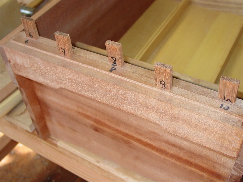

Huh!? It looks like key number 5 and key number 10 must have gotten swapped for one another by accident. It all worked fine though.

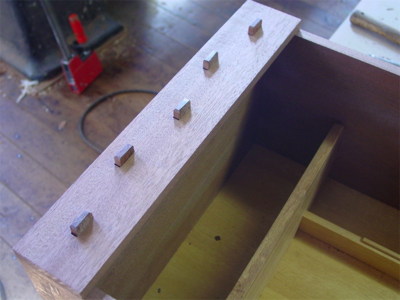

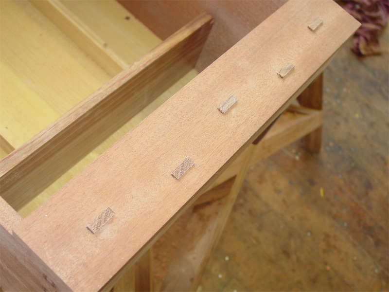

The next step was to kerf the exposed key ends for wedges:

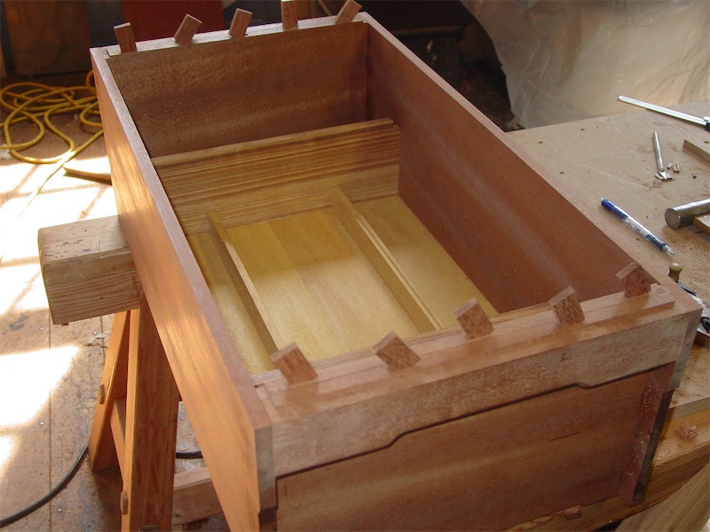

10 keys and 20 kerfs later, I could place the caps back on:
Out comes a clamp and I hold the cap firmly down.

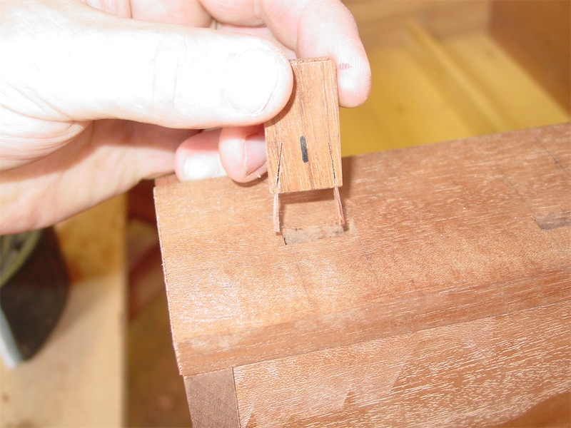

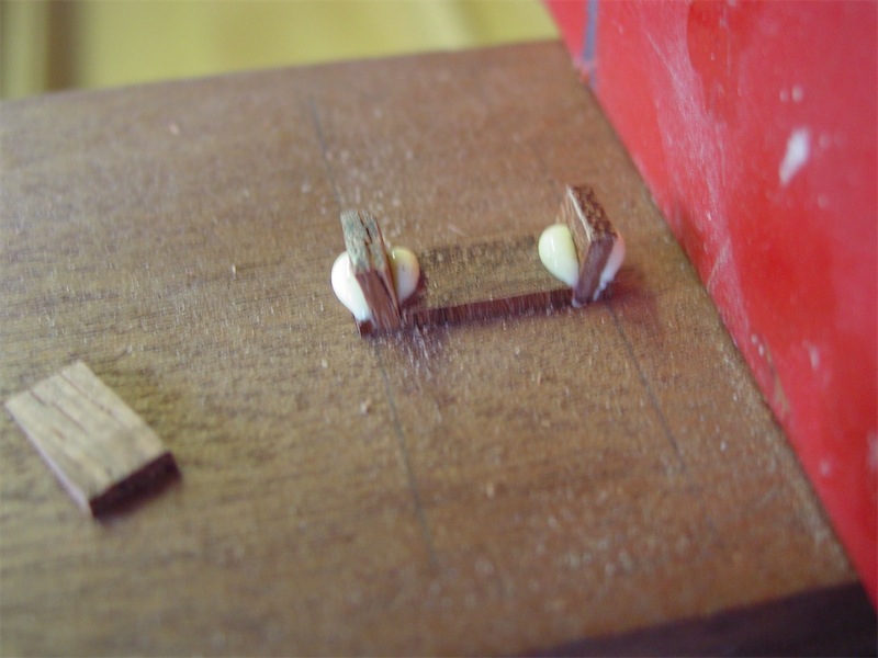

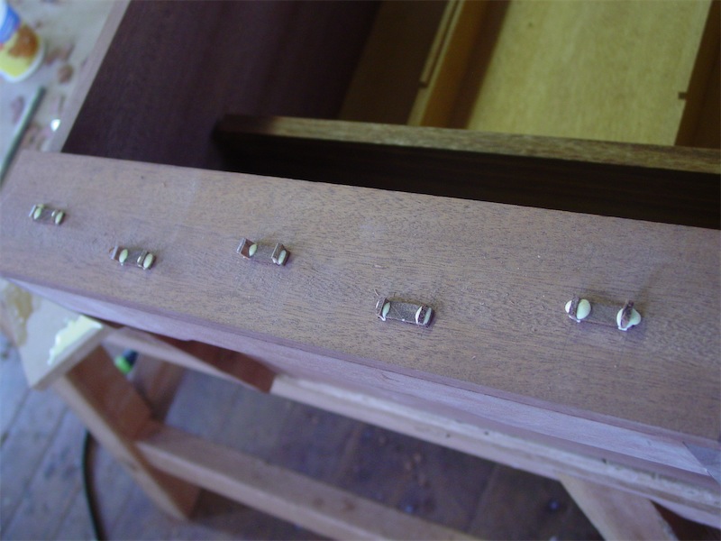

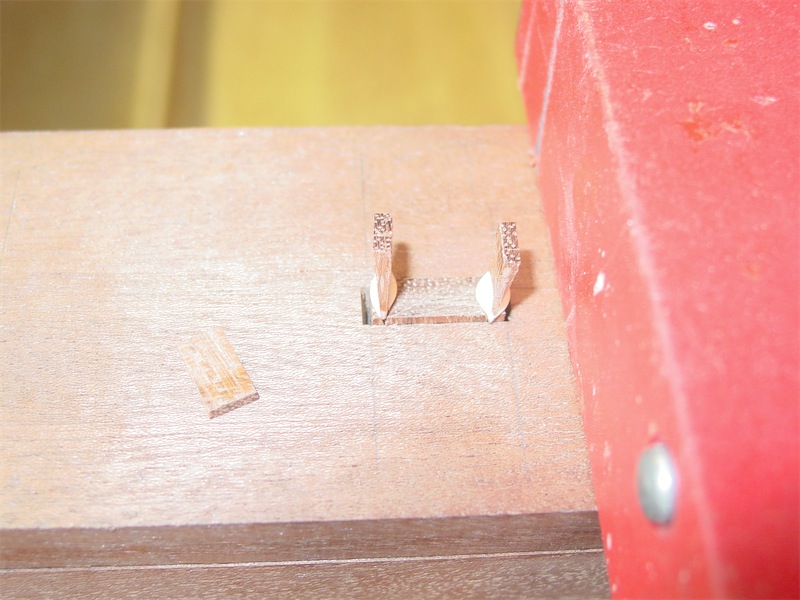

Then I apply a dab of glue to the Jatoba wedges and stick 'em in position:
A little tippy-tapping and the wedges are down:
One row of keys locked down:

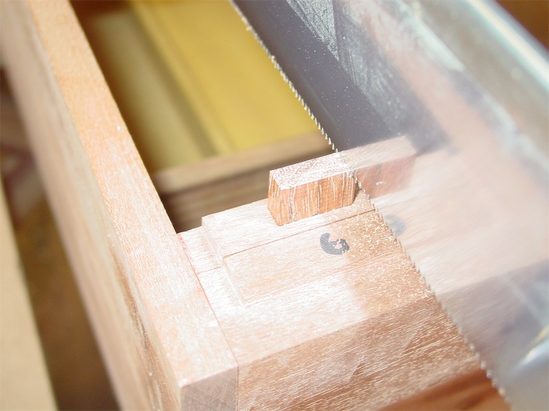

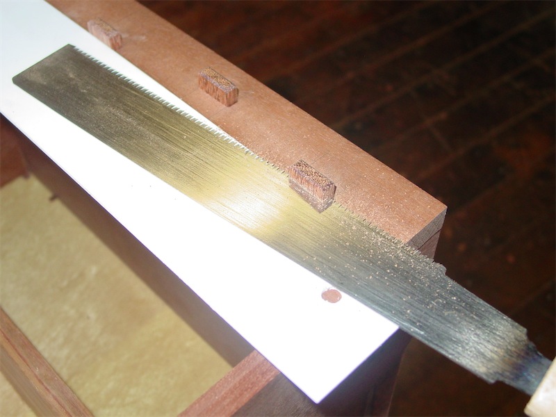

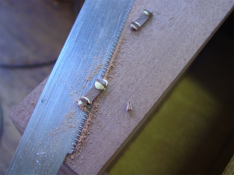

I immediately zip them off with my flush cut saw:
One end all done:

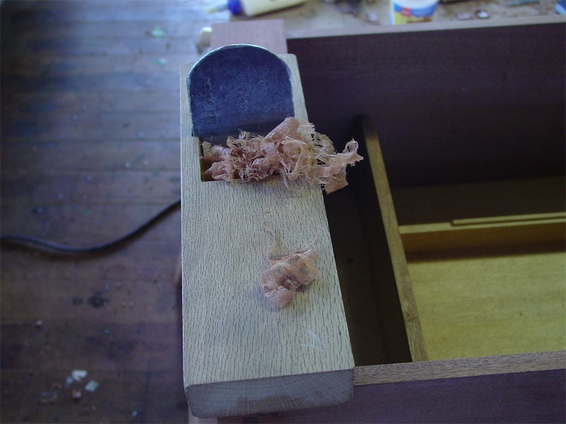

Followed by a casual swipe with a plane to clean it up a bit:

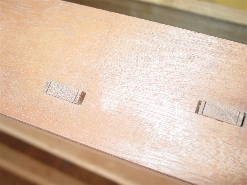

A completed wedged mortise: the Jatoba key and Jatoba wedges make for a discrete connection in a mahogany piece:

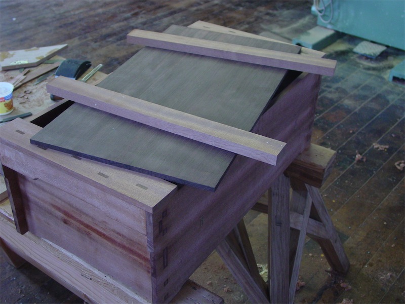

I guess one way I'm dealing with the more elaborate nature of this piece in comparison to the usual Japanese toolbox is that i am choosing to turn the volume down a bit on the connections, making them a little less obvious hopefully.

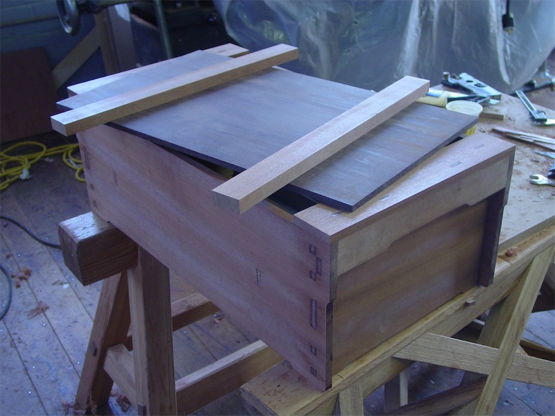

Well, that's all she wrote for the caps - next fun-filled episode will be the lid and its dovetailed battens:
A last look:
One end all done:

I did cut my mortises with a plunge router and a 5.5mm (7/32") uncut spiral bit I have. I indexed the router with an edge fence along the outside edge and made a series of plunge cuts to hog out the mortise. I then made several passes to get the width close to 1/4". The router bit tapered slightly, so I still had to pare the sides using a 1-2-3 block as a guide. While routing, I clamped the cap to the box, so it would not accidentally shift of come loose. I triple checked my measurements, did not rush, and went slowly, left some margin for error by cutting within the layout lines. My second set of mortises was definitely better than the first five.
