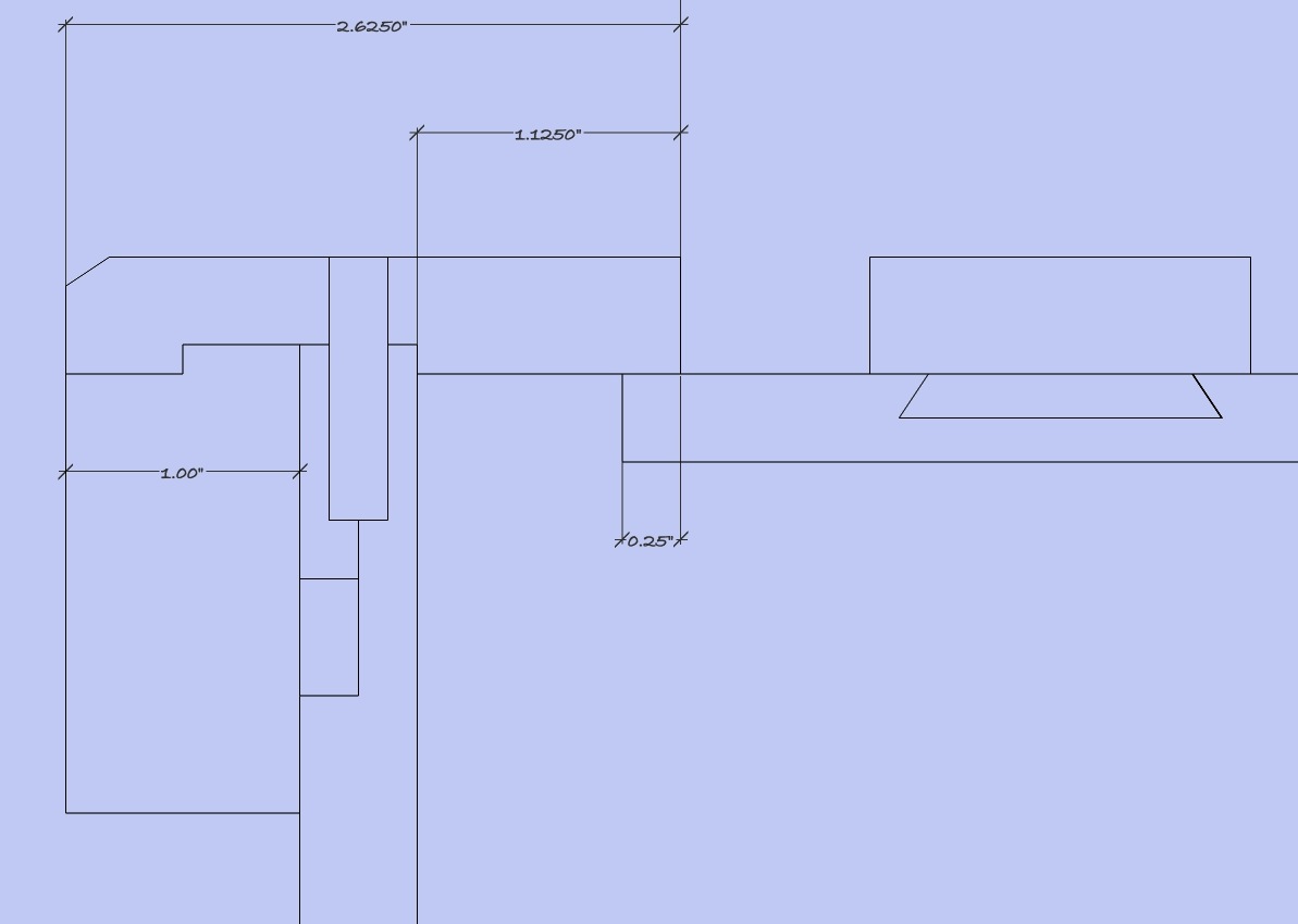

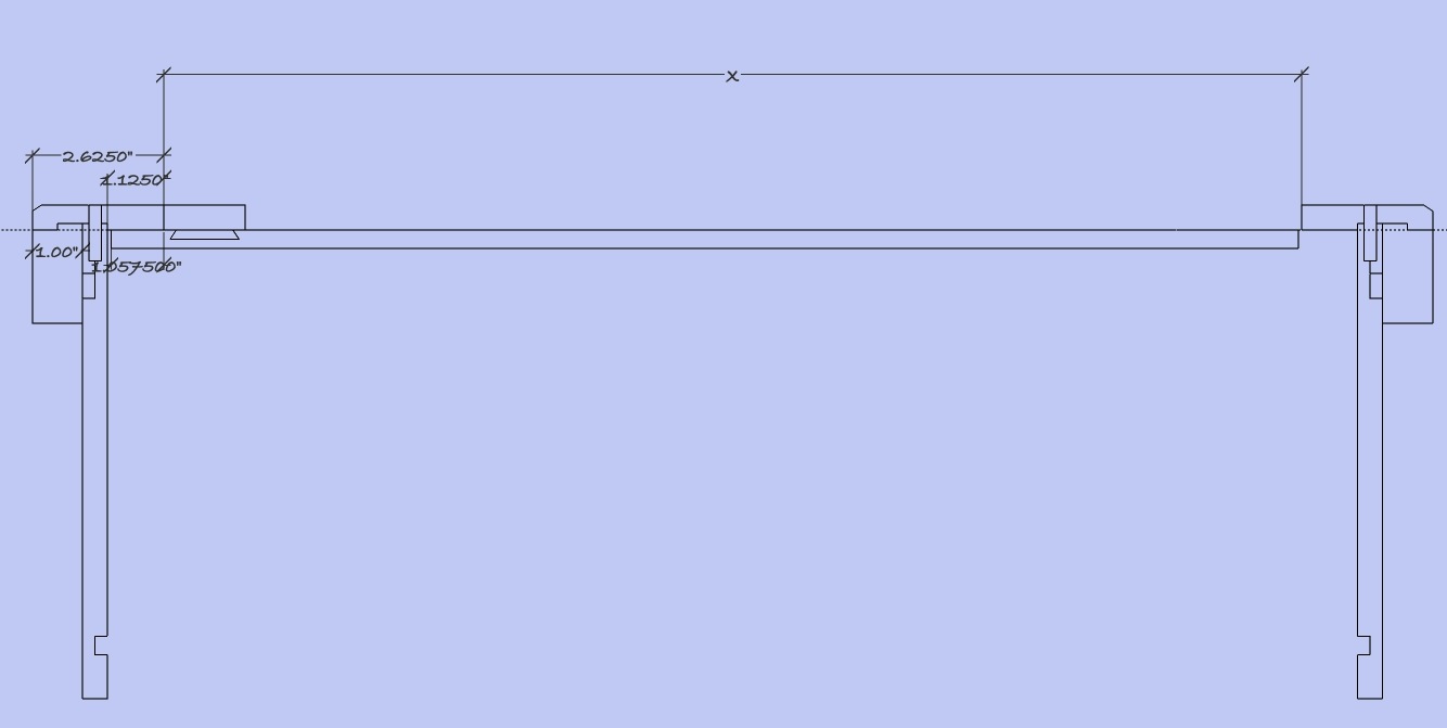

The range of distances which I would suggest are most ideal for the cap to project into the interior box space are on the order of 1.0"~1.25". On my tool box, I made the cap 2.625" wide and therefore the amount of cap sticking out into the box is 1.125":

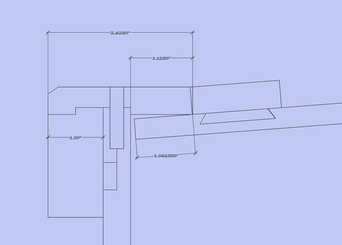

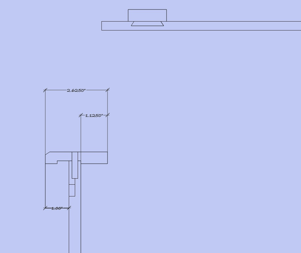

The lid is tipped up and slid under one of the caps to begin the process of putting the lid in place. Since the cap sticks out 1.125", the maximum distance the end of the lid can be inserted is 1.125" Therefore, the batten on that end of the lid must be offset at minimum 1.125". Since it is possible, if the cap were flat-grained stock, that the cap could be shrunk in width at certain dry times of the year, the fitting of the lid into the space would be affected in that the end of the lid would tend to scrape against the inside of the box end wall when the lid is tilted down into position. Therefore, it might be wise to move the lid batten another 1/16" closer to the end of the lid so that there is no possibility of scraping.
So, whatever the amount of cap projection into the box happens to be, the lid batten will be placed on top of the lid so that the amount of lid extending beyond the batten is 1/16" less than the amount of cap projection:

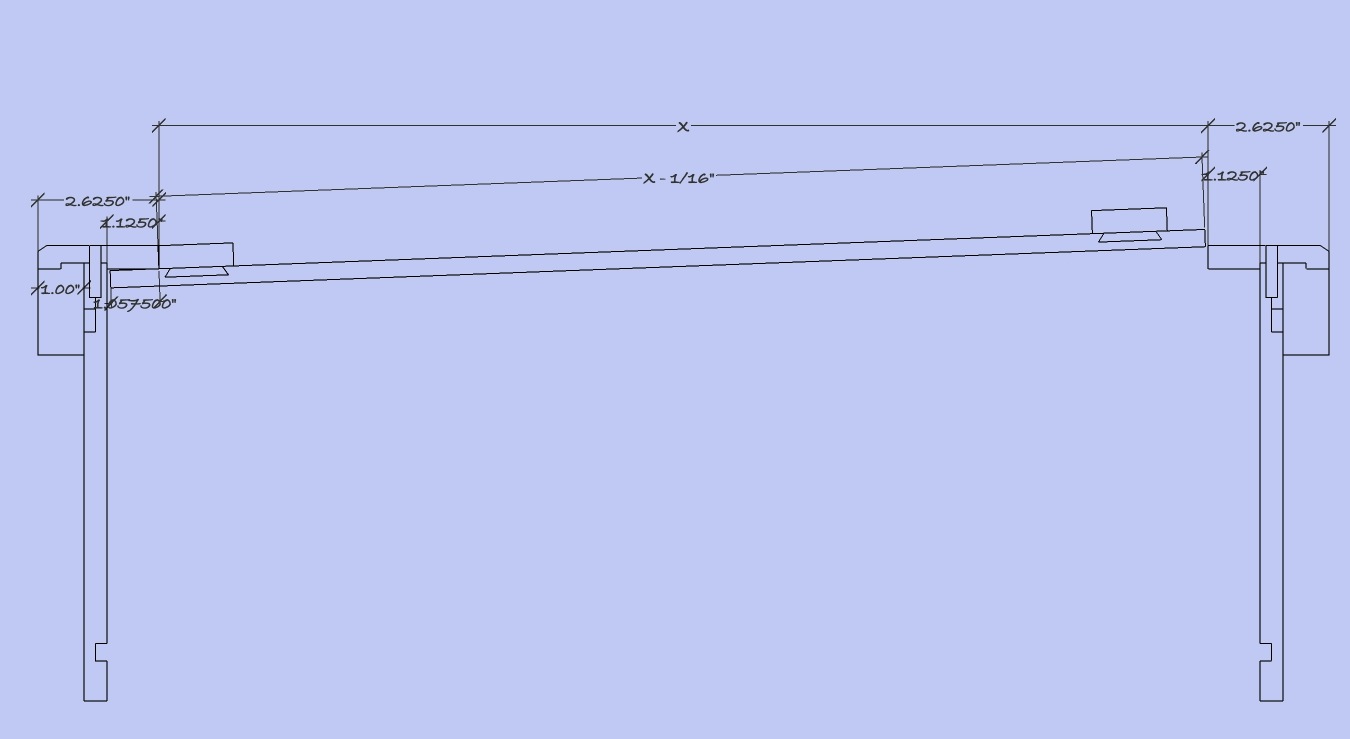

Given that piece of information, you are halfway to determining the fit. With one of the lid inserted maximally, until the side of the batten bottoms out against the edge of the cap, you would next tilt the far end of the lid down into the opening. The opening is the distance between the inside edges of each cap - let's call it 'X'. The length of the lid, as measured from the outer edge of the batten butted against the cap, needs to be a bit less than 'X' so that the lid can drop down through the opening. I would suggest making this length 1/16" less than the opening, or X - 1/16":
Okay, with the lid trimmed to a length so that it will drop into the opening, the lid can be lowered down until it is horizontal:
Once down, the lid is slid horizontally to engage under the cap:

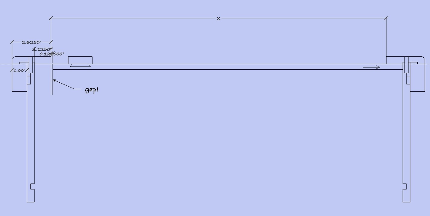

Of course, the other cap also overhangs 1.125" into the opening, so if you were to set things up so the lid could slide all the way over, the lid would no longer be held under the cap at the other end - there would be a slight gap and the lid would be able to come out, which is not what you want:

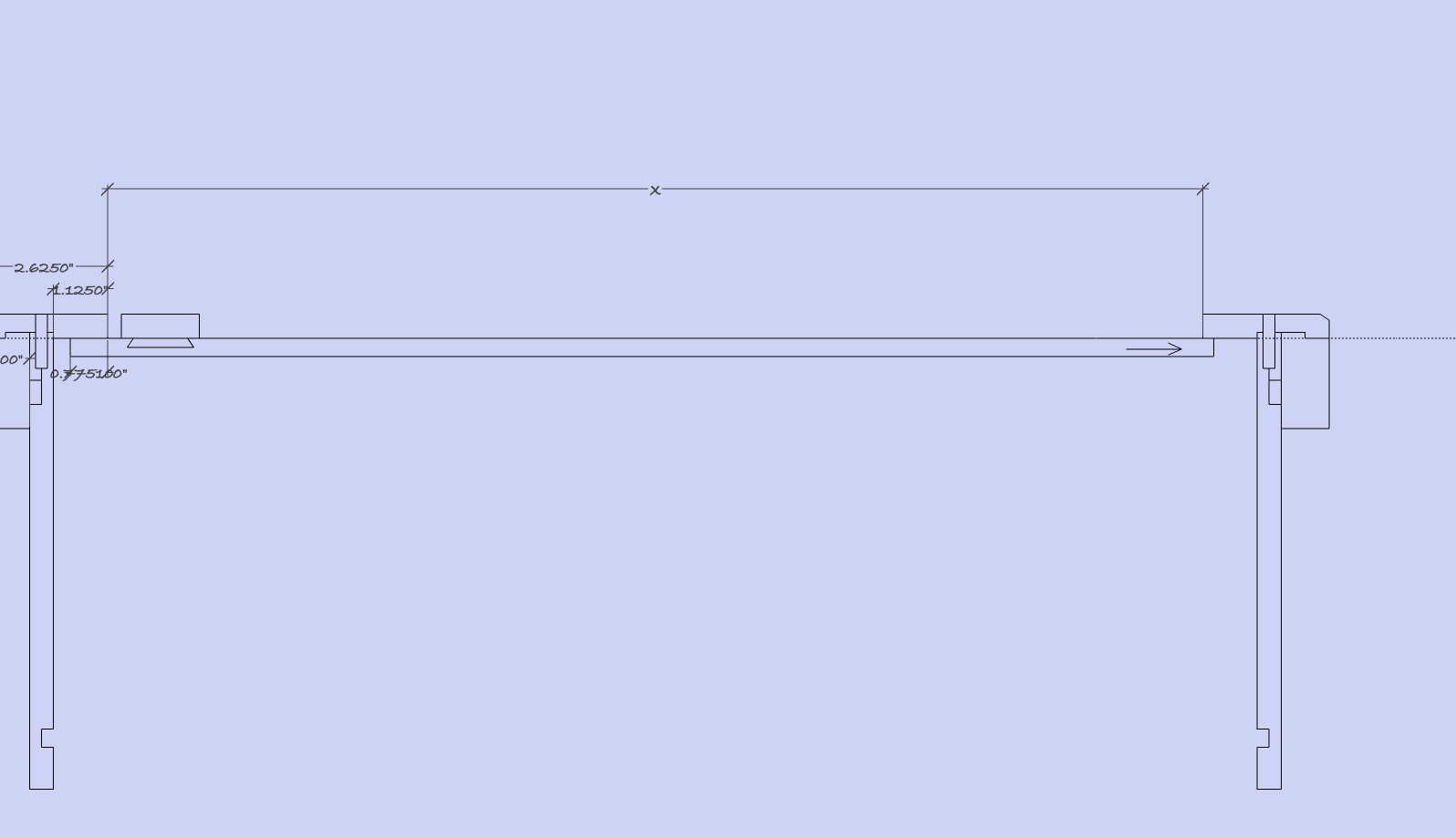

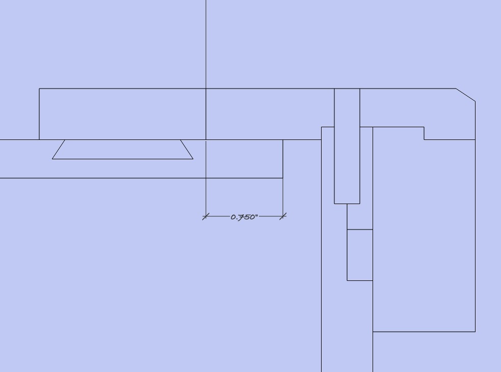

What you want is the lid to slide over to the point at which there is still 3/16"~5/16" overlap with the cap at the insertion end. Here, the overlap is 0.25":
With the lid at that position, you can mark the position for the second lid batten- in this case it is in from the edge of the lid 0.75":
