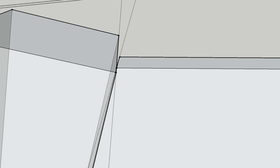

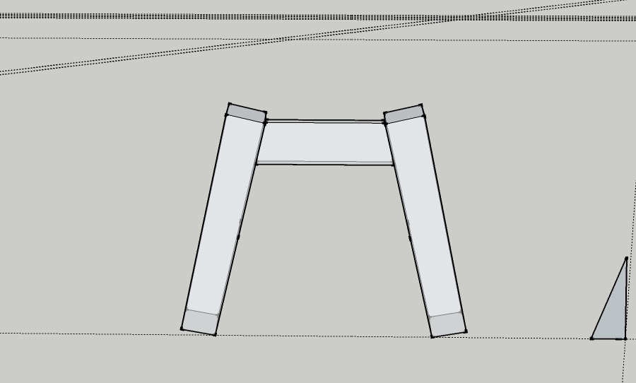

I also attached a couple of really quick images from sketchup showing a similar situation to what is described for the stool, with the legs square in cross section, at a 15 degree angle, and with an apron between the legs cut with a square butt cut... hope that makes sense.
I think either I'm missing something and the designs for these two pieces would still result in tight joinery, or the authors ignored the small gap produced at the intersection of leg/cross member. Also, I believe if the gap was ignored it would face the inside of the stool or table, and so would appear tight from the outside... but I also think it would require a bit of looseness in the joinery.

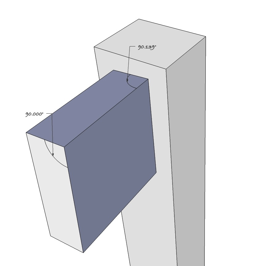

The Garrett Hack article annoyed me when it first appears and continues to annoy me on the re-read. Yes, he doesn't seem to mention cutting the top/bottom stretcher abutments at a slight angle. I decided to do a quick Sketchup model myself to see how close he would be, given the 4˚ splay angle mentioned in the article:
As you can see, on the top/bottom stretcher surfaces, a 90˚ cut would be out by 0.14˚, And the apparent error on the broad faces of the stretcher is negligible - likely a sketch Up error.

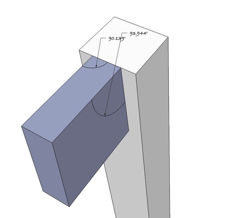

I also drew the stretcher lower down, without the upper surface beveled to match the top of the leg to confirm that the 90˚ angle would still be out (should be the same as the above drawing), as he processes the cuts with the stretcher as a rectangular section:
Yup.
My guess is that he assumed a slight cut out error and simply made a little adjustment to the tenon shoulders after he tried the fit. Or maybe he just clamped it up tight and kind of squished the grain down on the leg. Maybe the cock-beading covers it up a bit too. I don't know, but it is articles like that which have led me to not bother with that magazine any more.
If the leg shape is not backed, then the stretcher top/bottom edge bevels are obviously going to be different, however the connection can certainly be made cleanly - if Hack had taken any time to actually explore the work he is tackling to a more detailed level, he could have cut the stretcher end cuts to the correct required angle to meet an un-backed leg cleanly.
Yup.
