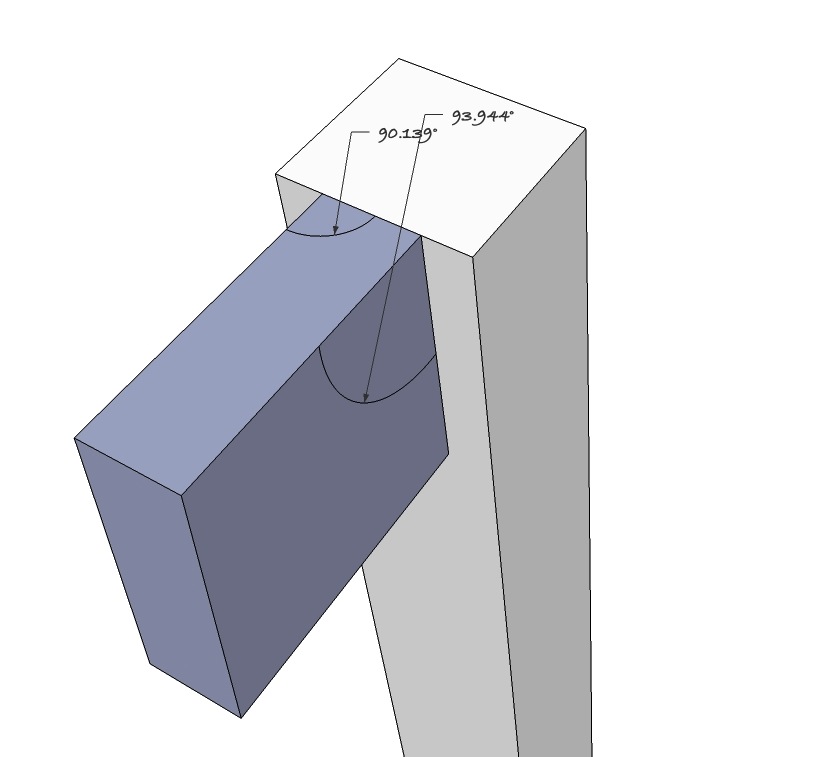

The Garrett Hack article annoyed me when it first appears and continues to annoy me on the re-read. Yes, he doesn't seem to mention cutting the top/bottom stretcher abutments at a slight angle. I decided to do a quick Sketchup model myself to see how close he would be, given the 4˚ splay angle mentioned in the article:
4˚ splay.jpg (41.85 KiB) Viewed 20518 times
As you can see, on the top/bottom stretcher surfaces, a 90˚ cut would be out by 0.14˚, And the apparent error on the broad faces of the stretcher is negligible - likely a sketch Up error.

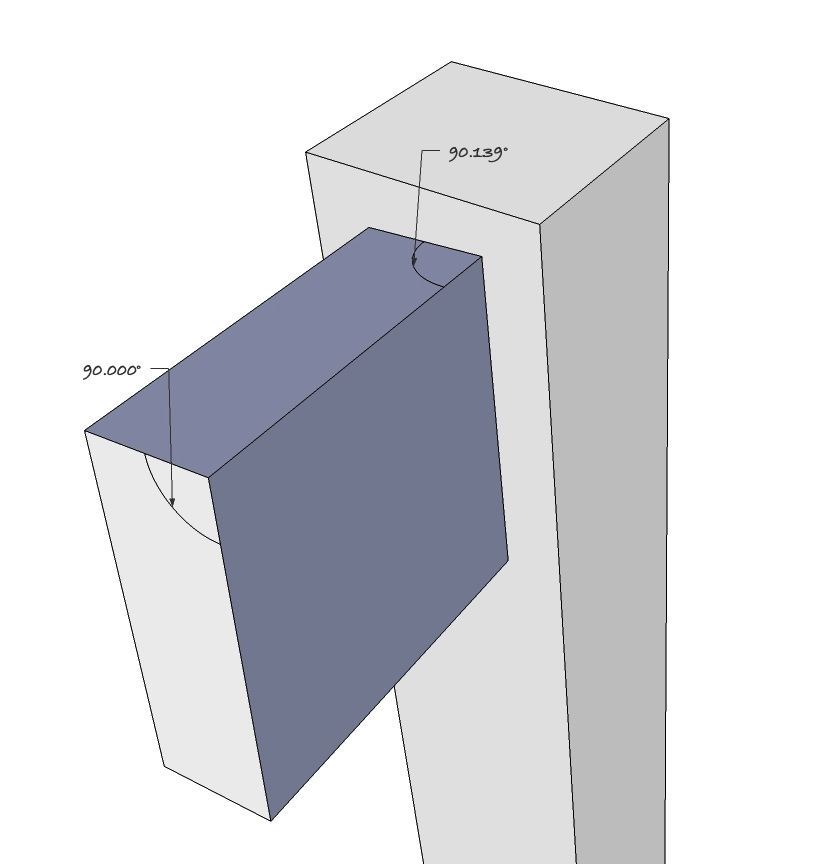

I also drew the stretcher lower down, without the upper surface beveled to match the top of the leg to confirm that the 90˚ angle would still be out (should be the same as the above drawing), as he processes the cuts with the stretcher as a rectangular section:
4˚ splay 2.jpg (45.79 KiB) Viewed 20518 times
Yup.
My guess is that he assumed a slight cut out error and simply made a little adjustment to the tenon shoulders after he tried the fit. Or maybe he just clamped it up tight and kind of squished the grain down on the leg. Maybe the cock-beading covers it up a bit too. I don't know, but it is articles like that which have led me to not bother with that magazine any more.
If the leg shape is not backed, then the stretcher top/bottom edge bevels are obviously going to be different, however the connection can certainly be made cleanly - if Hack had taken any time to actually explore the work he is tackling to a more detailed level, he could have cut the stretcher end cuts to the correct required angle to meet an un-backed leg cleanly.
