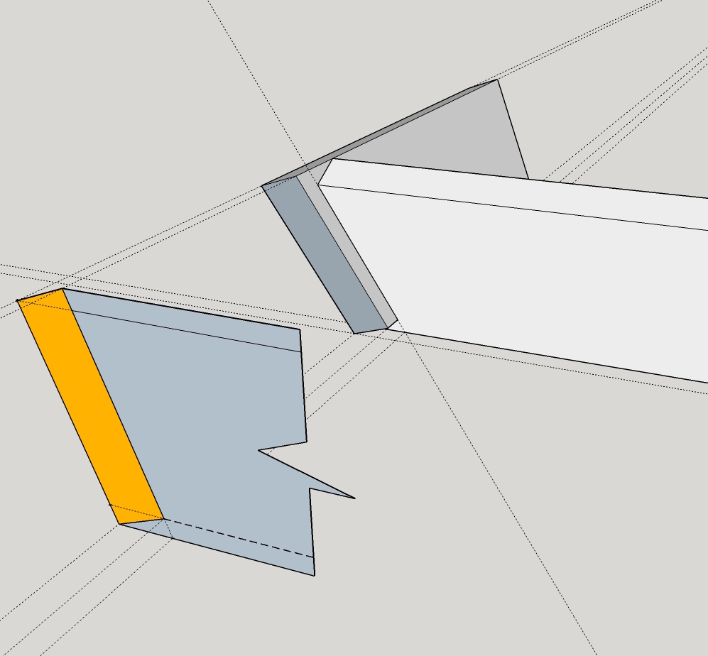

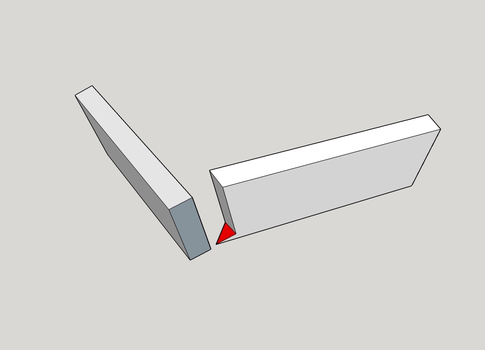

Here's the basic situation where laying out the hogen slope will produce a return (lip) on one of the pieces meeting at a hopper corner:

Now, we can represent the intersection of the parts with an elevation view:
hogen 5.jpg (173.69 KiB) Viewed 24179 times
Since it is an elevation view, and the parts we are joining are at slope, we cannot use the elevation view to obtain our cut angles or actual lengths of parts for the facing board. The adjoining board, of which we see an end grain print in the elevation view, is depicted at actual x-section size of course.

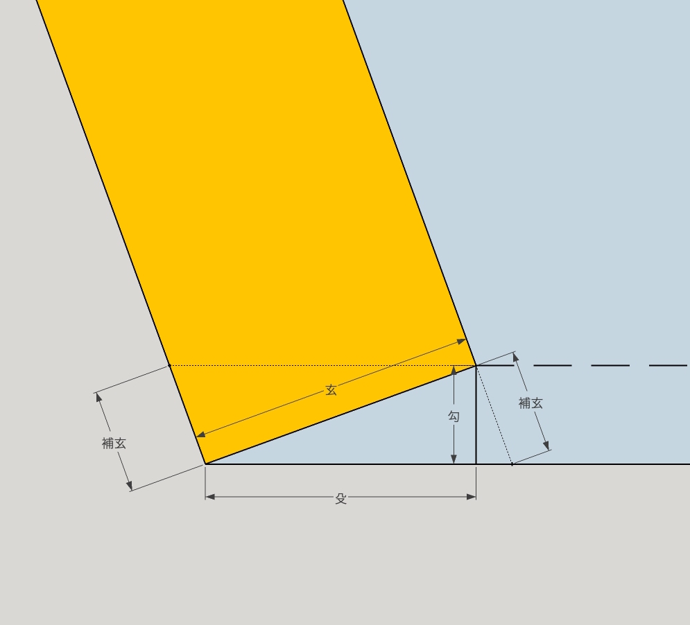

In the elevation view, we can ascribe our unit triangle to the view of the adjoining board end, as follows:

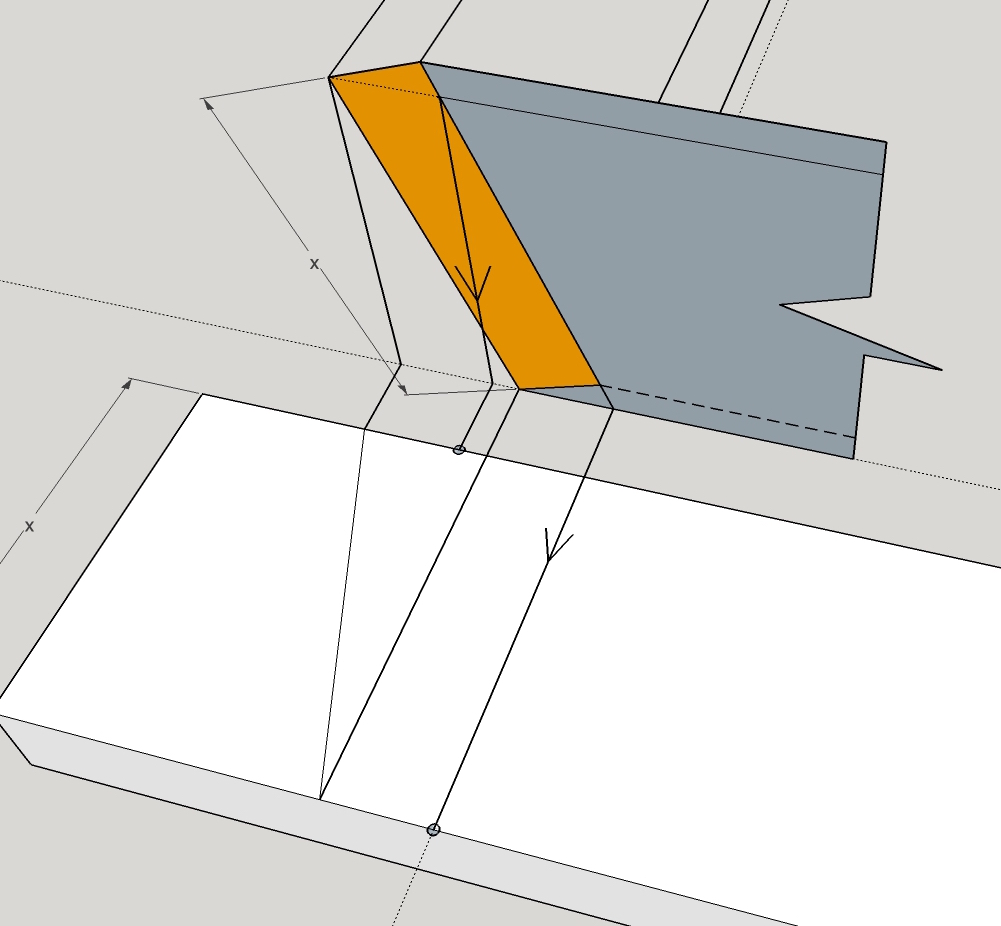

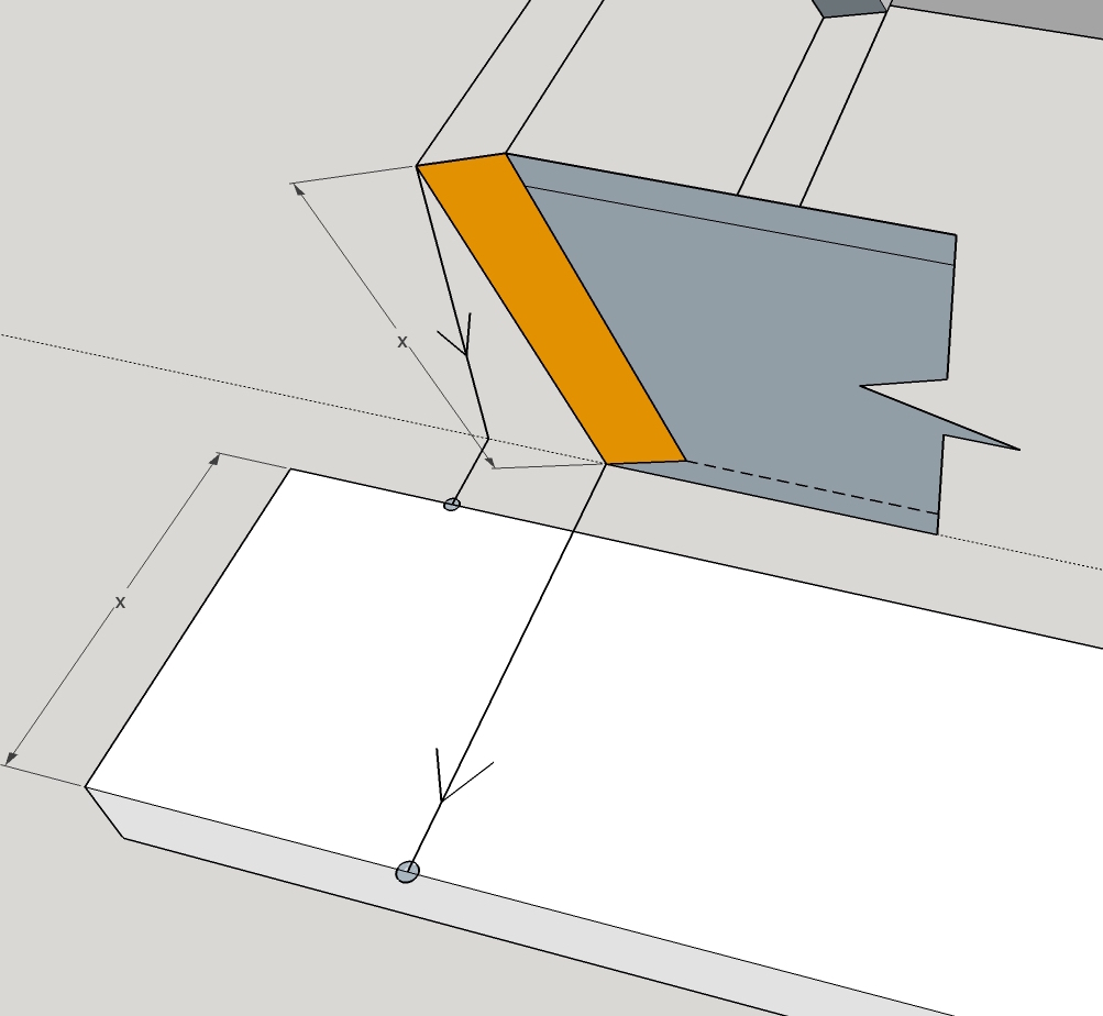

Let's now project from the elevation view over to the board we wish to layout upon, starting with the lines which will give the face cut:
hogen 7.jpg (154.2 KiB) Viewed 24179 times
The dimension 'x' gives the cross-section width of the other piece to which we are connecting.

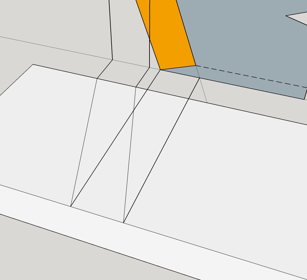

Similarly, we can project lines for the face cut miter, noting that we take these lines in reference to the board we are laying out:
hogen 8.jpg (168.21 KiB) Viewed 24179 times
Connect the dots and we have our face cut lines:

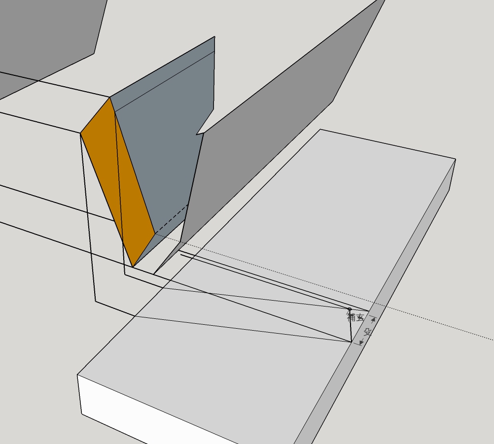

Now I'll insert a plane at slope with the face and seat cut already made, so it can be compared to the elevation view:
Hogen 10.jpg (170.26 KiB) Viewed 24179 times

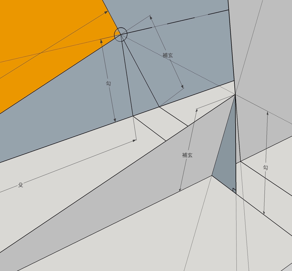

Let's zoom in a little closer so we can see what is happening:
hogen 9.jpg (183.4 KiB) Viewed 24179 times

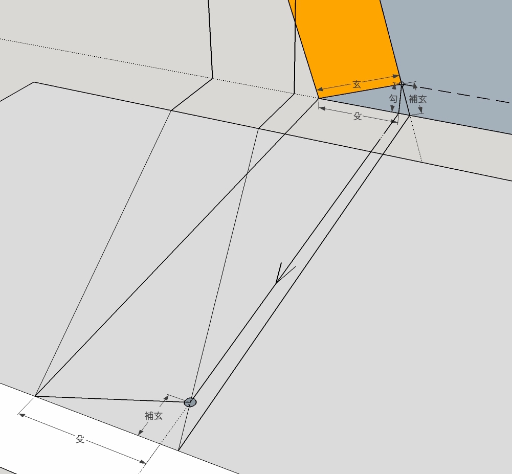

When we take a component length from the unit triangle (drawn in an elevation view), and place that component at slope, the length will become the next larger related component in the unit triangle. They are like secants to one another. For example, if you took a dimension for chōgen (長玄) in plumb and tilted it to unit slope, it would become the same length as run of the triangle, ko (殳); if we took the dimension for the run ko (殳) and placed it at slope it would become the same length as gen (玄). These points were clearly explained in tAJCD volumes II and IV, especially when looking at leg length reckoning for a splayed post structure.
In this case we are not dealing with the longer sides of the triangle undergoing change when tilted, but the short side, or kō (勾). The next largest related triangle component for that measure is hogen (補玄), aka the 'supplemental' slope. Thus to lay out the height kō (勾) found on the elevation plane onto the actual board face (which is tilted), we must use hogen (補玄) on that tilted plane.
The key point is to be clear on what the elevation view is representing and what happens to the unit triangle parts which associate to the elevation view when we are laying out on the actual board, which will be placed at a tilt. The tilting affects dimensions in the unit triangle which are vertical (i.e, kō (勾)), and not those which are horizontal (i.e., ko (殳)). Horizontal dimensions are unaffected by tilts of the board to slope.
Thus, the return lip is defined by the horizontal run ko (殳) paired with the 'stretched' rise, kō (勾), which became hogen (補玄).
Using projection, we can also mark the intersection of the hogen slope with the board's face cut line:
