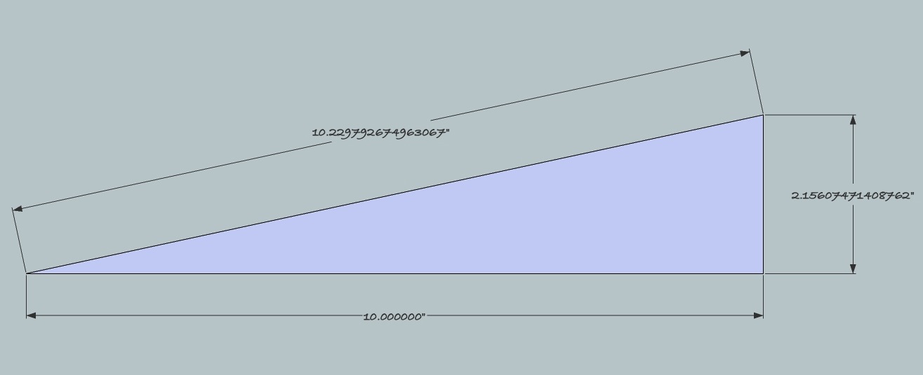

Your impression is a bit erroneous I'm afraid. Let's look at what a tangen slope triangle would look like:
CSG Hopper 2 tangen triangle.jpg (39.39 KiB) Viewed 77660 times
In order to find an angular value, we can use tangent, that is, opposite / adjacent. The opposite is 2.15607... and the adjacent is 10:
ARCTAN (2.15607 / 10) = ARCTAN (0.215607) = 12.16714376˚
Now, looked at from the other end of the tangen slope triangle, in reference to a plumb line, opposite and adjacent would be reversed and we would obtain a much steeper angle. You suggested 85.13˚. All we need to do is subtract the angle value we just found from 90˚:
90 - 12.16714376 = 77.832856˚

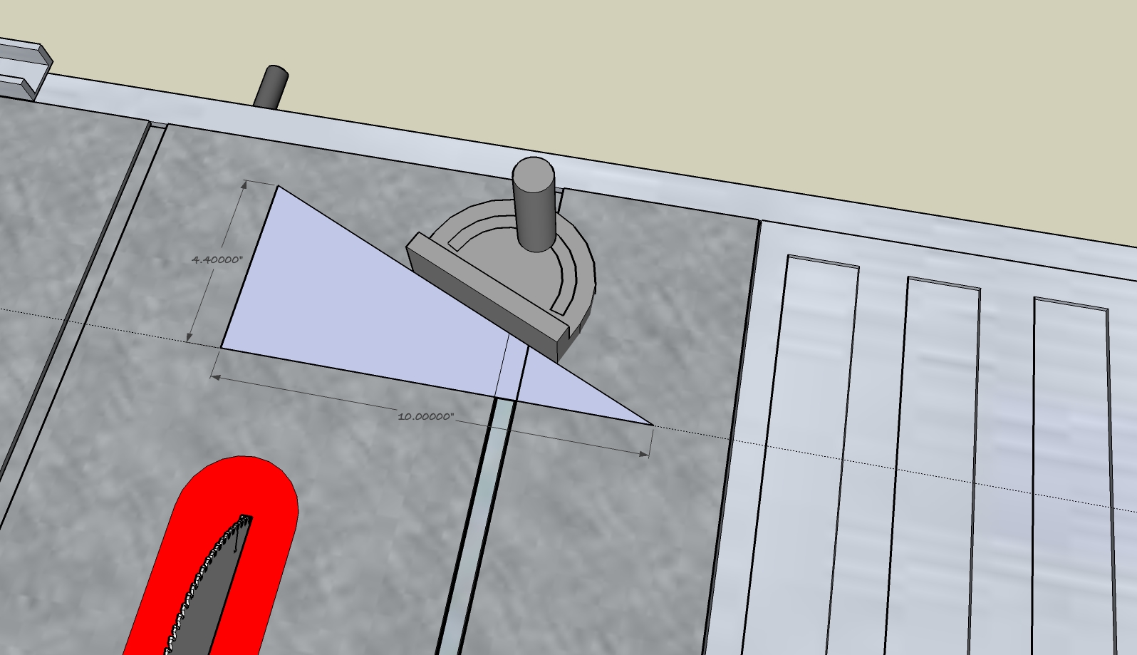

Let's take a look with some drawings at the problem in case my words were inadequately clear. The first task was to set the saw's miter gauge to the chūkō slope:
set chuko.jpg (369.32 KiB) Viewed 77660 times

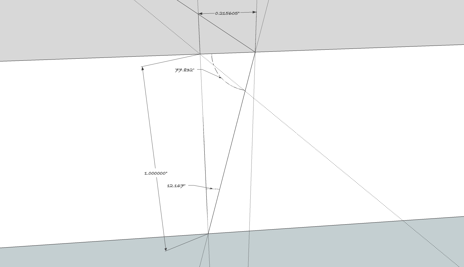

Let's check that tangen layout on the board edge to ensure that it conforms to the numbers mentioned previously which I obtained by calculation:
tangen on board edge.jpg (119.42 KiB) Viewed 77660 times

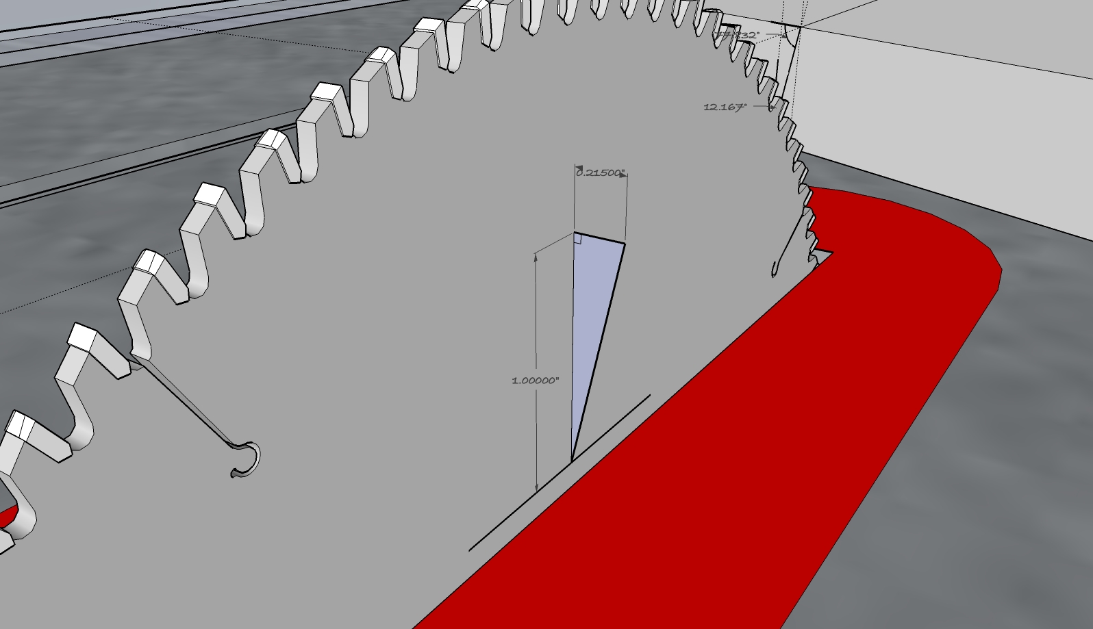

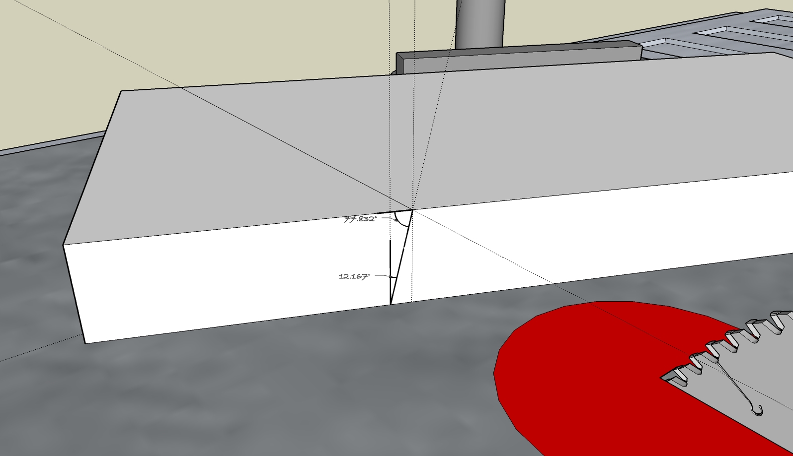

Next, I am going to set the sawblade to the same tangen slope angle value:
set sawblade.jpg (262.94 KiB) Viewed 77660 times

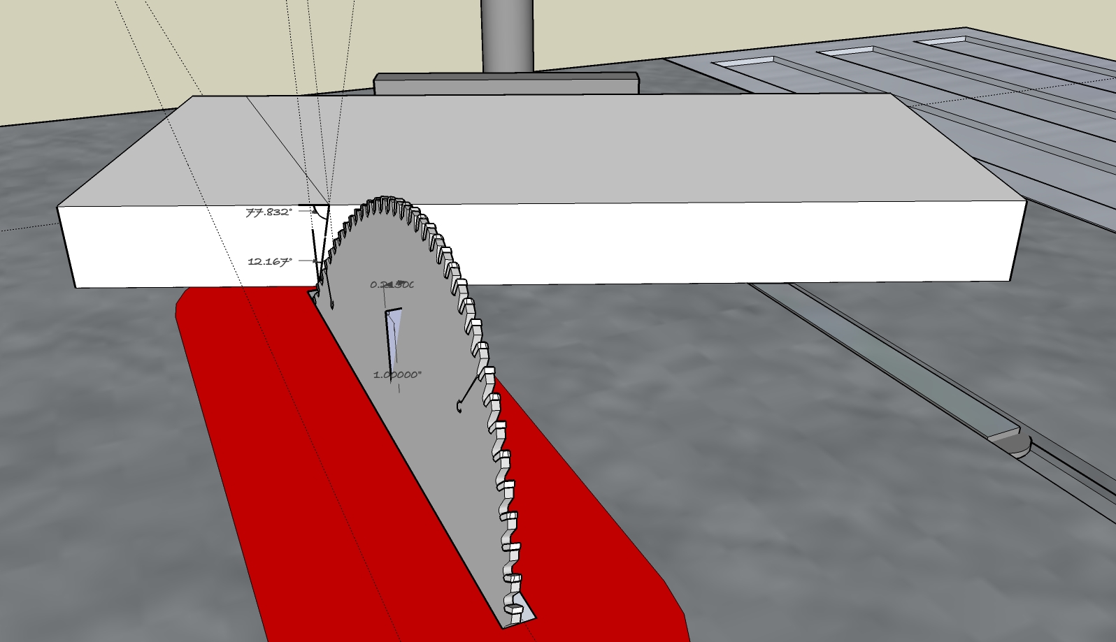

I tilt the blade to that angle, and now let's run the board into the blade to see what happens - here's a view from the backside perspective as the board approaches the blade:
start cut.jpg (318.5 KiB) Viewed 77660 times

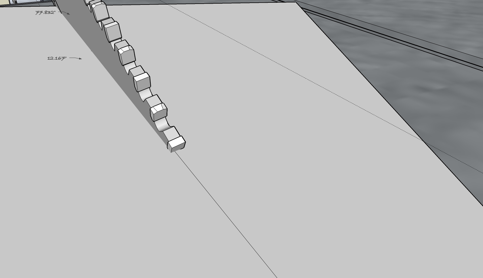

Running the board into the blade now, and let's see how the cut line looks, here from the operator's perspective:
It would appear that setting the sawblade to the tangen slope produced a slight overcut, yes?
Let's look again at the board edge and the tangen slope we had laid out:

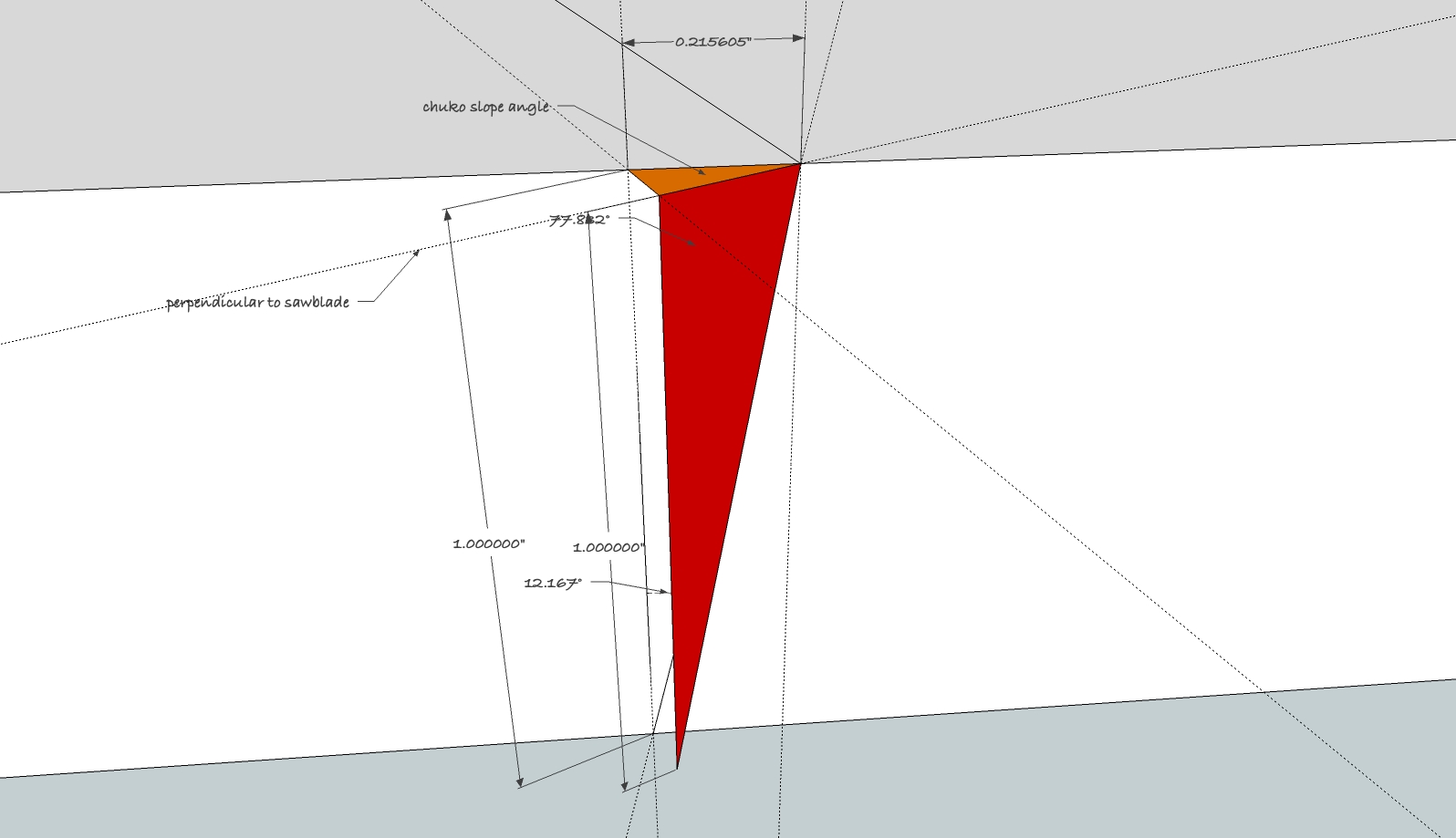

Now I'll place the appropriate triangles in there to indicate what sort of angle we would need on the sawblade. The sawblade is set perpendicular to the blade's face, and that perpendicular happens to be sloped at the chūkō angle in relation to the board edge:
sawblade angle.jpg (164.21 KiB) Viewed 77660 times
The actual sawblade angle (the red triangle in the above picture) we would need to produce the tangen butt miter on our board has an opposite that is slightly smaller than the tangen slope angle on the board edge. This makes sense, as the sawblade when set at the tangen angle, produced an overcut.
I'll leave it to you to make the button pushes on the calculator to determine what sawblade angle you need.

Well, I am certainly going to reply. This is a superb set of figures. The one "start cut.jpg" shows the essense of what happens when a tilted blade meets a skewed workpiece; the basis of all compound cuts.
