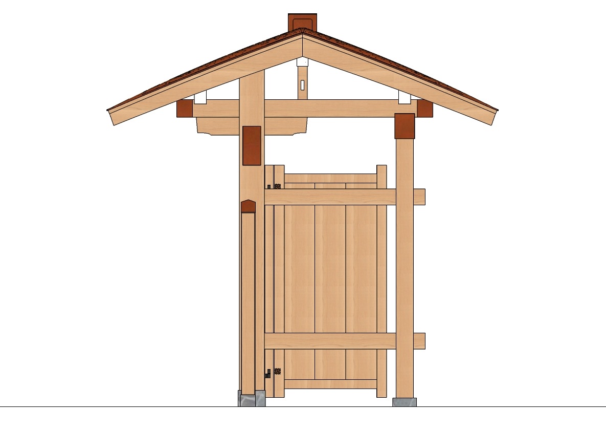

Had another meeting with MFA personnel a few days ago and learned they were open to having a 'mini-roof' over the gate. I've started some preliminary drawing work on the gate and concluded a bigger roof is better than a mini-roof, and made another case to them over an extended call over the phone about making the gate a bit more 'roofy'. I also shared a picture of a kabukimon which has had a gable roof fitted as a later 'enhancement':
It's in rough shape. I think it looks pretty good, in overall mass and arrangement is a winner, but the whole thing could be done more cleanly of course.
I am currently waiting to hear what the MFA decision is going to be, whether they'll see my point or not, and should know tomorrow. Fingers are crossed. Even if they decide against my larger roof proposal, then I will know, at least, that I tried my best to convince them in that direction. I can relax a bit as well in that the 'fall back' position if they don't like the full roof is one in which will involve using mini-roofs and enhanced flashing. Definitely are more weatherproof than a gate without them. Here's an example:
As you can see, there are cross-wise mini-roofs over the back posts and ties. The protruding posts are completely shingled with copper, and integrated with the rest of the copper shingled roof, so the weatherproof-ness should be good for a long time. The main posts are mounted clear of the ground on granite plinths, not buried into the ground some distance.
I've realized that covering both the main beam and rear support structures, door tops, etc., with mini roofs is presenting a more cluttered appearance than if a larger single roof over all the parts were used. It is normal for these kabukimon forms to be covered with extensive flashing, mini roofs, and so forth, in an effort to make them last longer in the weather and hold together for a bunch of years. The mini roofs provide protection, but on the marginal side.
Question is, given that adding all the roofs is something which adds durability, and the more of that the better in general I would say, then designing from the get-go with that idea in mind, well, it might lead one to a slightly different design conclusion about what will work best and look the best.. That's where the full roof idea comes into play.

Those mini-roofs do look like a bit of an add-on, and untidy. If I was unkind I would say it's almost a bit of a clothes-horse look. The proper roof is orders of magnitude better aesthetically to my eye, to say nothing of the improvement in longevity.

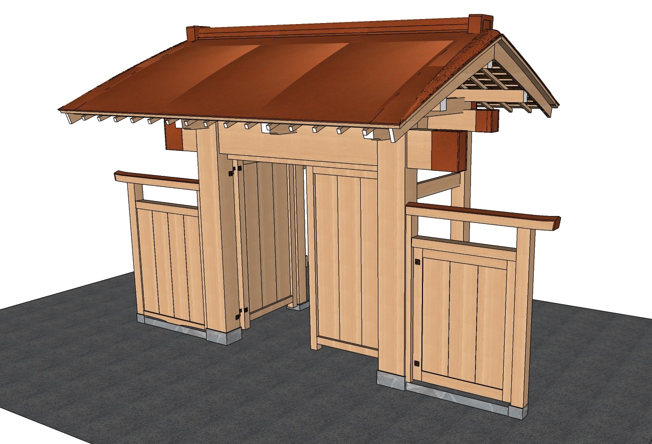

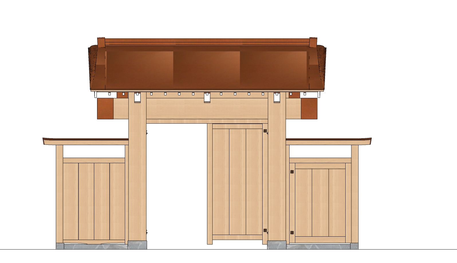

After several days of work on drawing the new gate, and then writing a new project proposal spanning 11 pages or so, I submitted my proposal to the MFA today. I am more than a little anxious to learn their decision, and made the proposal without 100% knowing all the costs down to the penny. A little guesswork involved, if you know what I mean. I worked through the design issues in light of the project goals, and settled on one form of gate which met the bill most closely.
Here are a few views of the gate I designed:
The minoko, or roll down on the eave edge, is somewhat approximate due to shortcominsg with the rendering engine in SketchUp (have I mentioned this issue before elsewhere?
). I spent about 7 hours of drawing time just drawing one gable side's minoko, which was then copied into the two sides and two gable ends where it is found.
I didn't take the time to render the copper roof shingles accurately - there is a balance point in there somewhere when it comes to deciding how much time to put into a concept sketch. I'm sure I spend more time on the concept sketch than many would, but I wanted an accurate representation of what I was proposing. Short of detailing the joinery, I was able to provide an accurate and detailed sketch for about 2.5 day's time investment.

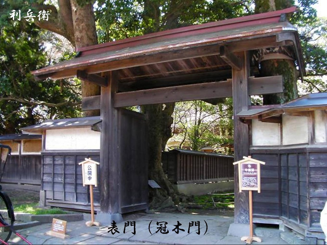

The gate style which works the best here is the yakuimon, or 'physician's gate. The core structure I chose to use, slightly not standard for this gate type, is virtually identical to the kabukimon pattern, with an off-center roof providing equal eave coverage front and rear and a reduction in the overall 'monumentality' of the roof. What do you think? Is the design a good one?
I'm really hoping they go for this - I put all my eggs in that basket. There are other gate options of course, but this one was the most ideal and hopefully is not too elaborate for them. We'll see what happens.

I think the design is excellent. While it would be sweet to see a more elaborate form, I think this would suit the location nicely. It pays homage to the existing gate without repeating its shortcomings, and should not offend the more conservative folks at the mfa.
One question about the panels flanking the gate- are they different to illustrate two options for construction, or is there something else going on there?

I appreciate your observations about the design. I did everything I could to tone things down and reduce the 'monumentality' of the structure. A typical yakuimon would have a main roof with a 6.5~7 in 10 slope, whereas the one I drew uses a 4.5/10. The different in slope between the decorative exposed roof underneath and the main roof is only 1 in 10, which makes for a small minoko. Again, tying to flatten and tone down the look. There are no carved timbers, no gable end beam coverings (gegyo), no window openings in the doors, less flashy hardware, etc., etc. If the project is approved in the next meeting, then I do intend to give the gable end barge boards a lower edge treatment and will probably add a subtle curve up to the ends of the eave at the gable end. Just a touch more 'curvy-ness' and detail. No point spending extra hours rendering that on the drawing at this stage. There's also an accessory structure involved in this project proposal, a roofed kiosk holding a wooden information sign about the garden. I will be re-doing it's foundation and repairing the rotted posts. Again, something not illustrated above.
Now I will wait and see if I have found the right mix design-wise to suit the MFA, at least those who will be making the decision.

Good eye. Yes, they are different. Looking at the front elevation, the side on the left is a board-paneled wall, while the side on the right is a small doorway. The doorway allows a MFA staffer to enter the garden and access the draw bar on the back of the two main doors so they can be opened for pedestrian traffic. Normally the side door is kept closed, so I kept it closed in the drawing.One question about the panels flanking the gate- are they different to illustrate two options for construction, or is there something else going on there?

Nicely done, Chris. Hope you get to have the fun of detailing and building it.
