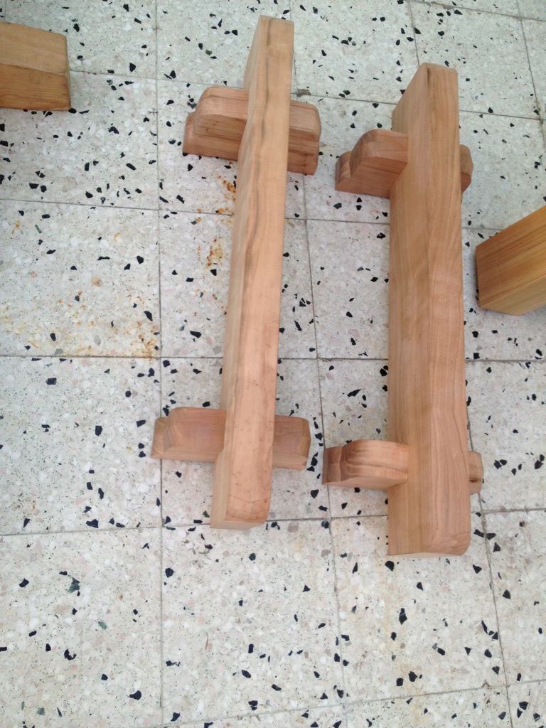

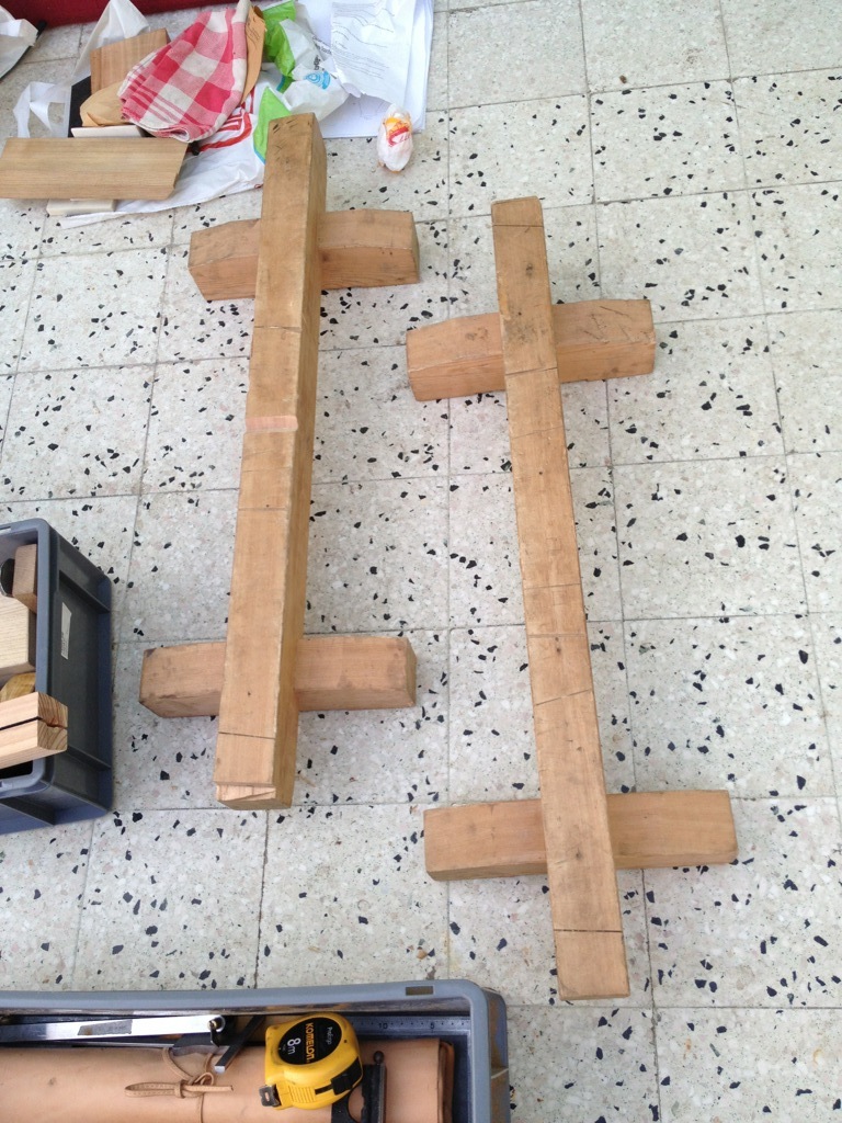

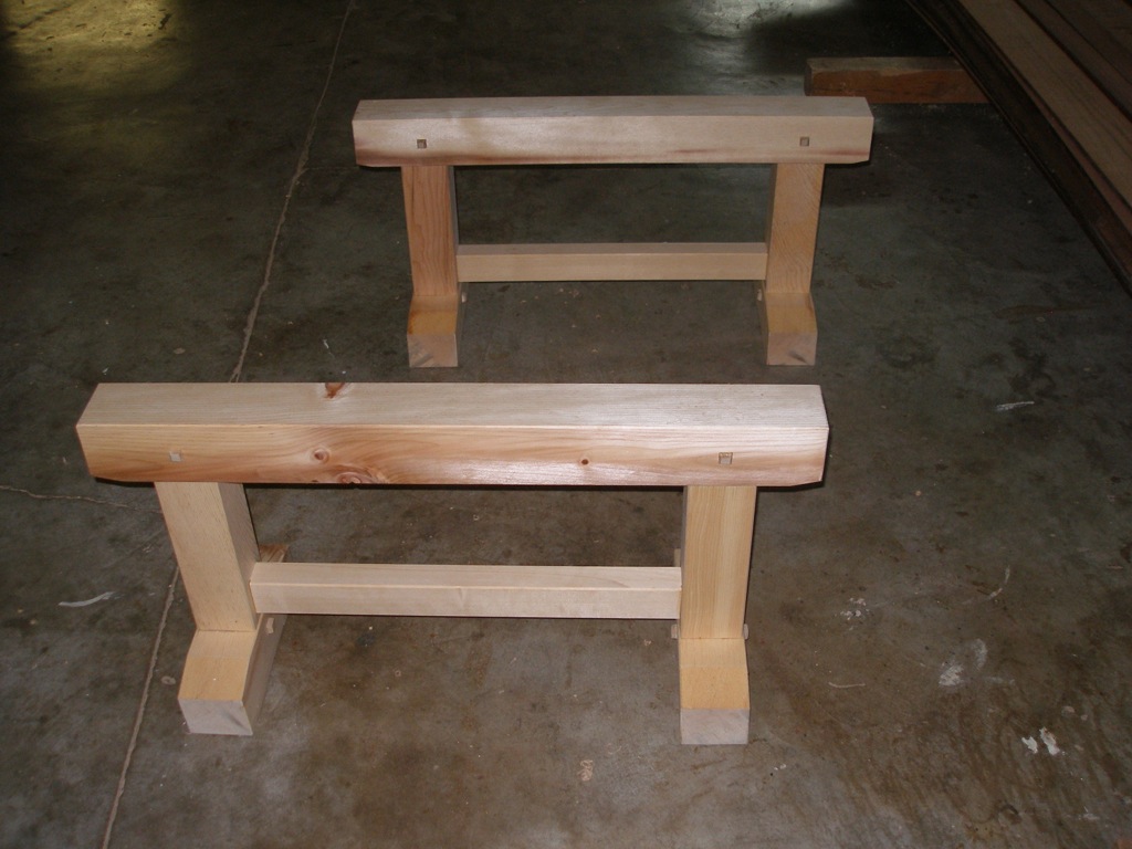

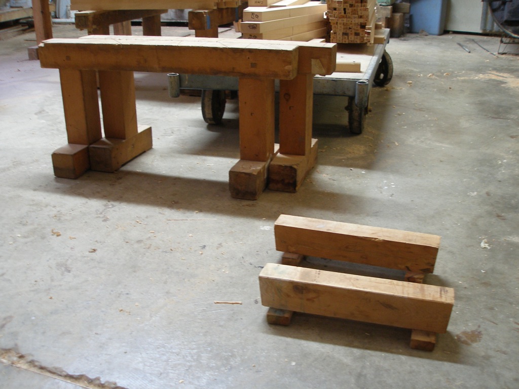

Here are some pictures of my lowest horses they are 4.5 sun or 5 sun high.
The nice ones are made of Cherry which I wouldn't recommend because it slides to easily. The disposable horses are made of Vuren/Spruce. This Spruce was particularly fine grained and a better choice then the Cherry.
Medium height horses like these could be 1.5 shaku.
And you don't have to make anything that is good looking it can be just purely functional as these.
In combination with a planing beam I find it most comfortable to use high horses. No better place to find info then here.
The planing stops of this planing beam are made of dovetail shaped pieces that where floating around the shop. I use the hole for a holdfast when working small stock. Very un-japanese.

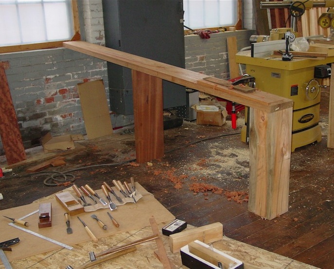

Here are a couple of photos of my workspace. My "bench", is a set of 4x6's that I have trued, but never got around to gluing up. They sit on a couple of metal sawhorses. I cut a dado on the near end that can house a stop, for planing. On the far end of my bench, sits my shooting board, as my saw cuts are not very good yet. In between are tools, waiting for me to finish my toolbox trays so they can have a home. For most joinery work, I sit on a stool next to the bench. I recently purchased a Moxon vice kit, to add more convenient work holding, especially for dovetailing.
On the other side of my garage, I have some nice machinery to assist in stock preparation (resawing, jointing, planing). The space is crowded, but I am happy just to have a dedicated space.
I intend to build a proper workbench this year. I have settled on a style using two beams with a large removable tool trough in the middle. I will probably add a face vice or leg vice, but continue to use planing stops in the rear of the bench.

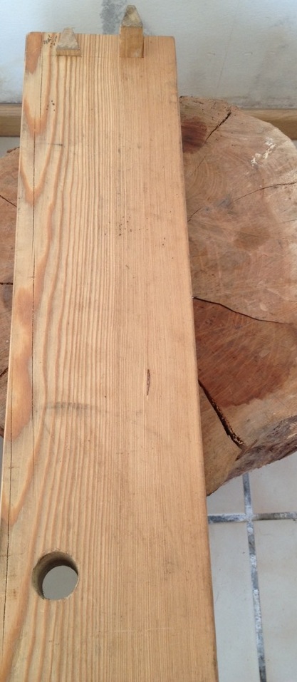

This is what I use for planing:
The beam is a 2"x9" piece of canarywood, and the post is an 8"x8" chunk of pine. I'm thinking of framing underneath the beam and putting in a nice plywood sheet with racking to hold my planes.

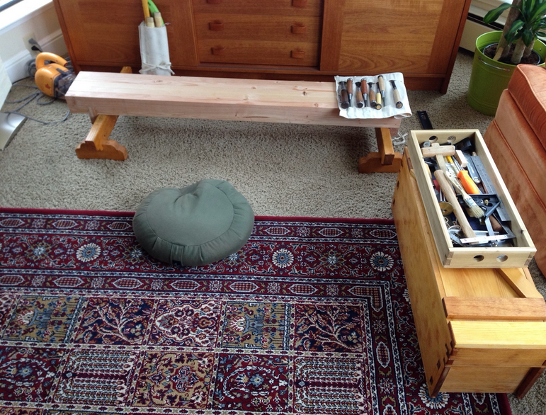

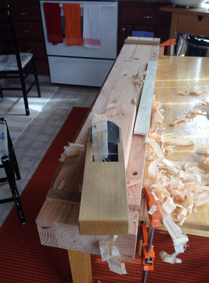

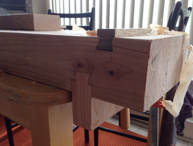

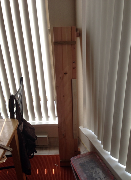

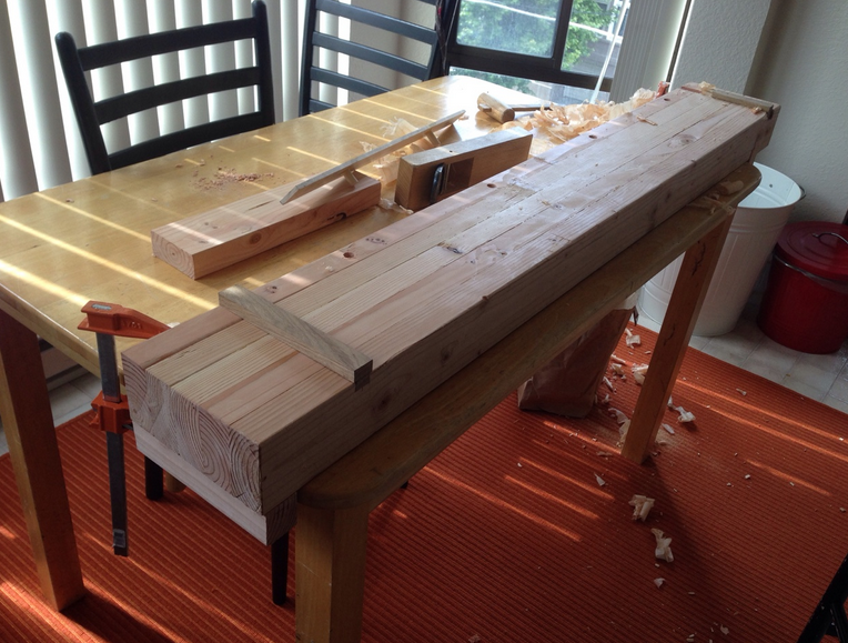

Just discovered this thread, thought I'd throw in some pictures of my own setup. Living in an apartment in San Francisco is probably one of the most constrained arrangements if you happen to like woodworking. I day dream of having a dedicated place, but like many things sometimes constraints help clarify things.
I usually work off the kitchen table (a cheap ikea thing) but the surface has sagged enough to make flattening stock problematic. So I laminated some 2x4s into a a planing beam that rests on top of the table. If I'm doing very heavy planing, I created blocks on the side where I can clamp it down.
When I'm not doing a lot of planing or sawing, I tend to try to get comfortable on the ground although my back ain't what it used to be.
