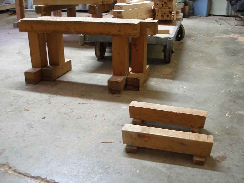

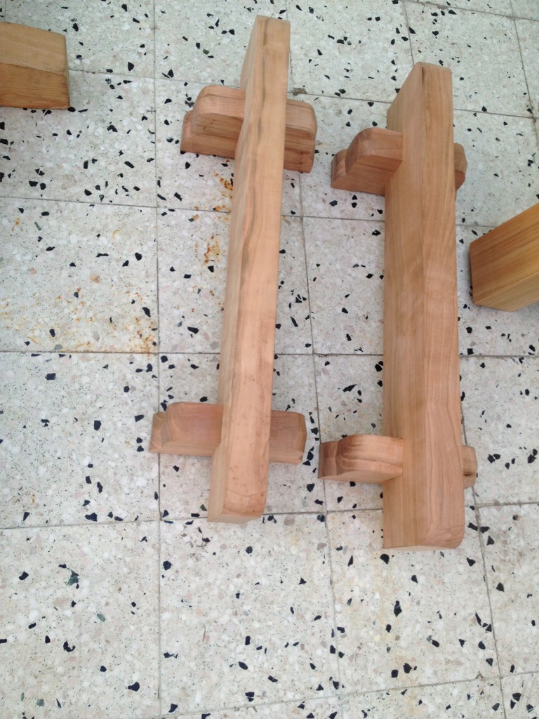

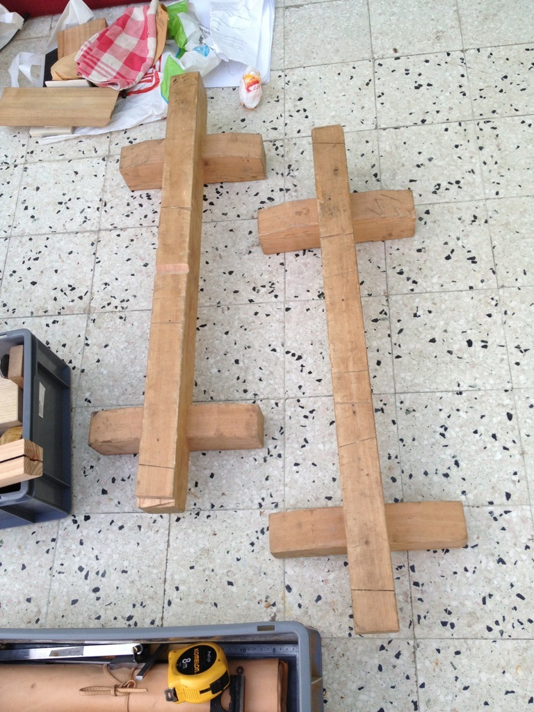

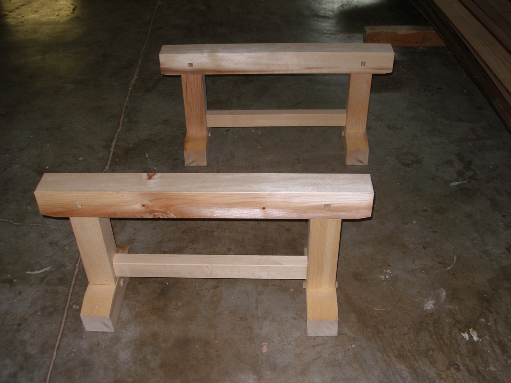

Here are some pictures of my lowest horses they are 4.5 sun or 5 sun high.
photo 2.JPG (295.2 KiB) Viewed 8272 times
photo 1.JPG (277.23 KiB) Viewed 8272 times
The nice ones are made of Cherry which I wouldn't recommend because it slides to easily. The disposable horses are made of Vuren/Spruce. This Spruce was particularly fine grained and a better choice then the Cherry.
Medium height horses like these could be 1.5 shaku.
And you don't have to make anything that is good looking it can be just purely functional as these.
In combination with a planing beam I find it most comfortable to use high horses. No better place to find info then here.
The planing stops of this planing beam are made of dovetail shaped pieces that where floating around the shop. I use the hole for a holdfast when working small stock. Very un-japanese.
A thick solid slab on small feet with planing stops is often used in Japan. I have seen some dai makers and they all have there setup customized to their own preferences. One of them, Inomoto, used a small pivoting stick to clamp dai to the planing stop with one foot. This was a very efficient and fast way of clamping.

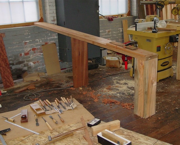

Here are a couple of photos of my workspace. My "bench", is a set of 4x6's that I have trued, but never got around to gluing up. They sit on a couple of metal sawhorses. I cut a dado on the near end that can house a stop, for planing. On the far end of my bench, sits my shooting board, as my saw cuts are not very good yet. In between are tools, waiting for me to finish my toolbox trays so they can have a home. For most joinery work, I sit on a stool next to the bench. I recently purchased a Moxon vice kit, to add more convenient work holding, especially for dovetailing.
On the other side of my garage, I have some nice machinery to assist in stock preparation (resawing, jointing, planing). The space is crowded, but I am happy just to have a dedicated space.
I intend to build a proper workbench this year. I have settled on a style using two beams with a large removable tool trough in the middle. I will probably add a face vice or leg vice, but continue to use planing stops in the rear of the bench.
Juryaan, you are some pictures be interested in...
The first I grab of a blog somewhere, showing a woodworking classroom setting.
Next is an onsite planing beam from the Takenaka Carpentry Tool Museum in Kobe.
Last is a scene from the Edo-Tokyo Metropolitan Museum.
Youtube has lots of interesting videos on Japanese carpentry and woodworking. You will see that workbench styles can be quite varied.

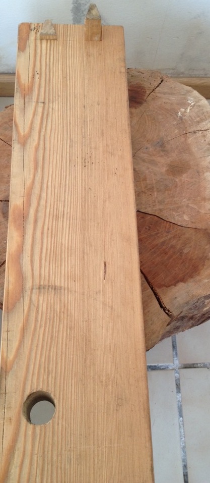

This is what I use for planing:
planing beam.jpg (144.87 KiB) Viewed 8254 times
The beam is a 2"x9" piece of canarywood, and the post is an 8"x8" chunk of pine. I'm thinking of framing underneath the beam and putting in a nice plywood sheet with racking to hold my planes.
Otherwise, I have a pair of sawhorses that use for work. Easy to move around, easy to clamp things to, and with the addition of a plank or two on top, become a bench in short order. I've thought about making a fancier bench plenty of times but I keep finding the sawhorse arrangement very practical.
