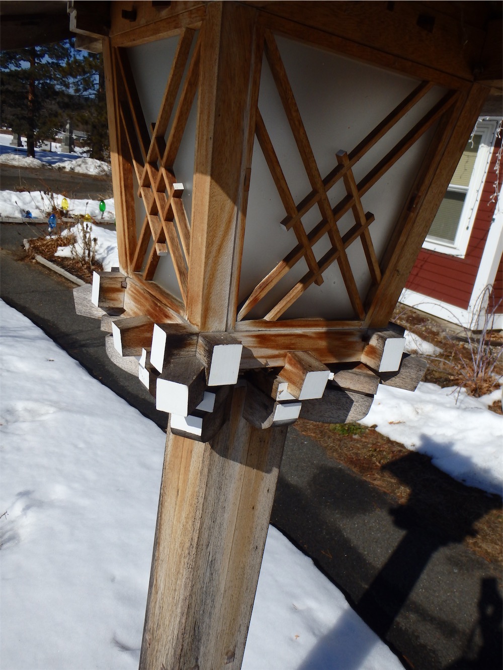

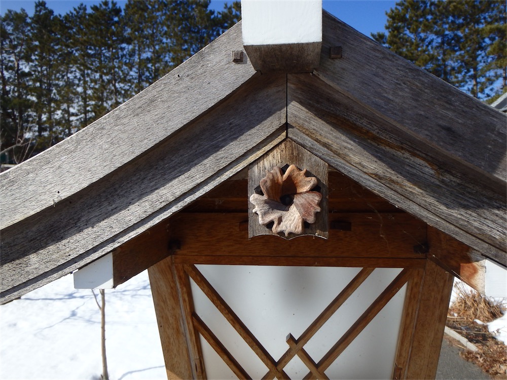

And some shots of the mahogany lantern in the front yard, a location always in full sun. It's been standing there now for 4 years:
There is a cracked piece on one of the frame members under the roof, but i think this may have been mechanical injury from one of the kids in the neighborhood, not from movement otherwise:
Not a crack, not a check. It's remarkable really.
These two thinner boards on the roof, always in direct sun, are the most shrunken, but again, no splitting or checking:
Real mahogany is surely the king of woods. I have the highest respect for it. Easy to work, super stable and durable,, and useable indoors or out. If I were to make this lantern again (and i'm planning a second one), I'd sheathe the roof in copper and it then ought to last a very long time indeed.
