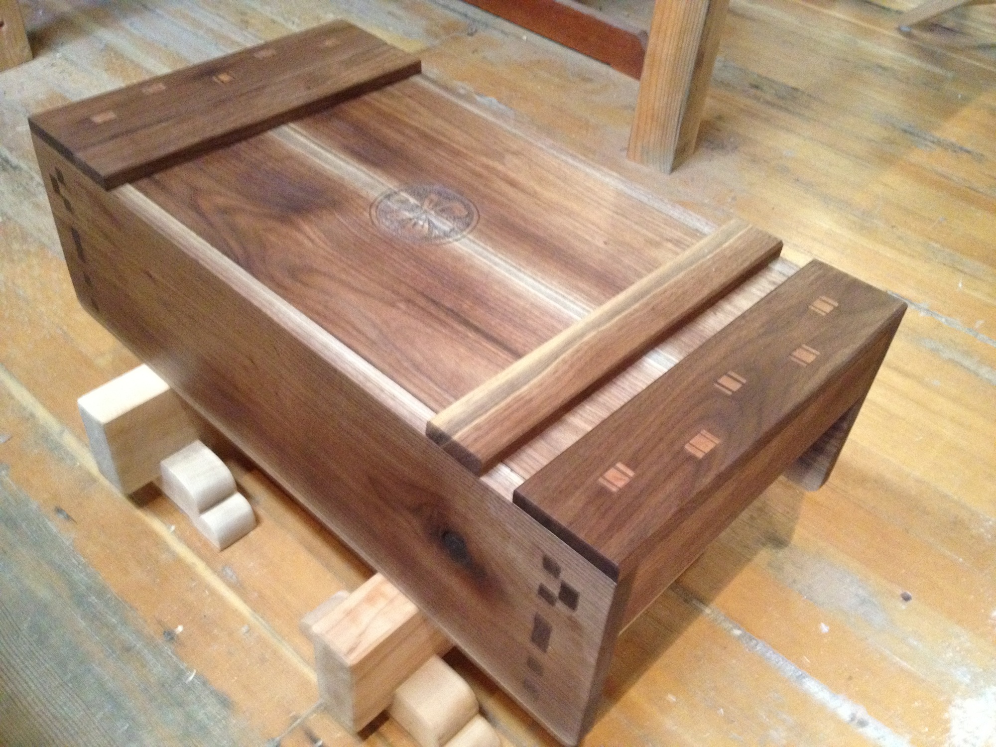

Here's my walnut toolbox:
I eliminated the interior partitions to allow room for long saws I want to put in the bottom. (Yes, the top of the sides are slightly curving inward already.)
For fear of wedges I glued the through tenons to the sides.
For fear of hell tenons I glued 8/10ths of the cherry keys on the bottom, but wedged the tops. I did do the two center tenons in the hellacious manner, and it worked well. I signified these by using ebony wedges, instead of walnut, which I used on the others.
I put an application of walnut oil on it and probably will leave it at that.

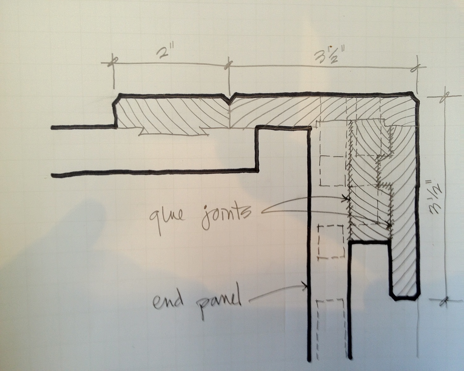

I didn't have stock wide enough to do the handle the way you did it, so I laminated some thinner pieces.
Here's a sketch:

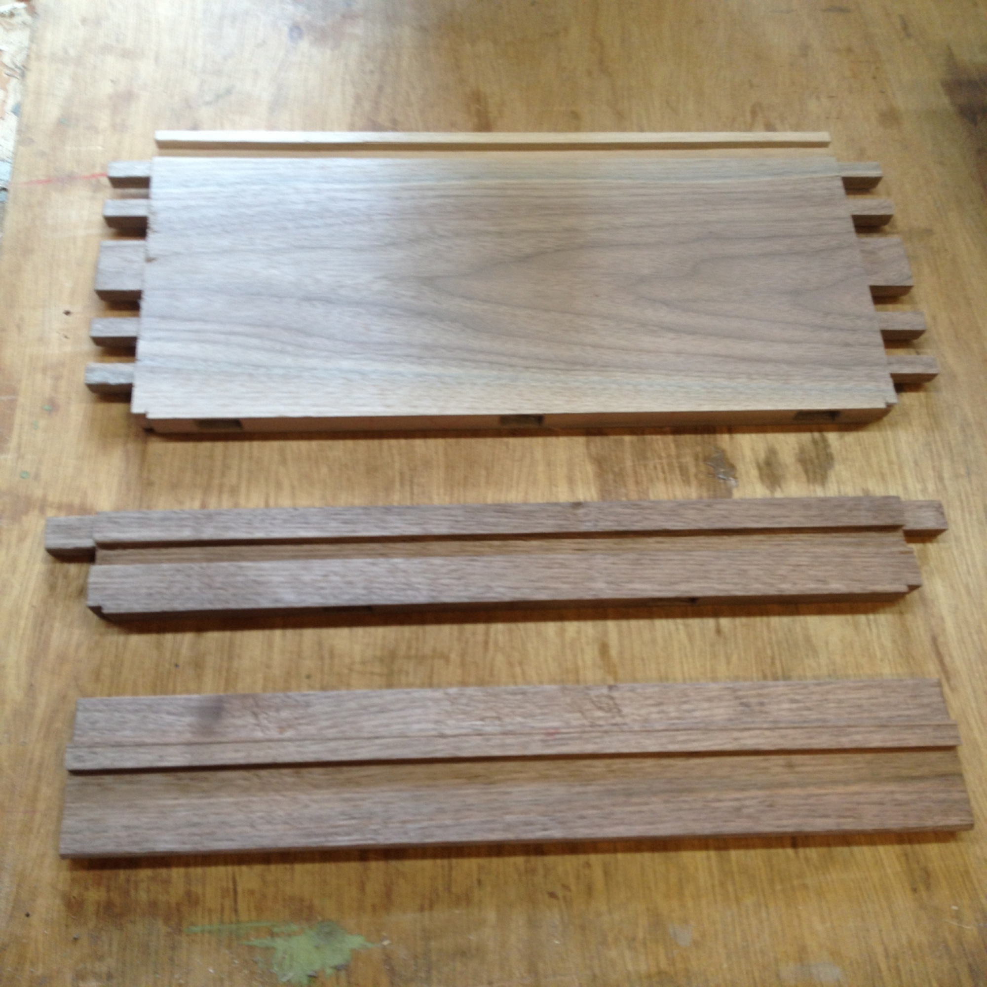

And here are the parts:

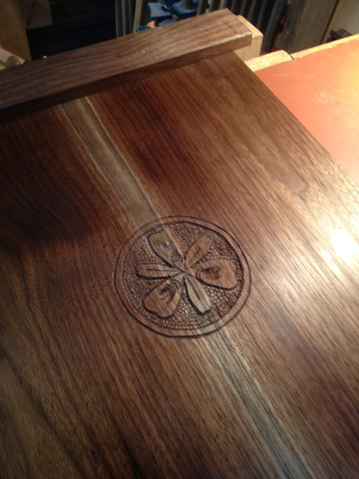

A little bit of carving on the top:
I screwed rails to the side and dropped the ends of the tray 1/4" below it's sides to hold it in place and used what I have been told is a katagi sakuri kanna for the sliding dovetail:
After initial planing to rough thickness, no machines were used in the making of this toolbox.
With apologies for the photo quality.

That's a nice looking toolbox. Congratulations!

Charlie - outstanding work!! I was really pleased to see your finished piece and think it came out really well. Clean execution and I'm sure your work will inspire other members here.
