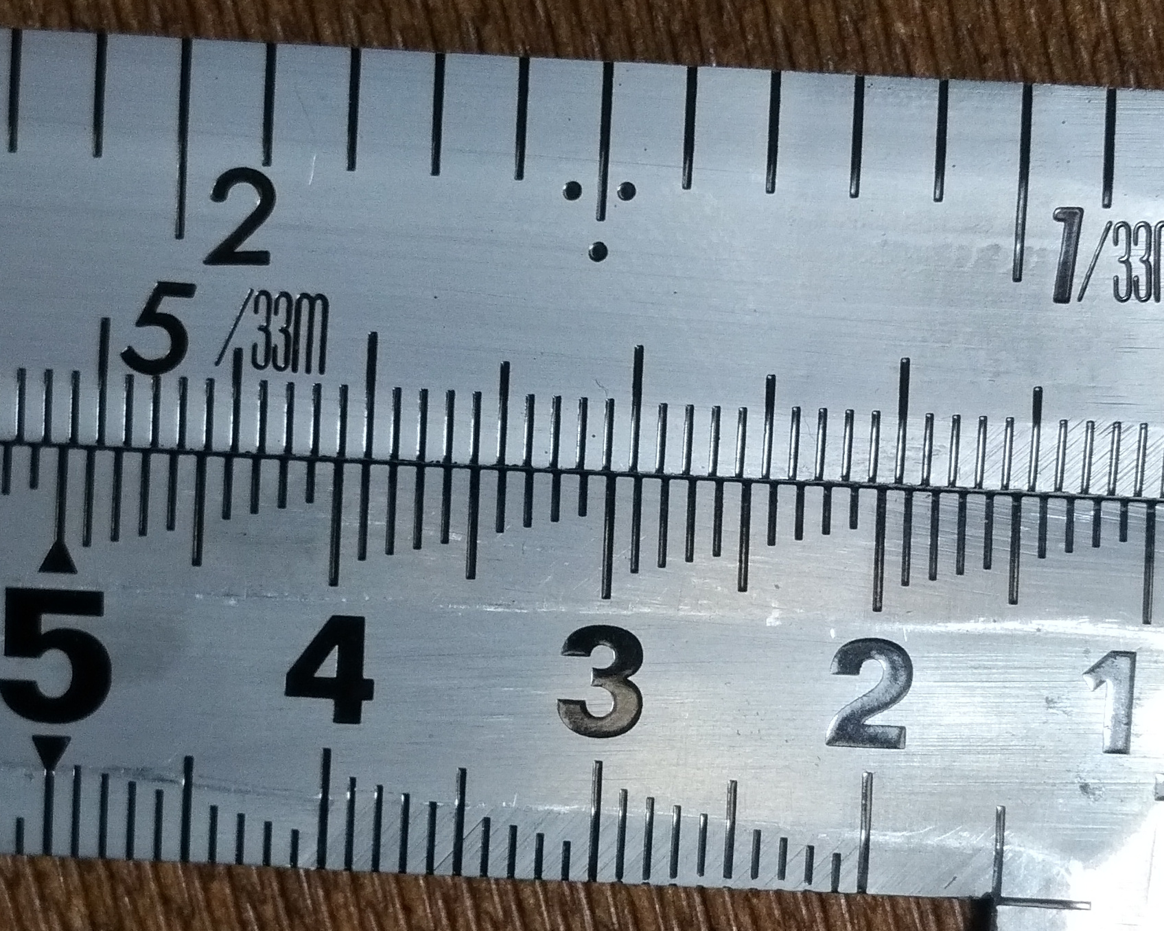

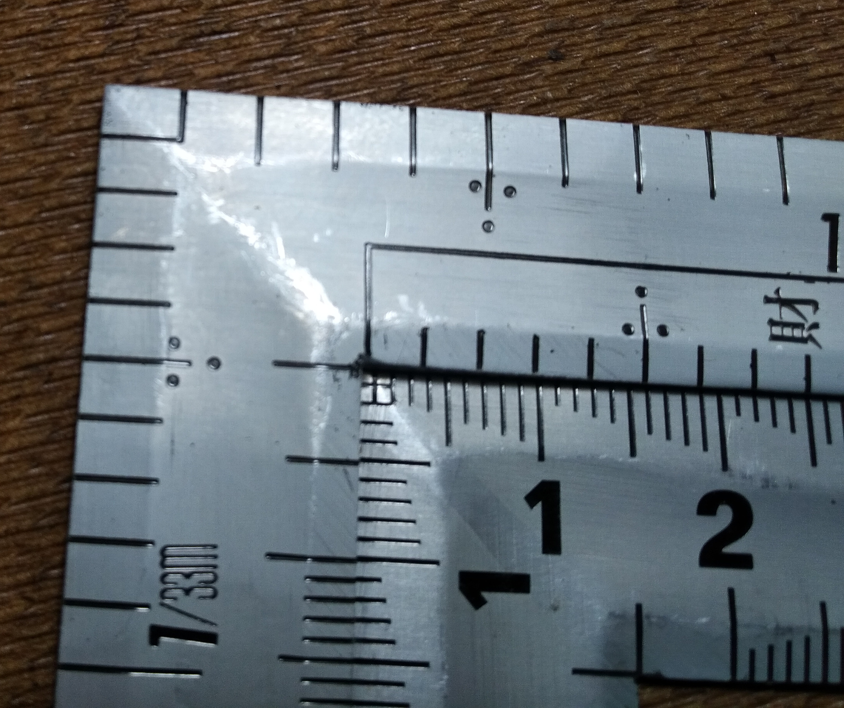

I just received two sashigane from Japan. One each of shaku and cm scales.
the root 2 side of the shaku sashigane isnt quite what I expected. The long arm is correct, but the short arm appears to be the same on both sides.
Note how the first scale marks do not form a square as would be expected if they were the same scale. Shouldn't both arms be root two larger?
IMG_20170119_1601274 small.jpg (841.31 KiB) Viewed 30249 times
the metric scale on the short arm of the shaku shashigane is also incorrect. compare the 5cm mark on the metric square to the 5cm mark on the shaku square. its about 1.3mm short over 5cm. Is there a reason why this would be correct?
IMG_20170119_1601179 small.jpg (859.96 KiB) Viewed 30249 times
is the shaku sashigane just messed up?
No, only the ura side of the long arm will have the √2 scale markings. If both short and long arms had √2 markings, you would not be able to use the sashigane to lay out regular hip rafter slope lines; i.e., if the common slope were 5/10, then the hip slope would be 5/(10√2). After all, the hip rafter triangle has the same rise as the common.
The metric scale on the short arm of the shaku shashigane is also incorrect. compare the 5cm mark on the metric square to the 5cm mark on the shaku square. its about 1.3mm short over 5cm. Is there a reason why this would be correct?
The lower scale on the backside of the short arms of the shaku-measure sashigane looks to have a maru-me scale, which tells you the circumference of an object by measuring its diameter. The shaku-measure sashigane does not have any metric markings on it.

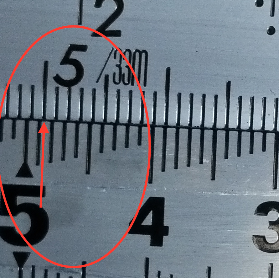

To explain the maru-me scale a little more using the comparison of the two framing squares, I attach the following annotated close-up:
IMG_20170119_1601179 small.jpg (326.85 KiB) Viewed 30244 times
Notice that the mark of '5' on the upper sashigane corresponds to a measure on the lower framing square of a bit more than 4.8 - - actually it is exactly 4.8223 cm (I can calculate that value by working backwards - it's not a guess on my part).
To obtain a circumference, we multiply diameter by π. So, take 4.8223cm * π = 15.15cm.
Now, in the Japanese traditional system, 1-sun is equal to 3.03cm, so if we divide the above 15.15cm by 3.03, we obtain a value of, drum roll please, 5-sun. That's why 4.8223cm on the metric square would correspond to a mark of 5-sun on the maru-me scale on the traditional measure square.
Hope that makes good sense.
