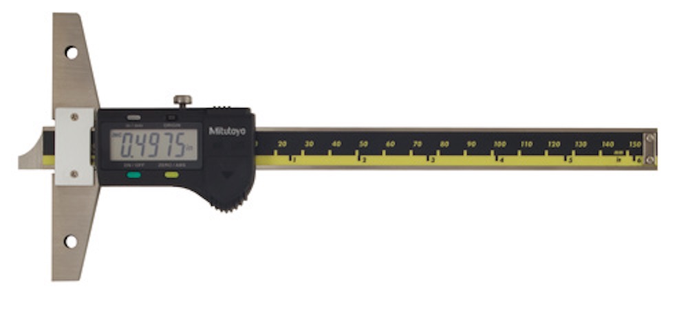

For depth gauging only, there is also the Mitutoyo product:

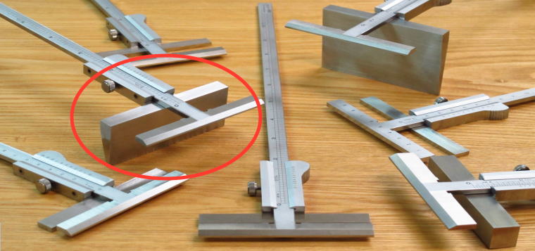

Well, given time to ponder the matter further, I succumbed to the pressure and have become more interested in getting one of these Matsui gages. Lord, I am weak.
I put in a mail to Mandara-ya to ask about pricing and availability for the model circled below:

That pup's 31000円. They call it a 'column' gage.

Good news: Looking at the parts list, it looks like that Mitutoyo depth gage might be able to be converted to a Kegakigeji - you'd have to make some fences and bolt them up square and parallel.. Not easy, mind you, but not impossible. You would end up with a scribing gage that give you inch/metric conversion, floating zero points, and data recording, not to mention.. it's attached to a digital depth gage!
Bad news: even before having to make the fences, that tool is about $460 for a 12"/300mm version. :(
