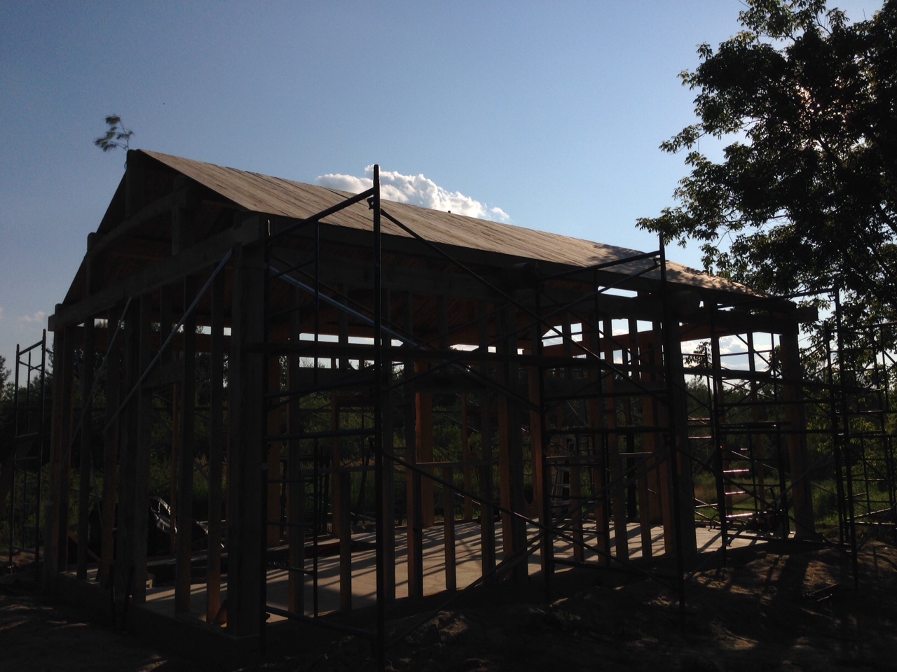

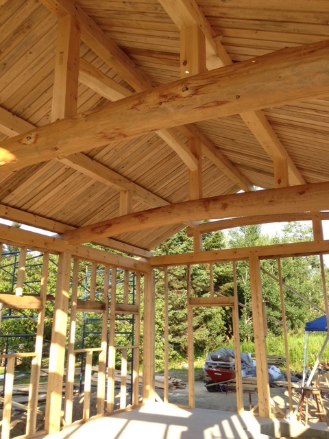

Well, our frame is up. The simplified timber frame was a bit awkward to raise at first, as there were no horizontal members before the 10 feet high main beams... We had to raise the basic square (rectangle...) and then directly install the also simplified stick framing and temporary bracing in order to add the roof. Things went well, the raising of the crooked beams was done with a "trepied", a very simple tripod holding a chain block. The rest was done by hand, as the largest beams were 6x8 and not too long. The structure is not perfectly sturdy along the 30 feet wall, since there is no inside wall to stop it from bending. We didn't want diagonal bracing or posts inside, so we'll have to live with it. I guess closing the walls will help a lot, and it's not that bad at all, but... we'll see!
Hempcrete will start in 7 days. I will let you know how it goes.

Thanks Chris.
I just tried to make the second picture smaller but I get a "no access to this file" message... It doesn't bother me if it doesn't bother you!
No bracing in the walls since any horizontal member is a pain in the neck for hempcrete (!), and because the hempcrete itself is more that adequate bracing. No bracing inside the building (hope I'm clear), where we would need some now, for aesthetics reasons only.
I've never built a house before so I don't know what is ok and what is not in that regard. It might not be a problem at all. If it is though, we will probably have to add some members, wich is not very nice.
