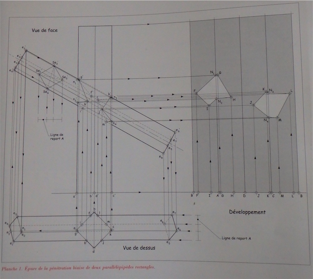

After the study of cylinders and cones, etc., I finally arrived at Plate 1, a study of a square section stick passing through a larger square section stick. The smaller stick is offset from the centerline of the larger stick and axially rotated at an arbitrary angle.
The problem shown relates to the 'X Marks the Spot' problem in some respects:
On the right of the picture is the objective, an unfolded view of the larger stick with the mortises marked out. The method, as drawn, does NOT produce a correct map of the mortise on the larger stick.
I drew it in Sketchup, following the 2D development in the text until I produced the view of the 4 faces of the larger stick. Then I rotated the panel up and folded it (like it were paper) into a stick. Then connected the lines within and checked out the result. It was not a mortise for a square-sectioned stick, but a skewed section, nor were the mortise dimensions correct in either axis.
Thinking initially that I had misunderstood something, I drew it all again, with the same result. Then I decided to reverse-engineer, from 3D back into 2D. In the end I figured out that the text shows an incorrect method, and this morning I have determined exactly what their mistake was. The drawing is 99% correct otherwise, but that one small mistake causes the unfolded view of the post mortises to come out utterly wrong.
Can you also find the mistake?
And, given that this is a Compagnons du Devoir official textbook on the topic, and it is plate 1 in the text, the first principal study, and that the drawings in the book were likely done by CAD anyhow - - how to account for this error in the book? Surely they are not making deliberate mistakes to confuse people....

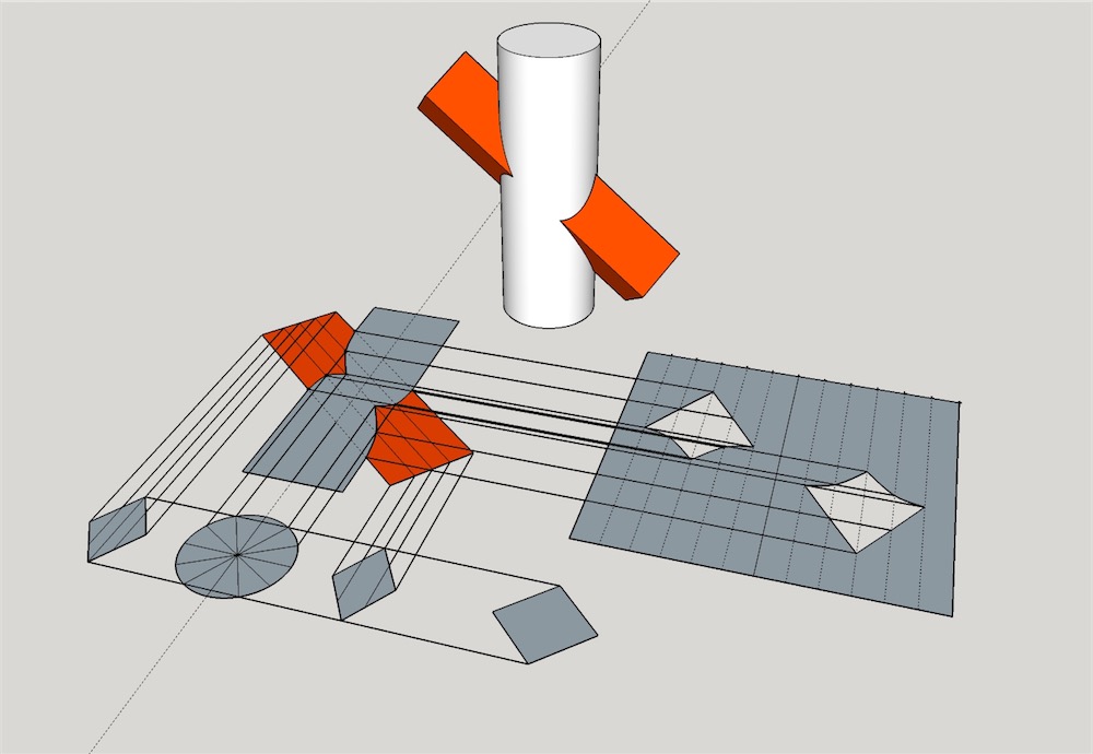

Planche 2 was correct. This is the layout of mortises on a cylinder to allow a square stick on slope, with arrises rotated to 45˚, to pass through:
Though it would be perhaps more complicated to cut out than the preceding example, it was easier to lay out.

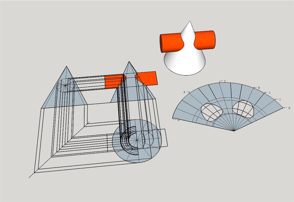

I've moved along a good ways in this section, completing another three studies. Here's one of them:
Next up is an angled cylinder passing, but not completely contained within, a cone. Then it is a horizontal cone penetrating a vertical cone, and then cone and sphere intersecting, and the section will be compete.

I was on the verge to say: There is no mistake!
But I hold my tongue and stared at the picture again.
Finally I spotted the mistake.
They mixed up the upper and lower arris while they transfer them from elevation view to plan view.
The horizontal measure from the cross section of the stick that passes through. (Ligne de report A)

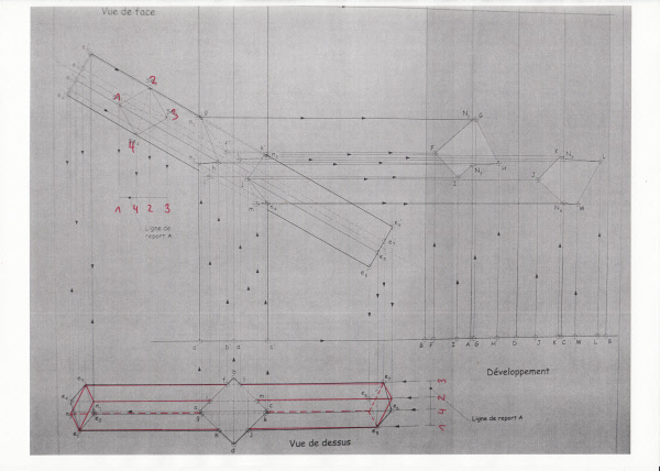

I didn't find the time to draw it so far, but the puzzle kept bothering me.Chris Hall wrote:Can you also find the mistake?
You got me with the book, a few days ago I ordered my copy.

That's not quite it, if I understand you correctly, however the problem does indeed lie with 'Ligne de Report A'. The way they projected it is wrong and it leads to a plan view of the stick which is not the correct width. From there, all the projections involving that section will be erroneous.Marc wrote:

Re: An investigation Begins
I think we both mean the same, but thanks to my poor English I was not able to explain it well enough.
So, a picture is worth a thousand words.
I numbered the corners/arrises of the stick (cross section) in elevation view and brought the horizontal measurements between these points with my "story pole" (Ligne de report A) to plan view. It is there where the mistake happend. In the original they confound number 2 and 4.
In my sketch I outlined the arrises of the stick (red colour) to show how it would look like in plan view if they hadn't made the fault.
Better now?
Better now?
