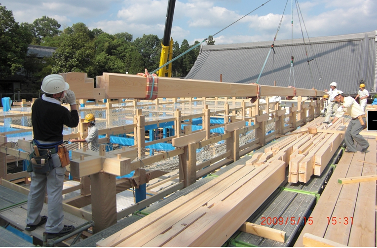

Posted: Fri Feb 27, 2015 6:38 pm
It's a question of rigging;
I suppose how much wood was removed in cutting the bevel would affect how much the joint is compromised. For instance, if the entire width of the purlin were beveled and the roof pitch were steep, a lot of meat would be removed. On the other hand if only a third of the width of the purlin/ridge were beveled and the pitch were around 4 or 5 in 12, as I am considering, much of the keys of the kanawa-tsugi could be avoided.
You didn't specify the rafter pitch in your original post, so, given the use of Japanese joinery I wasn't envisioning a steep slope. Your assumption is correct: a steeply pitched rafter will remove a lot of meat from a supporting purlin. In such cases the normal solution is to raise the HAP (Height Above Plate), so that the rafter's lower surface does not meet the centerline of the purlin, but is raised some distance above.
Re: Splicing Purlins and Ridge Beam
Posted: Sat Feb 28, 2015 1:16 am
by Lonnie
That's a great photo. I was trying to imagine that so It's helpful to see it for real.
My purlin/ridge dimensions will actually be 7.5" x 9" rather than 8" x 9.5" (I had rough dimensions in mind). I think I'll build a model joint and try and find a good HAP and bevel angle that work well with the splice.
