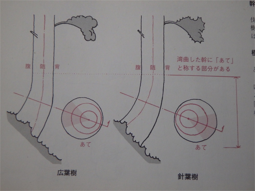

Then there is the difference between deciduous and coniferous trees and how they apportion tissue around bowed areas, as this picture from a Japanese book of mine shows:
Deciduous tree on the left, conifer on the right. The location of the pith is reversed in each. The same effect is seen with branches which come out of the trunk laterally I believe. I asked a tree scientist at University of Massachusetts - Bruce Hoadley - about this and why it was reversed between the two tree types and he said science did not have a conclusive answer for that yet. Text elsewhere in the book indicates that coniferous trees have a higher amount of lignin. It appears to me that cellular structural factors account for the difference; it seems that conifers apportion more tissue to the portion of the trunk under compression, while broad leaf trees place more of it in the portion under tension.

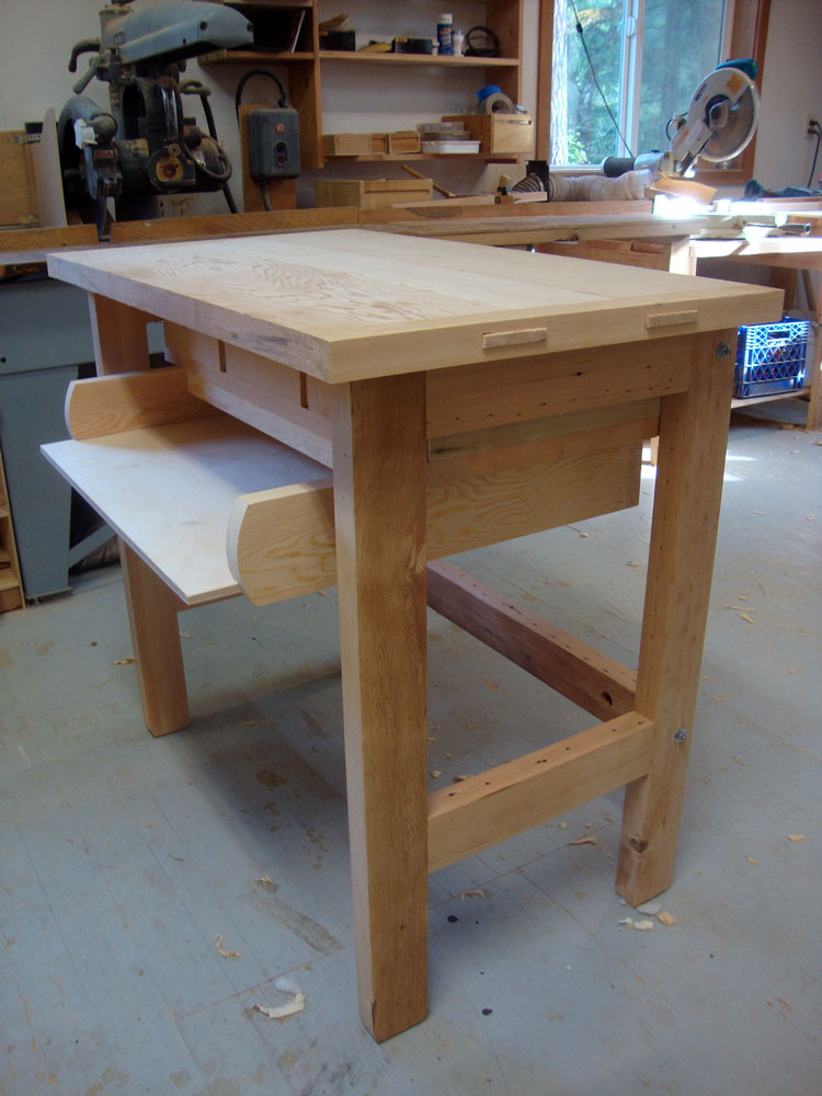

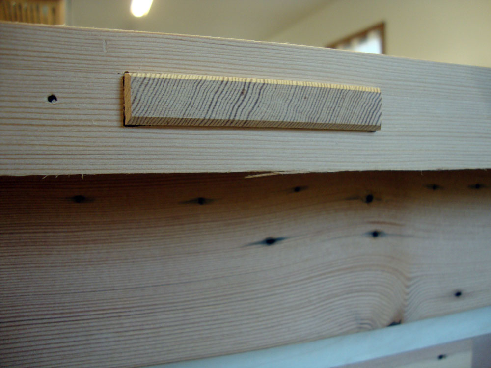

I had a chance to use a breadboard end on a project recently, a jewelers bench made of re-claimed Douglas fir. The truth is I have been itching to try this joint for a while now. The total width was around 22 inches. The wood was bone dry - the nice thing about reclaimed wood, air dried slowly over time.
The tenons are not wedged - the gut feeling was with this reclaimed material there might be splitting, so the tenons were just glued. The rest of the joint is not glued, hopefully this will allow for movement.
The nature of this bench is a little rough, so I did not consider a mitered end. I did consider stopping the grove short of the end, but just ran it full length. A little stronger that way.
Time will tell how she holds up. It was fun anyway!
