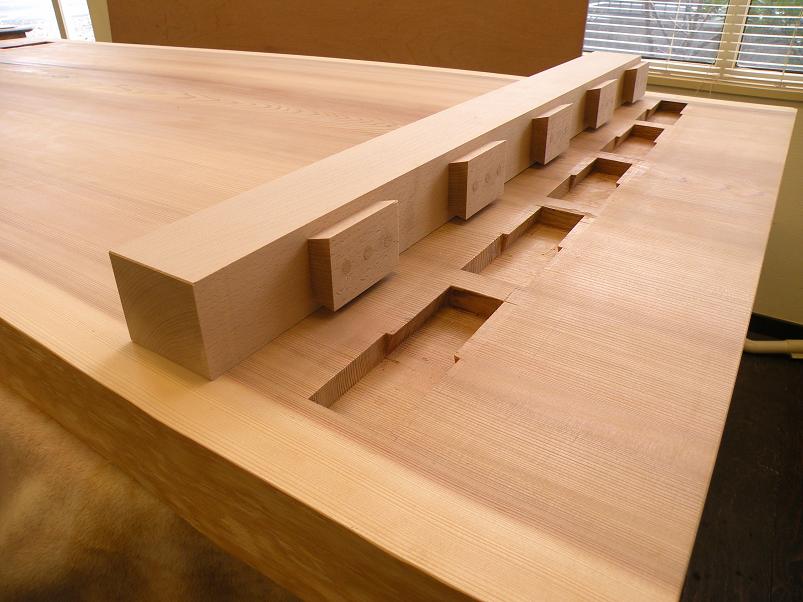

Here's a cleanly done version of the batten with multiple sliding concealed dovetail, connecting to a waney-edge table top slab - it looks like it is a glued dovetail piece with cross-doweling, though it may be machined from one piece as well - hard to tell:
It seems like too many dovetail keys to me. Maybe three would be better.
I would use floating keys, and go one step further and employ floating double hammer head keys, if the top was thick enough.

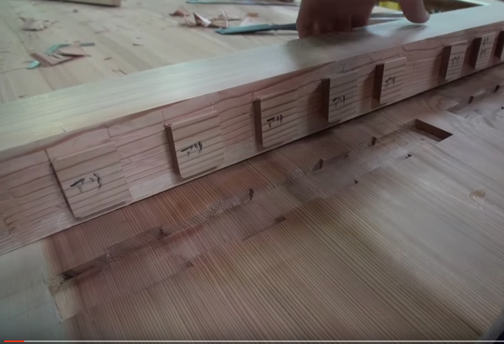

Here's another approach:
Another type of sliding dovetail.jpg (495.18 KiB) Viewed 25606 times
I believe the line of dovetails is tapered slightly as well. An elegant solution in some respects, however the dovetail males themselves are, I have found, vulnerable to snapping off if the joint fit is too tight - -though in a softwood it will probably be just fine.
