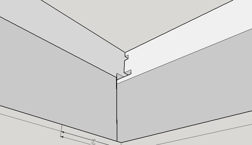

It seems like I'm doing more designing than making these days, but I'm also restoring a bunch of vintage woodworking machinery so I see some glorious building days ahead... In any case, I've been trying to understand the joint Chris used in the Vanity series and I have a couple questions.
Here's my sketch-up of the joint, playing with different amounts of overlap on the top and bottom:

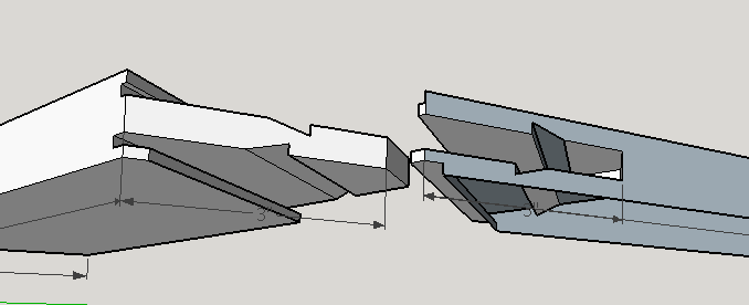

Here's the back side:
mitered corner back side.png (11.94 KiB) Viewed 33427 times
I think these open sections on the back are simply part of the joint - but maybe I'm missing something obvious?
I suppose the mitered cuts could be done in a way (slightly more than 45 degrees) so that all the lines would hit that back corner, leaving no open sections, but that seems like a lot of work. I suspect that a 45 degree miter is used and if the back surface needs to be flush, then the part can be made wide and then the back edge ripped to dimension.
Does the above seem correct?
Re: mitered corner lap joint
Sat Jul 25, 2015 12:21 pm
Hah! Where were you for the last joinery study project? We covered a very similar joint...
Yes, for a 90˚ corner, a 45˚ miter line would be the usual choice. Your miter on the underside is offset, which causes part of the problem on the inside edge - the rest is that you ran the tongues right through instead of stopped.

With the right jigging, I think it might lend itself to a table saw construction, e.g., 1/8" blade could make all the cuts for a make a 7/8" thick frame. In theory, it could be pretty fast if all of the miters/laps were through cuts. Hmm...

I believe you will find that hand tools will dominate the cutout in this joint and most of its variants. I like the idea of the table saw jig, but fear of will never attain the necessary tolerances to execute this joint properly. Also 7/8 " ? Thats alot going on for such a small area, I've found even 1.5" material to be tricky with mitered box joint variants ive tried since tackling the model joint. Keep playing with the 3d model and look for the post from Chris's blog detailing the shachi sen. I think unless I'm mis interpreting the model you posted you overlooked one or two details about the trenches that will prove helpful come fitment of the wedges. Keep up the good work!

Hmm, but is it something to do with compound layout to make the tapered shachi sen fit securely (which was touched on in volume 3 in a splicing application)?
Sun Jul 26, 2015 8:49 am
Yes, that section on shachi sen in Volume III touches on the same topic, however it is a little more complicated with the right-angled joint due to the fact that the pin enters at a 45˚ angle in plan.
