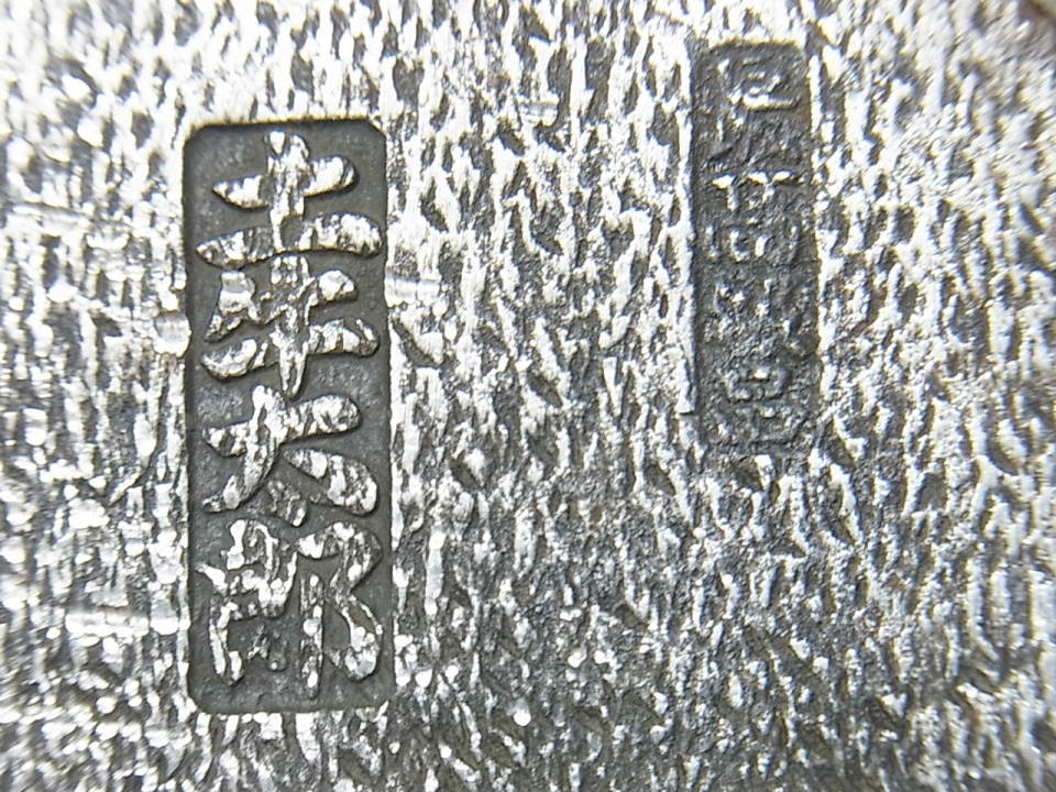

Daruma wrote: ↑
Tue Oct 31, 2017 12:33 am
Gadge,
Found out a bit more on blade #1
The kanji on the left reads 桜人作 Translates to "made by о̄jin"
桜人 literally "cherry tree person"
作 read "saku" which means made in/by
The center kanji 花之助 is more than likely read "hana no suke" which again is probably a name.
The most interesting tid bit is the small hiragana on the right side which is read "tenka ichi"
Here is the translation:
てんかいち
天下一
Noun
1. unique thing; best on earth​
For the maker to make such a proclamation either means he was very proud of that blade or just plain arrogant..... but I would guess at the former.
Could be a real jewel......
I for one am not sold on that reading of the first character on that blade, but am not sure what it is otherwise. I've never seen the name 'Hana no Suke', or 'Fuji no Suke'

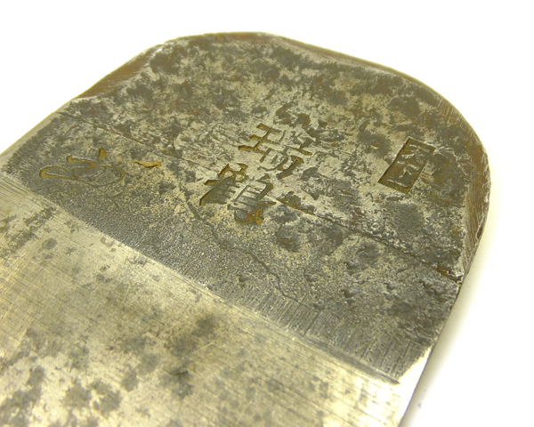

The blade is, to me, a factory made piece by an anonymous worker, hence the 'signing' by a name nobody actually has, vis 桜人 literally "cherry tree person". That goes along with the stamping of 'Tenkaichi", which, if it were a blade with a smith's real name on it would be bragging - but with the 'Mr. Cherry Tree Person' making it, you can get away with such hyperbole. There are other blades out there with the same stamping, like this one:

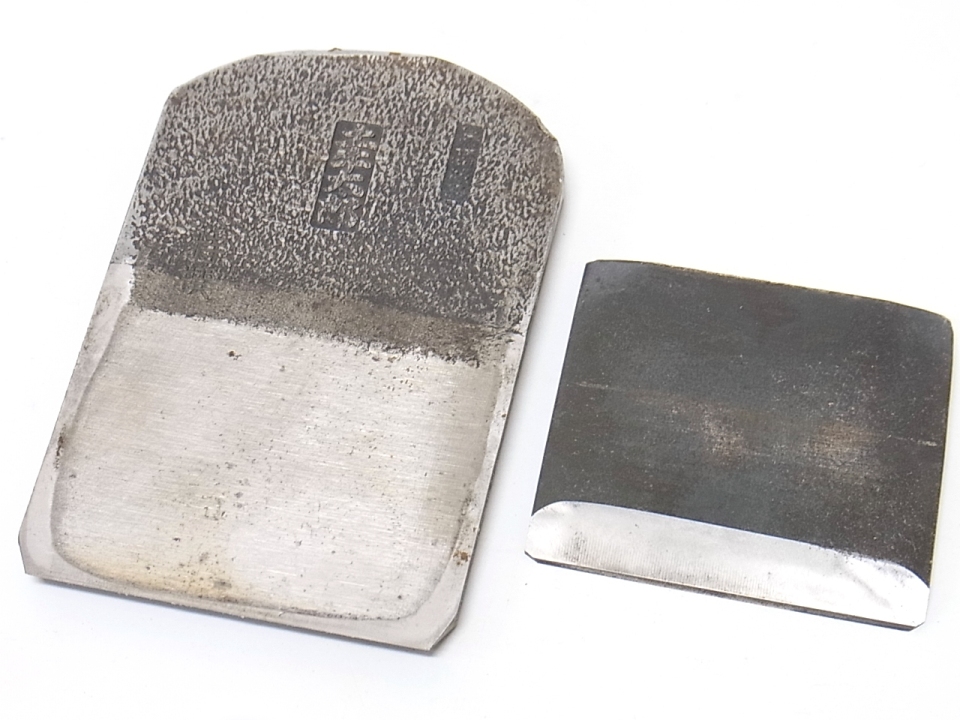

In a similar vein would be appending the term Saikо̄kyūhin 最高級品 (lit. the very best goods) to many products, including plane blades like this one by Dogyū:
A close up:
It could still be a real jewel, however I suspect it is rather more a run of the (factory) mill piece. Not aiming to run it down Gadge, just assessing it as best I can based on what I see.
