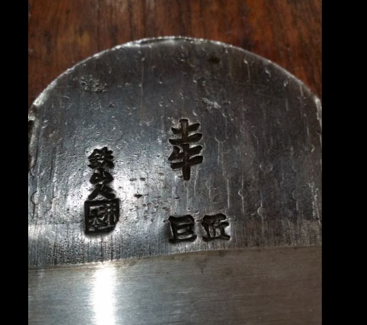

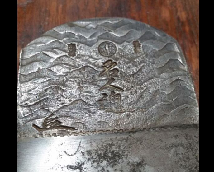

Below are photos of blades. Hope you can identify some or all. I was able to get the name Dogu from blade 5.
Blade 5.JPG (69.43 KiB) Viewed 23003 times

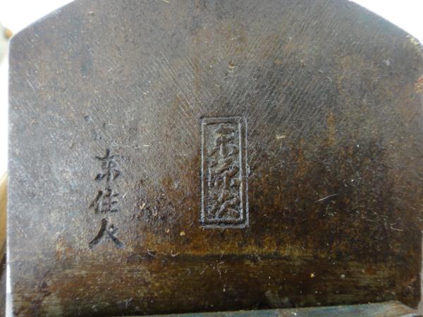

Two more. I wasn't able to attach more than 5 to the first post.
Blade 7.JPG (80.79 KiB) Viewed 23003 times
Blade 6.JPG (80.38 KiB) Viewed 23003 times

Gadge wrote: ↑
Sun Oct 29, 2017 5:28 pm
That one is read Dogyū (土牛), which is literally 'earth cow'. The term refers to a tale of an earthen statue of a cow erected in front of the Imperial Palace by a fortune teller (diviner) to ward off a plague. So, i guess the name is synonymous with 'good omen'.
The square box on the lower left contains a pair of characters, 井本, read Imoto, which tells you the maker of the plane, namely Imoto Masao.
Blade 5.jpg (69.43 KiB) Viewed 22999 times

Daruma wrote: ↑
Sun Oct 29, 2017 8:03 pm
Blade 5- the name on the left Tetsu Yama Hito maybe is read Tesanjin
The center Kanji is Tsuchi Ushi
The bottom is Kyosho (Master)
For the blade name, those are the kun-yomi for those characters, but I'm 100% certain the name is read with the on-yomi, as 'Dogyū.
And I think it is tetsuzan-jin for '鉄山人', which translates as 'Iron Mountain Person’, however I'm less sure of that reading being correct, nor is it clear to me what it is in reference to.

Daruma wrote: ↑
Mon Oct 30, 2017 12:27 am

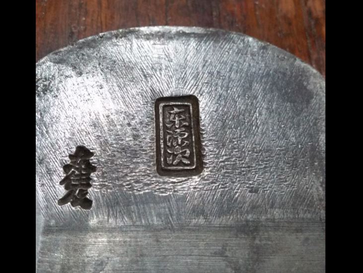

Blade #7- 東源次 on-yomi= togenji
kun-yomi= Azuma Minamoto tsugi
.....also appears to be a name
maybe a combination of the two readings.... Azuma Genji?
I can`t really work out the kanji on the left side of #6 and #7
I'm fairly sure the reading for '東源次' is Azuma Genji. That Niigata Factory produced planes in fairly high volumes from 1953 or so, and they were popular for a long time. They have an arrow feather filed finish.
Here's a page showing some pictures of blade production:
http://www.dogudoraku.com/catalog/produ ... s_id/60889
Blade 7.jpg (80.79 KiB) Viewed 23019 times
This picture shows the kanji on the left side more clearly (setting up a 'hit out of the park' for Daruma...):
