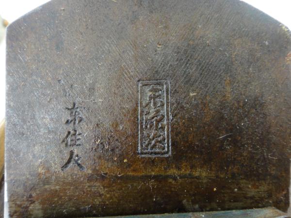

Below are photos of blades. Hope you can identify some or all. I was able to get the name Dogu from blade 5.

Blade #7- 東源次 on-yomi= togenji
kun-yomi= Azuma Minamoto tsugi
.....also appears to be a name
maybe a combination of the two readings.... Azuma Genji?
I can`t really work out the kanji on the left side of #6 and #7

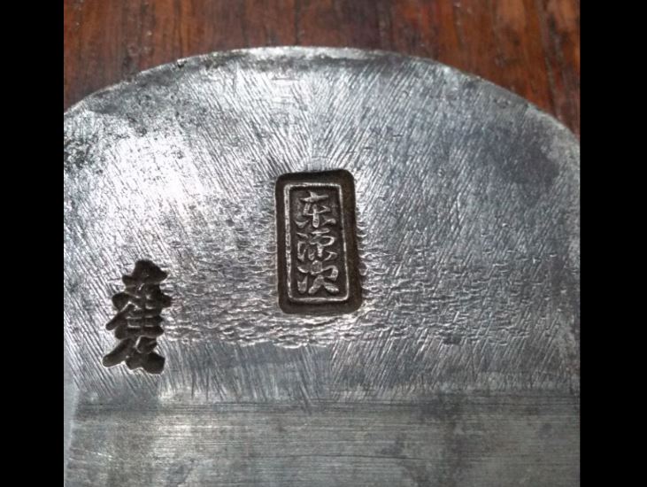

I'm fairly sure the reading for '東源次' is Azuma Genji. That Niigata Factory produced planes in fairly high volumes from 1953 or so, and they were popular for a long time. They have an arrow feather filed finish.
Here's a page showing some pictures of blade production:
http://www.dogudoraku.com/catalog/produ ... s_id/60889
Blade 7.jpg (80.79 KiB) Viewed 23106 times
This picture shows the kanji on the left side more clearly (setting up a 'hit out of the park' for Daruma...):
