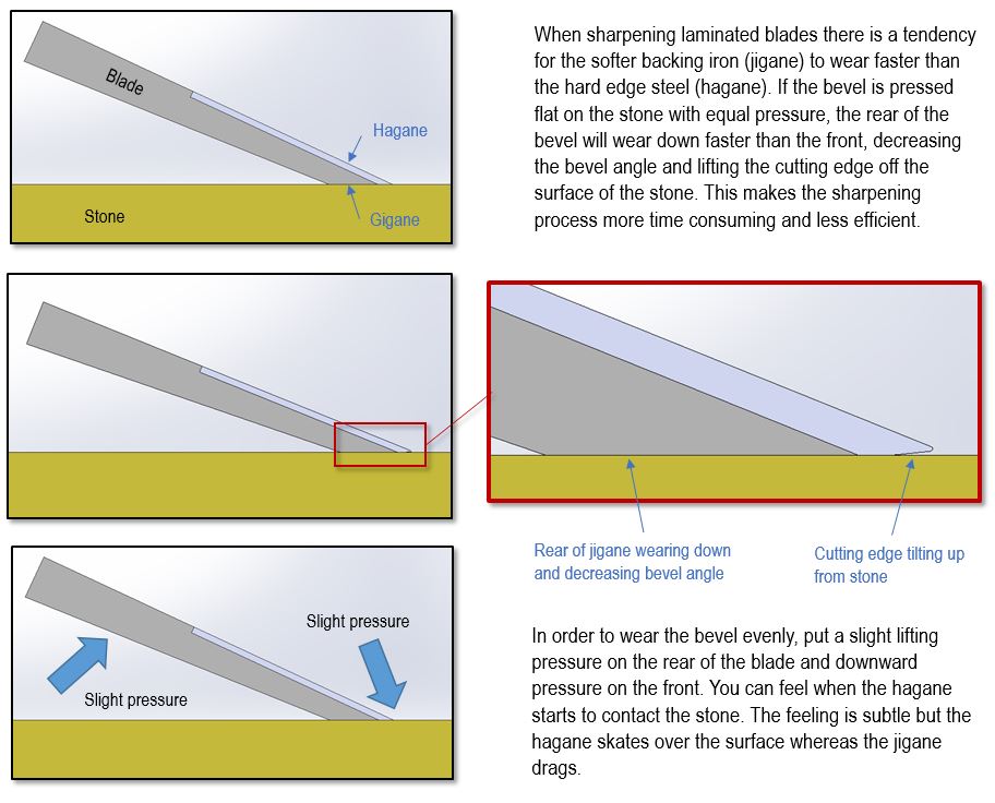

While this subject is active I'd like to comment on a sharpening problem which may be obvious to some but was a problem for me for a long time. When sharpening by hand it's often difficult to get the bevel to extend right up to the cutting edge. There is a stubborn little secondary bevel which doesn't want to get ground out. One day I realized it was because of the difference in hardness between the soft iron and hard steel. I've made an image to illustrate.
Hope it helps someone.

Yes, as the drawing indicates, a common side effect of that issue - the jigane giving ground faster than the hagane - is that the bevel angle of the chisel will progressively grow more acute with every sharpening. So, even if you do manage to flatten out to the tip of the bevel, the acute bevel will tend not to last so long in all but the softest woods.
And it must be said that the difference in feel of hard steel to soft iron is something that comes through your fingers - - far better than when sharpening with any sort of jig.
