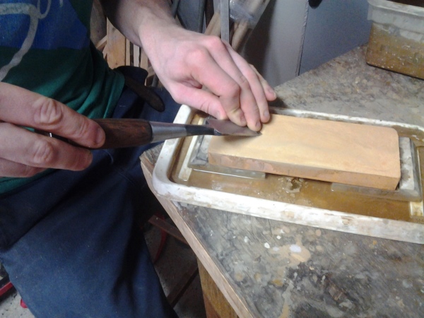

First, Odate's technique. I used that for a year with no success. I feel that the hand holding the handle is a source of instability.

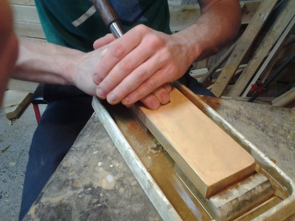

This one with both hands on the same side feels a bit more natural to me, and my fingers don't slip down the chisel.

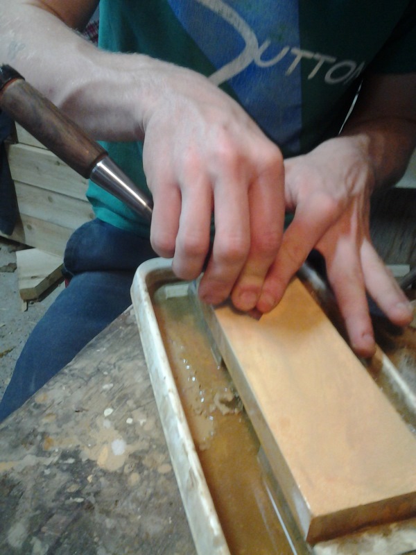

A friend of mine who learned from a daiku-san told me to do it with my hands around the chisel, and with the chisel almost straight.

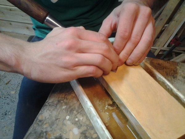

The last one is just how I usually end up sharpening when I'm just confused and tired!
That technique would only be suitable to working long chisels, like slicks, however you are correct that the separation of the hands tends to promote instability. For long handled tools, like slicks, I prefer to remove the handle before sharpening anyhow, which takes away any need to support the end of the handle.
AntoineLaMothe wrote:This one with both hands on the same side feels a bit more natural to me, and my fingers don't slip down the chisel.
This is similar to the technique I use.
AntoineLaMothe wrote:A friend of mine who learned from a daiku-san told me to do it with my hands around the chisel, and with the chisel almost straight.
This is a poor technique in my view unless one is quite careful. It is not good to draw the chisel backwards against the bevel as it can tear the wire edge away, leaving a jagged edge. Your hands obscure the tip of the blade, so your view of the action is compromised.
AntoineLaMothe wrote:The last one is just how I usually end up sharpening when I'm just confused and tired!
Best to take a rest instead!
