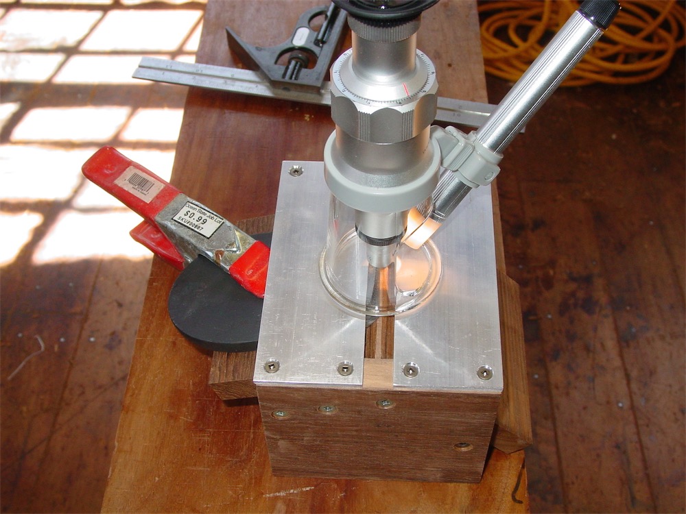

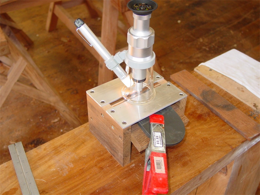

if you want to examine plane blades, you will need to build a small stand to mount the blade, and which will allow the microscope to travel on top, as close as possible to the viewing surface, without deforming the stand. I made one from wood and aluminum.

Thanks Chris, if you don't mind my asking, did you setup the jig so that the microscope rides flat on the bevel or so that the bevel is angled away from the blade?
Can you also view the back of the blade under the scope with this jig?
I feel that I don't always fully remove the wear bevel on whrn refreshing on a finish stone, Do you find this setup useful for ensuring the wear bevel is fully removed?

I have a microscope stand which holds the blade slightly angled away from the lens. I'm not entirely convinced it is the right way to do it, but it was the design Kunimoto-san shared with me.

Chris could you share a picture of your stand? I have been considering different setups and yours might inspire me to build something decent.

I have couple of pictures of the stand I made which should give you the general idea:
There's a platform at each side, one for holding the blade so as to examine the bevel, and one for looking at the ura.

Thank you for posting those pictures that is helpful.
