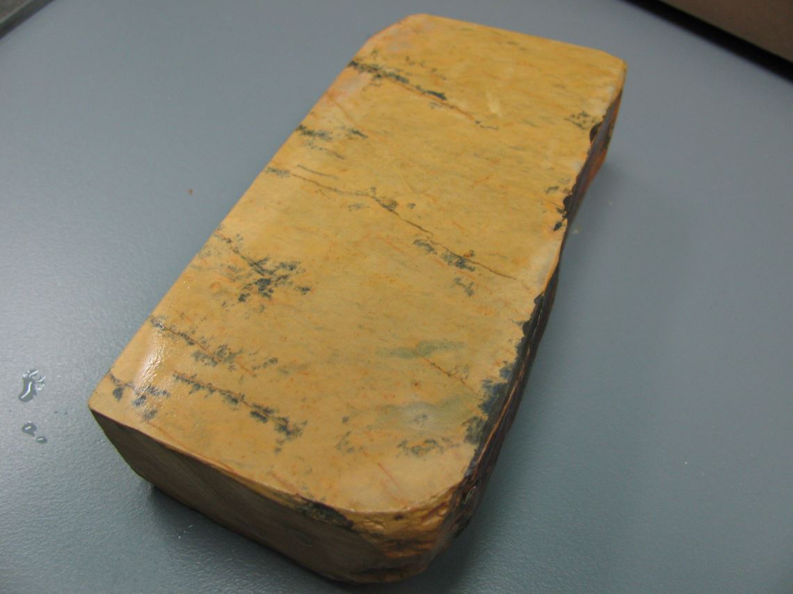

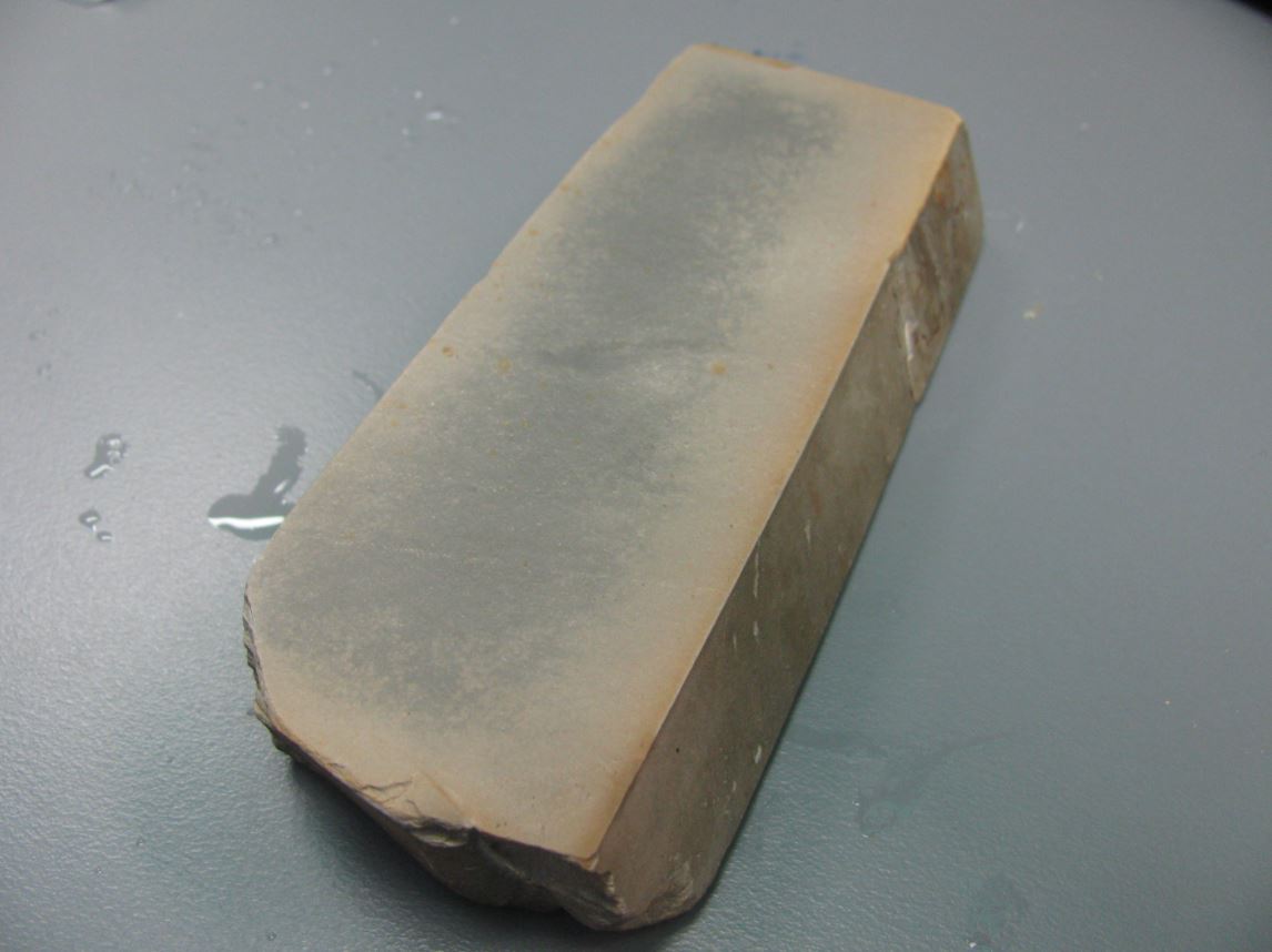

The PDF wasn't accepted so I'll post a couple of photos.
The yellow stone is mudstone and cuts fast with medium finish.
yellow finisher.JPG (83.33 KiB) Viewed 19308 times
The slate stone is very fine but doesn't cut as past as the yellow.
Slate finisher.JPG (77.33 KiB) Viewed 19308 times
