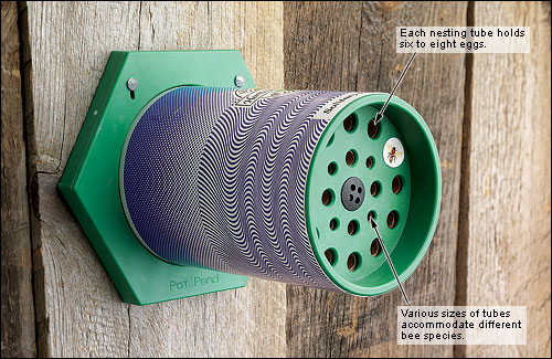

How about providing a home nearby for them that would require less effort for the bees, or some sacrificial wood that they might prefer?
Around our house, we've been using these solitary nests from Lee Valley (http://www.leevalley.com/US/garden/page ... at=2,47236):
They work well.

Thanks Chris, I will look into that solution. Part of the problem is that I left the bees alone in a redwood wisteria arbor for several years, and now they are established.
