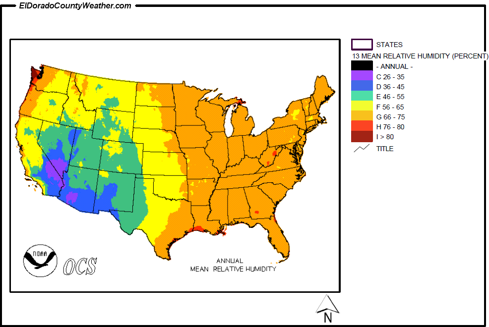

Here's a map of the US showing averages for RH - as you can see, no part of the US is as low as 20%, though Southern Nevada-Death Valley area comes closest:
I guess Las Vegas is the driest urban location in the US, with annual RH of 30.3%, which matches a wood with equilibrium moisture content of about 6%. That's very dry wood.

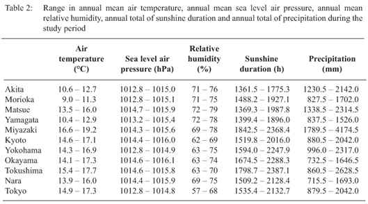

And here's a table for some Japanese centers, as you can see, nowhere is lower than 57% RH (Tokyo), which correlates to a equilibrium moisture content for wood of 10.6% or so, and most areas RH are significantly higher:
