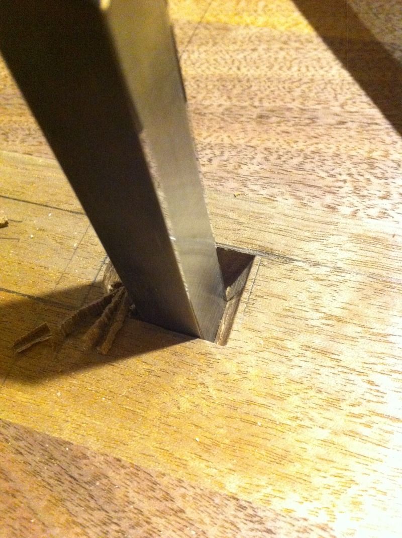

Layout and initial drilling of the holes for the mortises, these pass through the bottom panel and the crossmembers. I cut this hole and the other three with a brace and bit. I did so because it's very easy to maintain perpendicular when doing so, and so the exit is clean and on the money;
I chop wasting into the hole;
The shear toward the line

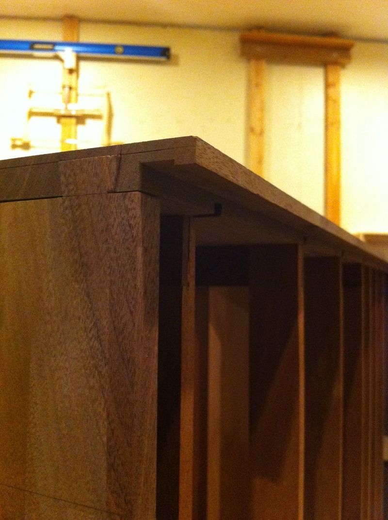

Took a moment from banging my hammer to finish rabbeting the inner panels and cutting their receiver grooves in the web framing;
Then I returned to finish chopping my mortises, test fitting, trimming, final fitting and then installation. I was in the groove all day and did not take much in the way of photos until most of it was complete.
The cabinet is quite stiff now, the inner panels, base and crossmembers have added a lot of integrity to the structure.
