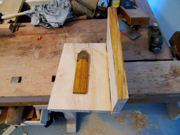

I know the subject of saws and sawing has very many facets, but on the subject of using a Japanese rips saw I was initially skeptical when I saw it being used against the grain. Usually with my Western ripsaws I am going with the grain. I found using a Japanese saw against the grain difficult and clumsy at first. With practice and much repetition I was happy to find them very smooth and quick. The boards in the pictures I showed still represent quite a workout, but it went relatively quickly - 1hr ish.

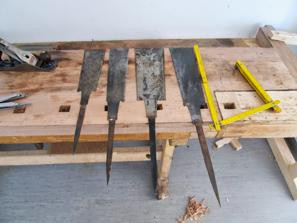

Hi
I've bought several cheap old ryobas from ebay and I sharpen them myself. I can even re-saw rosewood with them. They dull, but I sharpen them as fast as they dull so there is no problem.
The small one on the picture is the best for tropical woods. Has small "chubby" teeth and a slight negative rake. The large wide one is a pleasure to use on big pieces of wood. Skinny long teeth will break easily, so keep them for soft wood.
You just need to "touch up" as Paul says, it's incredible the difference that it makes. For rip teeth you don't even need a vice, I do the filing with the saw standing on my workbench.
Here is some really hard ash I was cutting.
Zoom of the teeth. Both work perfectly fine in hard wood.
